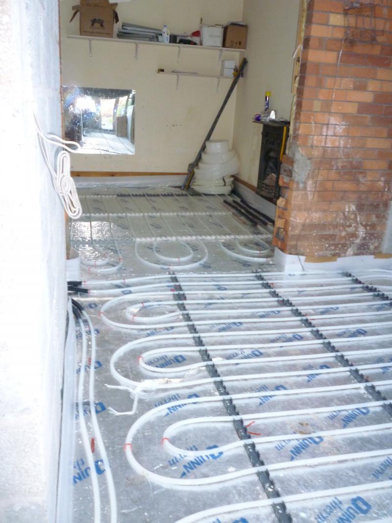

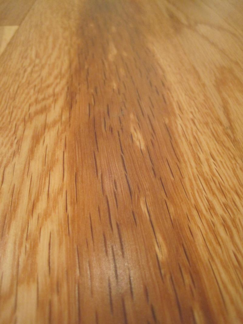

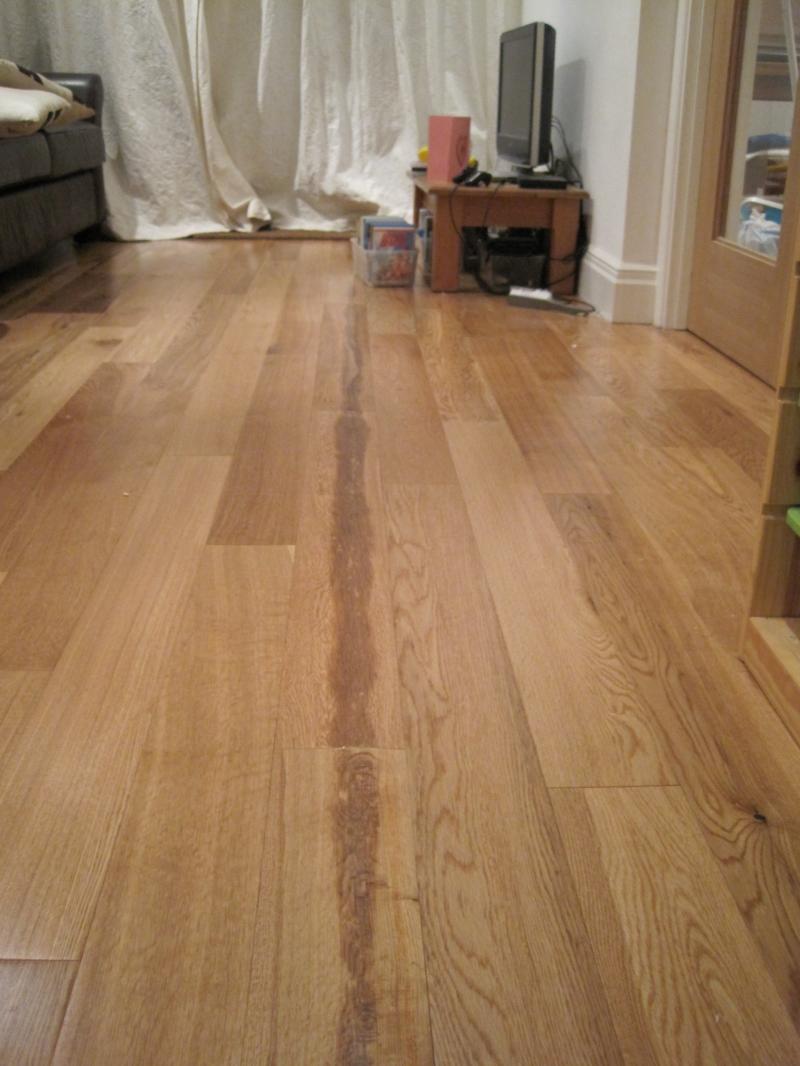

I've got a problem with some of my Engineered flooring planks swelling and turning dark brown. It looks like it's affecting planks that run lengthways above the plastic clip strips for my underfloor heating pipes.
I've added some pics in of the problem.
As part of a new extension and house refurb, I had a new concrete sub floor laid in September last year. I had underfloor heating installed on top of rigid insulation boards and then a floor screed poured at the end of October. The underfloor heating was then switched on at a low heat to dry the screed.
The engineered wood floor was laid on about the 8th of December. It is a click system that 'floats' on top of a very thin layer of white foam material, which I was informed was to stop the floor being noisey when walked on.
The affected boards stated to show swelling after we moved in mid January. They are now going dark brown as seen in the pictures. The area of discoluration is also pretty warm to the touch.
I've also included a pic of the underfloor heating installation. The plastic strip in the foreground is the one below the darkened area in the other pictures.

Rather looks to me like your UF heating has developed a leak. This has come to the surface of the screed and is affecting your floor.

Just for info, the same thing is happening in the kitchen adjacent to this room where the plastic strips lie beneath the boards longways. Although not as bad. There is always about 4 to 5 good boards between the affected ones.
The other 2 rooms and hall where the plastic strips go across the boards rather than longways are fine.
It's also worth pointing out that the concrete screed dried out ok with no sign of wetness before the floor was laid. The UFH was on continually during this time.
I'm not saying that isn't leaking, just trying to get my head around how it would leak in this pattern.

As John says it certainly looks as if this is being caused by a leak - possibly where the screed is thinnest along the line of the pipe clipping.
It won't improve and if it is a click system I would get it up asap to avoid any further damage to the floor. Presumably you or the installers (of the heating system) are insured for such as this?

The affected boards are crowned, ie a bump in the middle of the board.

As said, it is just the 2 new extension rooms that have the affected boards and these rooms are the only ones that have the UFH mounting strips running the same direction as the planks.
Just thinking though, there are a couple of areas that are affected also that don't match up to the UFH mouting strips. These would be about 2 consecutive boards long. I have a heap of photos and have been matching things up.

I pushed the prongs of the damp meter into the surface of the affected wood and it is giving me a high reading right on the discoloured wood. The adjacent wood is giving no reading at all.
Looks like it is due to moisture then and maybe heat as well as you say.

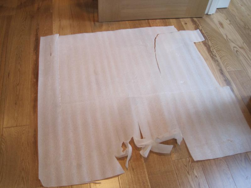

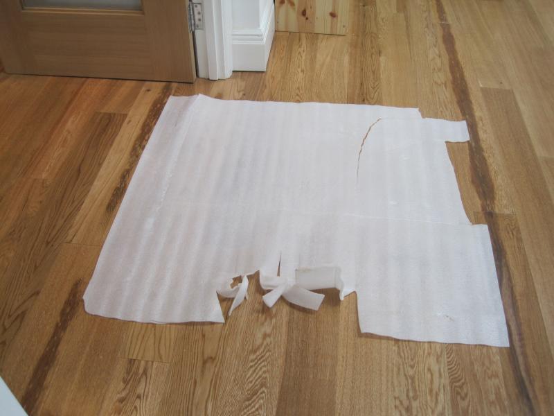

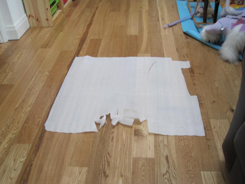

I have a scrap piece of the white underlay and it looks to be about 104 cm wide. If that is the correct width, the underlay fits very well between the areas of affected flooring. I've added some new pics of this!

It doesn't has to be a leak per see. It could also be condensation above the strips of the UFH system. If these strips are not fully level with the rest it could create an "air-gap" and cause condensation = moisture problems.

looking at the fact that the underlay is about the same width as where the lines are i will go back to my theroy that the vapiour barrier underlay was not tapped at the joins and there is also to much moister in the concrete/screed (not dry)
however that underlay does not have a built in vapiour barrier. So did the installer lay plastic sheet down before the underlay ?

You say you stuck a damp meter into the wood? What was the reading in numbers? (Rh reading of concrete is different to wood reading, it should be around the 10-12ish number on the meter) Also what make of meter are you using? It is a wood moister meter i take it?
