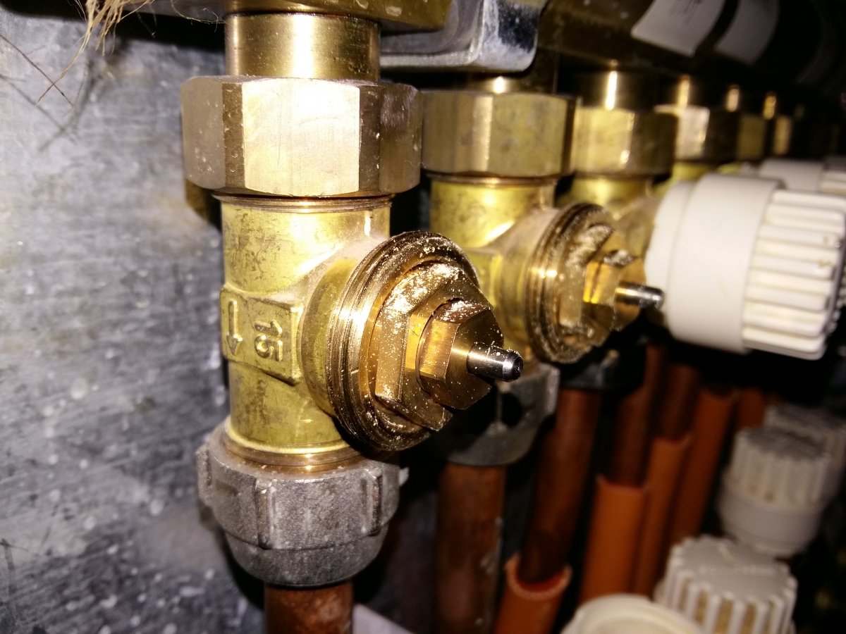

What I hope somebody could advise me on is whether this system can be retrofitted so that a central programmable control panel can set temperatures and heating time durations wirelessly ?

The reason we/I want to see pictures, as with any other professional giving advice here is to make sense of the largely meaningless fluff many posters put in their requests for help.
In your case, I can see you have a heat meter and no actuators.

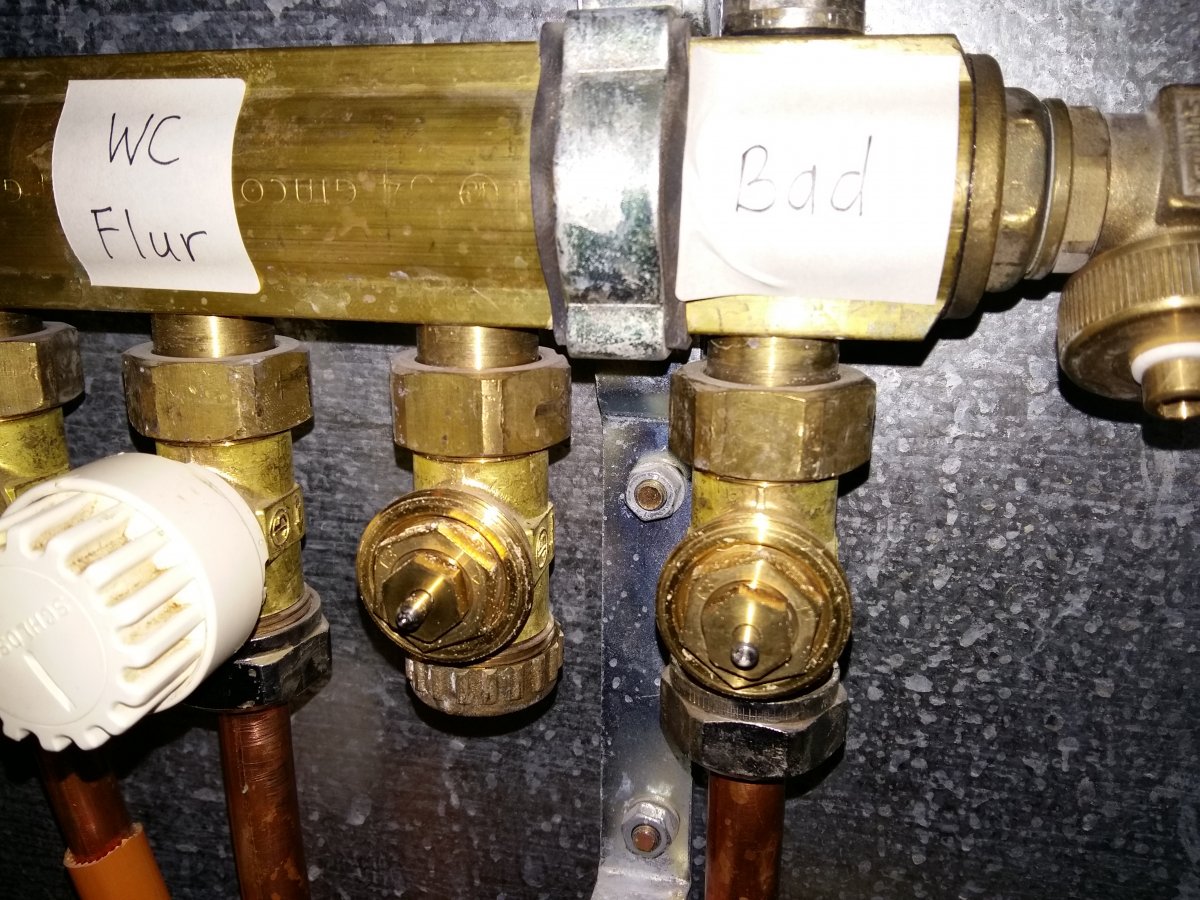

Putting actuators on the manifold pictures (would be nice of a close up of the valves along the top rail) would make it easily controlled with Evohome which will do exactly what you want.
The fun part is finding actuators to fit on the manifold.
10/10 for observation ! yes you are correct the property is not in the UK.
i had a quick look at Honeywell evohome, that looks to be exactly what i need, if no suitable actuators are available is it not unreasonable to swap the manifold out for one which supports a suitable actuator ? From the valve "piston" i have about 2.5 inches of available space to the fascia panel. I presume that the actuators require their own 220v supply, there does not appear to be a supply in this cabinet but a wall socket is very close by. Am i correct in thinking that the room sensors and control panel are battery operated ?

65mm is a little close...and from the bath, 8 can't measure mine. However, from the pictures I don't think there will be an issue.
Worse case scenario would be the news to use Hr92 heads on each loop and that will definitely need for the space to be made bigger.

what perhaps you cannot appreciate is that the cabinet housing the controls is set in a precast concrete wall so whatever there is available has to fit in that space envelope.
the valve threads are 30x1.5 the spec of the HR92 states also 30x1.5, you wrote that HR92 are a mixture of mains and battery but the datasheet of an HR92 states

HR92 is 96mm high, that might pass but it would be very close, are there lower profile alternatives ? perhaps the valves could be rotated 45° to gain a few mm.
the main room to be controlled is 15M x 5M and has three heating zones. If i want to maintain 22° in this room i will need one single zone sensor and 3 actuators HR92 if they fit, is that it ?

I meant it was a combination of actuator and sensor - however you can bind multiple heads to z single zone with a remote sensor.
If they don't fit in the housing, then you could use standard actuators and an HCC80. This would need mains power.
