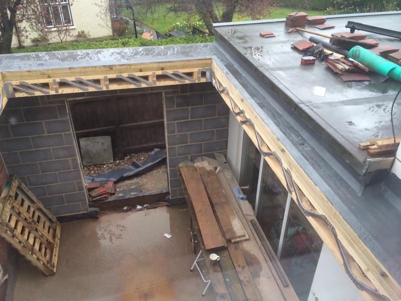

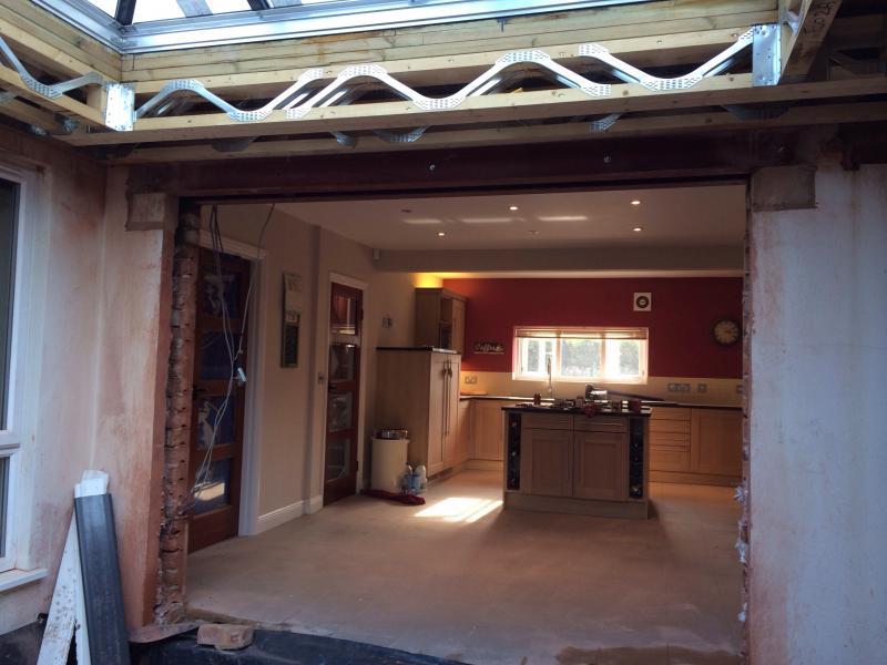

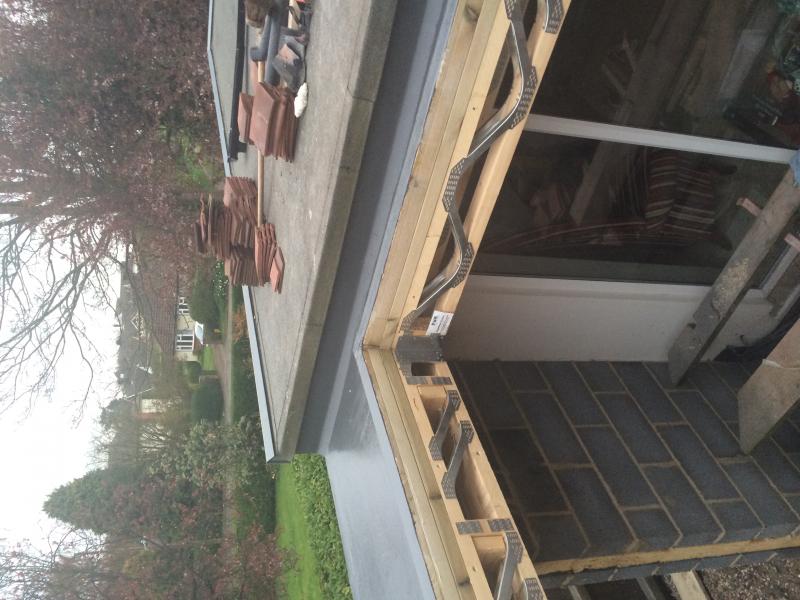

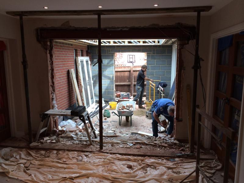

More pics...
It must be 25 years since I worked on a job where the guys were not wearing PPE. I hope you've got wee Dom's mobby number handy???
I ain't no structural engineer, but are these joists big enough to take the new roof?? Should there not be some steels in there?? Just a thought.
Nope they are posi joists and are more than adiquite for the task at hand.
Their is a steel lintel above the opening and all calcs have been done by a structural engineer so I'm ok on that front
