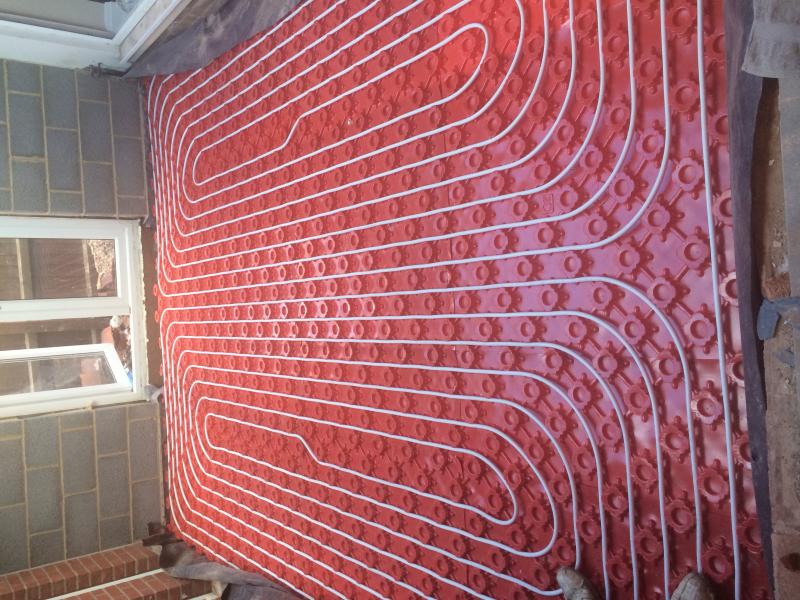

Underfloor heating in my orangery...
It's fairly simple, the more pipe in the floor the lower the mean water temperature. Providing you can achieve the watt/M2 required.
However, in the commercial world of contracting, where time & pipe is money, an accurate design is always done.
100mm pipe centres is not uncommon, however, with most types of PEX pipe you need to 'spoon' the bends.
You should have told us it was to be on the wall!
