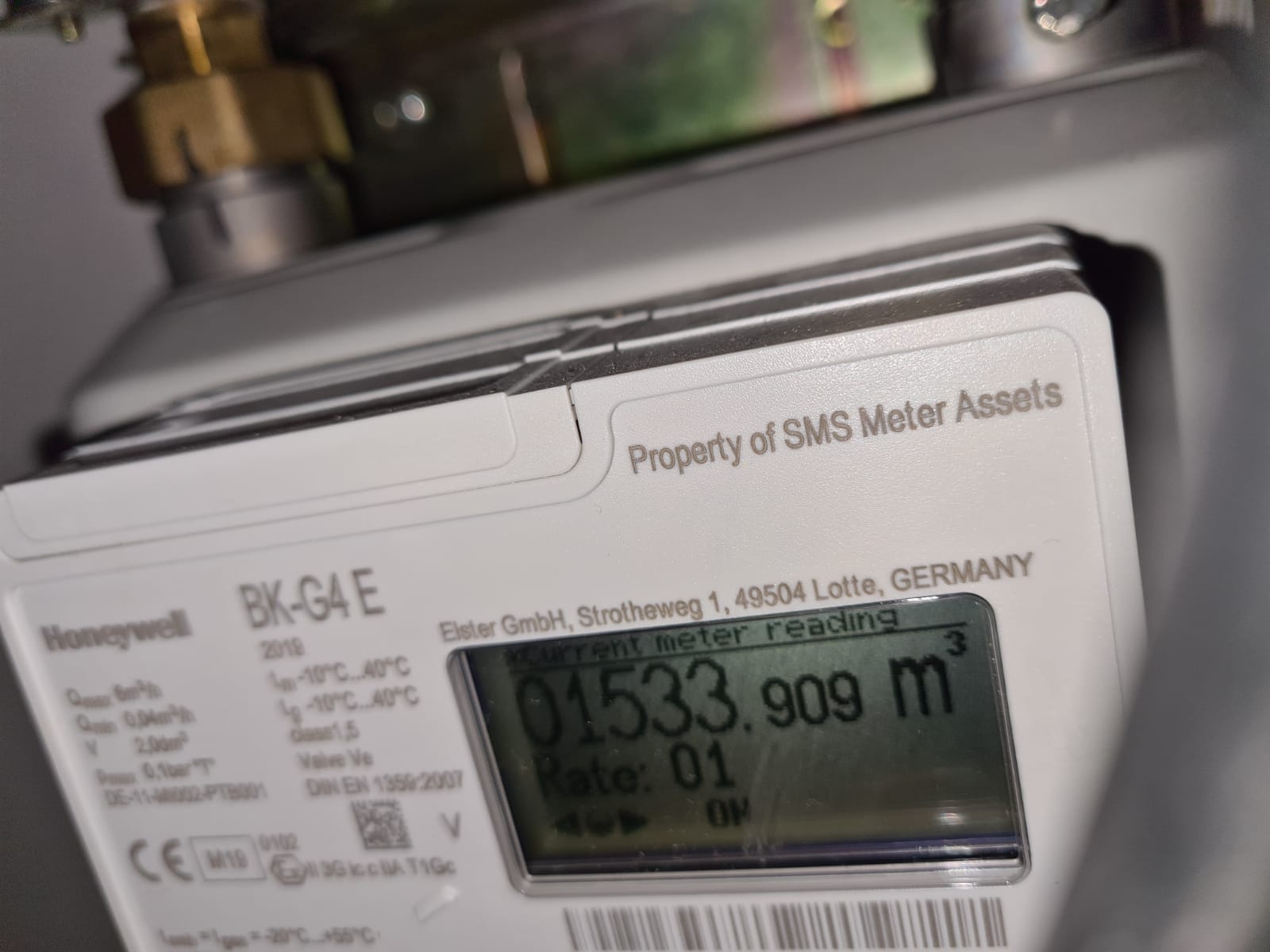

I would read the litres gas usage from the display and just confirm your bills are correct. If you haven't the meter manual post a pic of the meter and we'll dig out the details to put it in litres mode.

Below is my gas meter

Luckily for you that's one of the easier smart meters...just wake it up and it displays the gas reading.

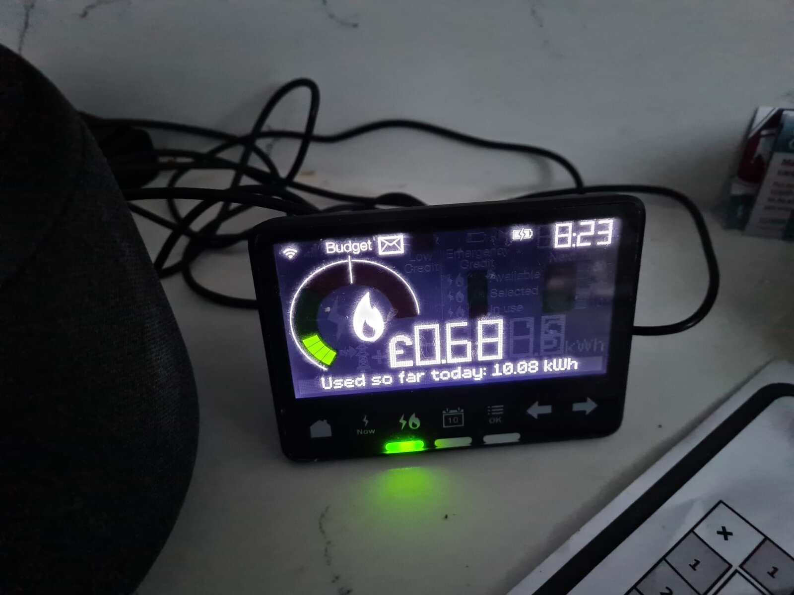

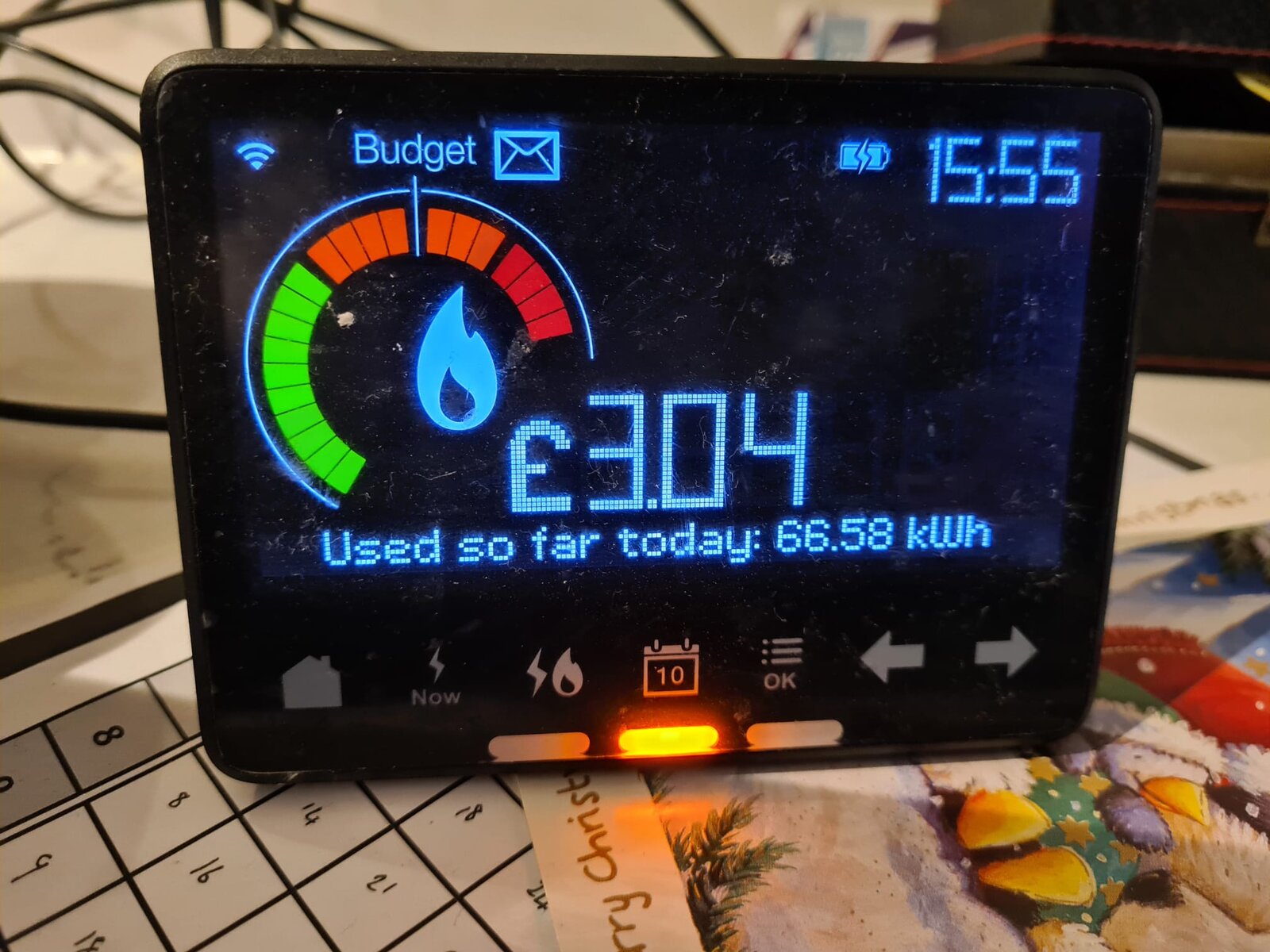

Blender changed to 50c today, still about 50kw of gas used in 2hrs.
The desired room temp is 21c, what temp should i set the stat ?
Any suggestion as to the schedule, I will need pointers here please. For example 7am - 7pm set it to run at 19c, and then by 7pm, backset to 15c ?
50kw of gas in two hours?
I am not joking, see for yourself.
Morning and just now.
Just now
The reason why i came on here was not to moan about having a ferrari of a heating system, its an uncommon setup and sadly there is no other household locally that i can compare with, hence the reason for asking if this is as expected. If it is then fine, if its not it sets the scene for the conversation with the engineer that i will call in.
Thats 7.5 hrs?
Not the same.
Not mad either.
Its winter. Its cold. You've a big house.

Thats 7.5 hrs?
Not the same.
Not mad either.
:eek: You just opened my eyes here, that's 7.5hrs difference and lets say 55KW used. So does that mean that even though the boiler was on for 2hrs, it was consuming gas at the rate of approx 7.5kw/hr ? Please help me understand it.
