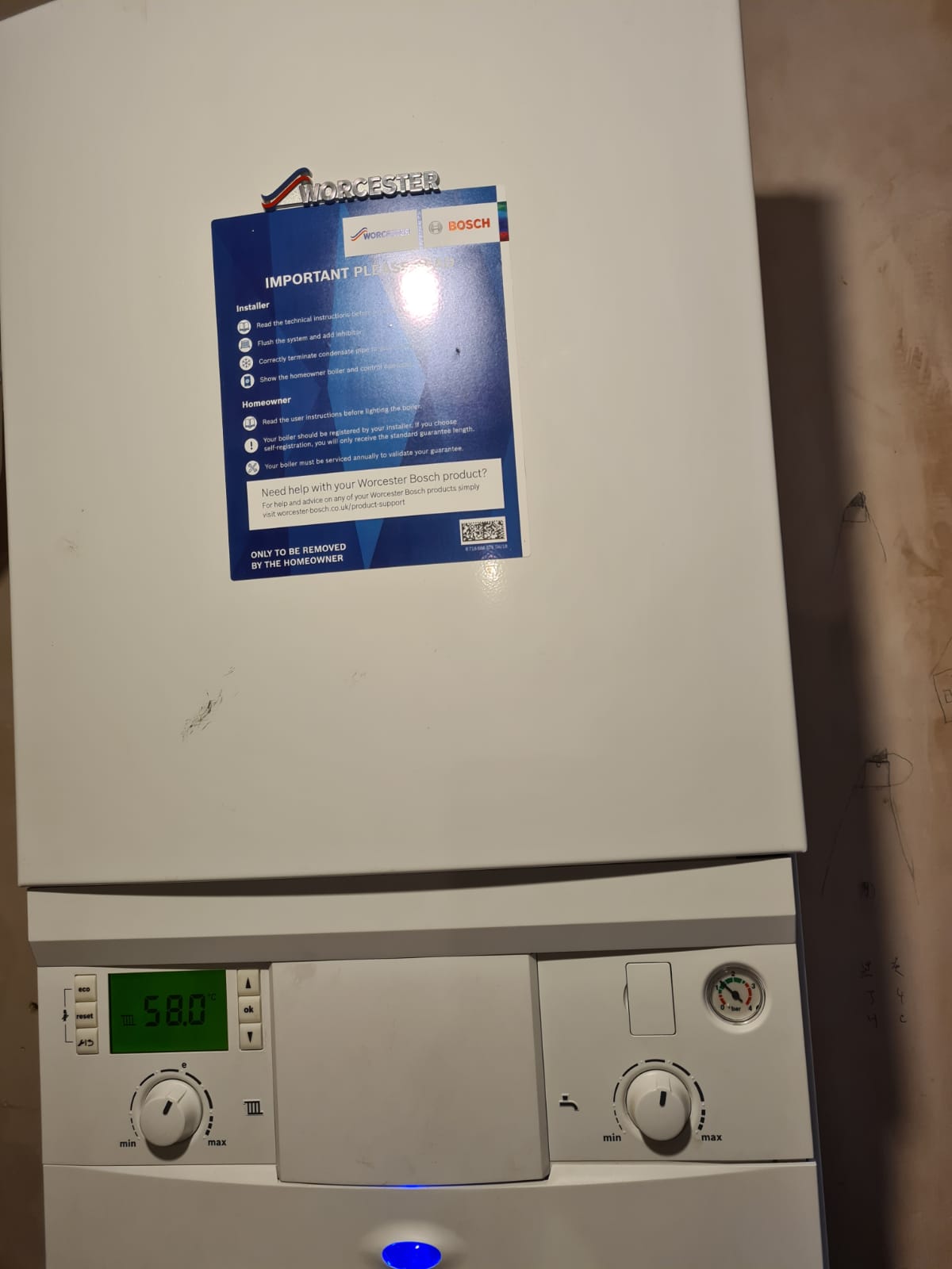

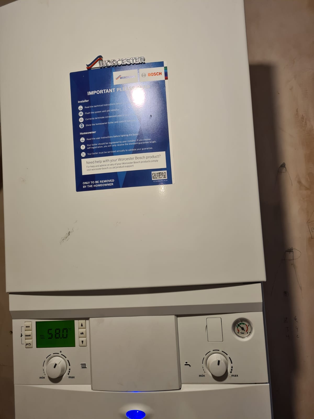

When the stats are satisfied then the boiler stops, I read somewhere that the UFH can cycle water down even when the boiler is not heating. Could have misunderstood this.
I set the boiler temp to eco, used to be on max before up till about a week ago. Boiler temp hovering around 55- 60 as we speak, right now I took the advice on the forum and have a longer running period 6.30am - 7pm @ 19 and after that @ 15 deg
Blending valve set to 48, just around 50deg.
Regarding your question around cycling a lot, I wouldn't know how to answer that as I don't know how to work out when its cycling or modulating, i generally don't have the boiler running for short periods.
As we speak, the system is only heating on zone, flow temp just under 50 deg, return temp around 38deg.
Regarding the flow valves, ironically when the system was last drained, filthy water didn't come out, i just don't understand why its stuck around the flow valves, part of the heating engineers job will be to sort that out and balance the system, i am here to educate myself as much as possible and inform him of all the weird things I have noticed, he would only be here for a few hours but I have observed the system for a lot longer, hence why I want to summarise it for him correctly.
Thanks in advance.
You should find there is a separate circulating pump for the UFH manifold, and another for the boiler (likely internal to the boiler unless it's "heat only". You should also find there is a separate controller for the UFH, and it gets the "GO!" signal from the timer/programmer, via the zone valve (which also fires the boiler). At the same time, the UFH controller then starts the UFH circ pump and opens the applicable loop actuators. On the closing down sequence, the UFH controller should allow the pump to over run, though it's not imperative as it's their for boiler protection. The UFH loops would be left with warm water once the zone valve is closed anyway.
You have more rooms heated now than before, so that'll largely account for the increase you are seeing.
To help your diagnosis, remember to turn off the DHW or other heating loops so your results are excluding other variables.
Cycling is when it turns on and off whilst the rad symbol is still lit. There will normally be an anti cycling delay of a few minutes.

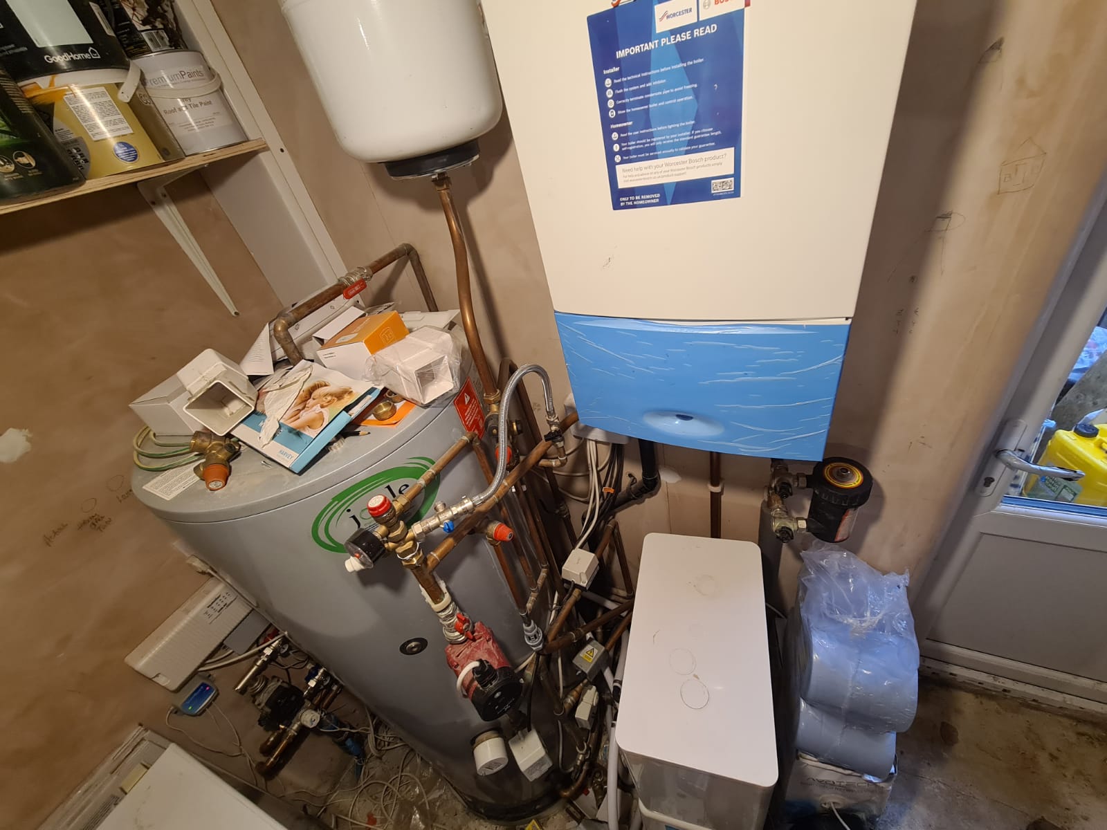

Please see the picture below, I can see 2 pumps. One for the UFH which is black in colour and another which is red. The one for the UFH is fairly obvious what its for, the red one comes on all the time, but i think thats for heating and hotwater. not sure.

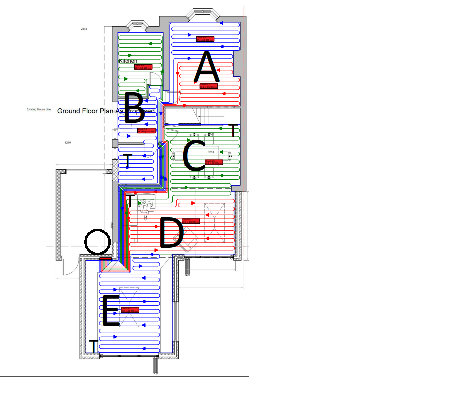

Do you know the loop lengths and has the flow been set correctly for them? This is where i am suspicious, if you notice in my previous posts, I have always talked about balancing the system. I tried to do this when a friend helped me to drain the system earlier this year, but the instructions I found on youtube on balancing the system using the flow valves didn't work for me, so i just left it for fear of not damaging anything on the system.
Do you have bifolds and large windows without curtains? yes I do :confused:, please see floor plan below, there are 2 areas the first is zone E, you will notice a 3m wide bifold door, this area is prone to high heat loss. to put it into perspective, it takes almost an hour to heat up to 0.2 degrees upwards however in the summer being south facing, it gets really hot. So what I have done is lowered the stat setting for that zone, this way 18 deg is fine. The second place is zone B, you have a door there with a glass pane just over 2m wide. Prone to heat loss also, so i decided to heat such areas as much lower temps.

Jeez...what an absolute mess :eek:
Why the extra pump, gauge, safety valve...it's a system boiler with those parts integral.
Probably needs an additional expansion vessel.
It wouldn't surprise me if the builder did much of that work, lots of non compliance.
How does anyone get to the manifold for repairs/setting up?
Tear it out and start again for me.

The dirty sight glasses (and flow indicators) for the UFH can be cleaned quite easily once removed; it's the lack of access that will be the biggest headache. Once done though, flow balancing can be easily achieved by following the designer's recommendations. In their absence I suggest the following method:
1. Set the pump to its minimum speed (RTFI for how to do this), with all UFH zones calling for heat.
2. Remove every electric actuator from the manifold; make a note of which goes where, because the rest of this may take several hours to achieve.
3. Open the flow restrictor in each loop to maximum, and observe the flow rates. Restrict flow in the high flow zones to get a reasonable flow in every zone. If this can't be achieved turn the pump speed up one setting (from speed 1 to speed 2).
4. Leave the system for several hours to warm up.
5. Measure the temperatures of the pipework flowing into, and out of each zone. There should be a marked decrease in the return temperatures, but of highest importance is that each zone's return temperature should be the same within a few degrees.
6. Reduce the flow to those with higher return temperatures, again leaving several hours for stabilisation between iterations of this step.
At the end you should have one zone with its restrictor almost fully open, the pump speed at the minimum needed to circulate, and all return temperatures equal....and all rooms warmer than you would like (to pay for).
7. Replace all zone actuators, and set the room thermostats to your desired values.
