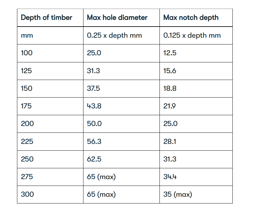

Unless its really old fat/thick 16" pitch pine joists then nope - do not notch for a 40mm pipe. Anything above a 200mm joist though can be drilled though and get the waste through the centre of the joist.
The joist needs to be at least 400mm to take a 50mm notch which would be the min to take a 40mm waste pipe. If you have a basin and a shower on the same run then the waste would ideally increase to 50mm at the tee or be on their own run depending on distance. Having anything else on a shower waste run only temps, when restricted, for the waste to end up in the shower tray so at least a 50mm pipe will help with that.

Definitely worth determining joist size, direction, spacing etc and checking a span chart (Google) as they could well be oversized.
Sorry but it doesn't matter whether they are oversized or not for the location application when it comes to notching. Span tables only determine what size the joist needs to be given the quality of timber used and what centres they should be set at, to span specific distances. Tables are used to ensure that the weight of the joists themselves, the floor sitting on it, the ceiling below it etc (dead load) will be properly supported over specific distances, not whether they may be way oversized and can then support larger notches.
The only determination for the depth (D) of a notch is 1/8th of the depth of the joist or D x 0.125 regardless.
