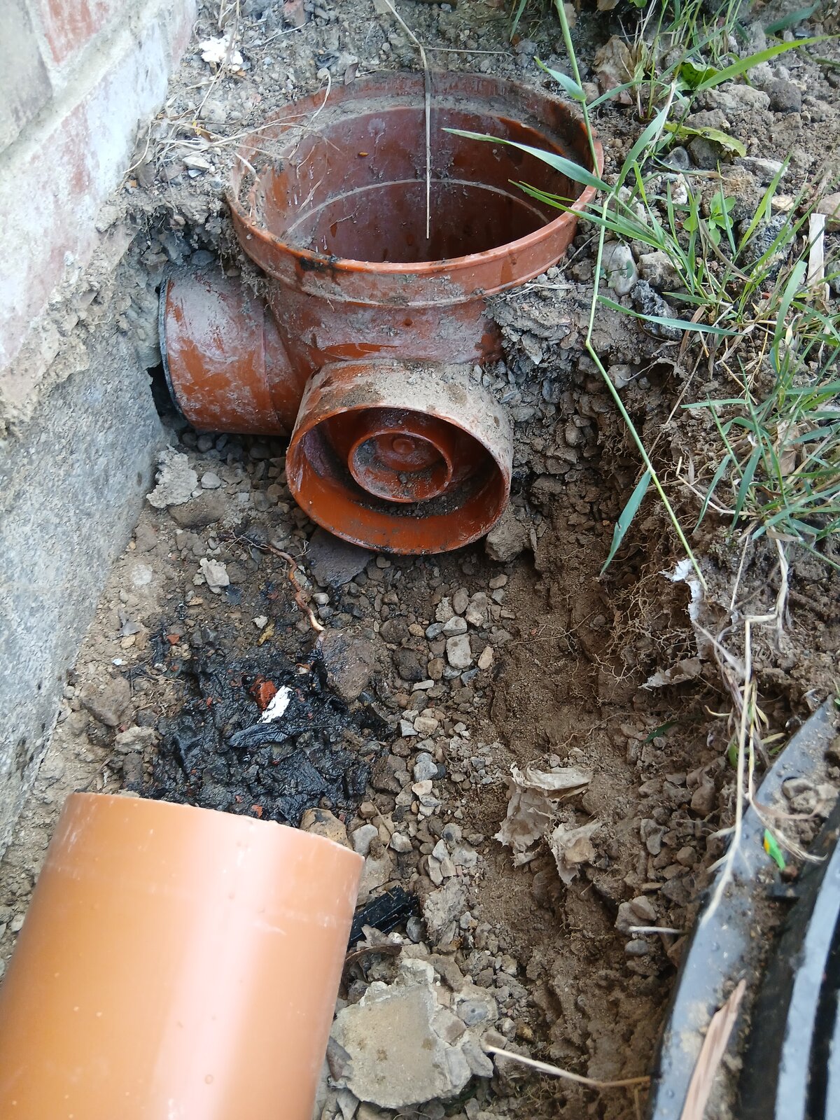

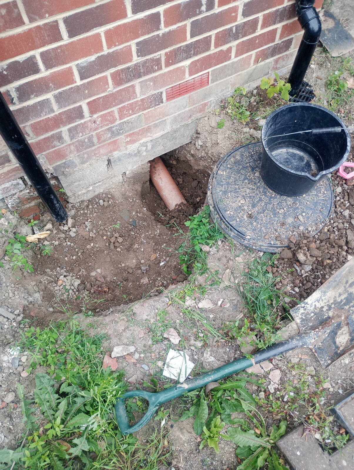

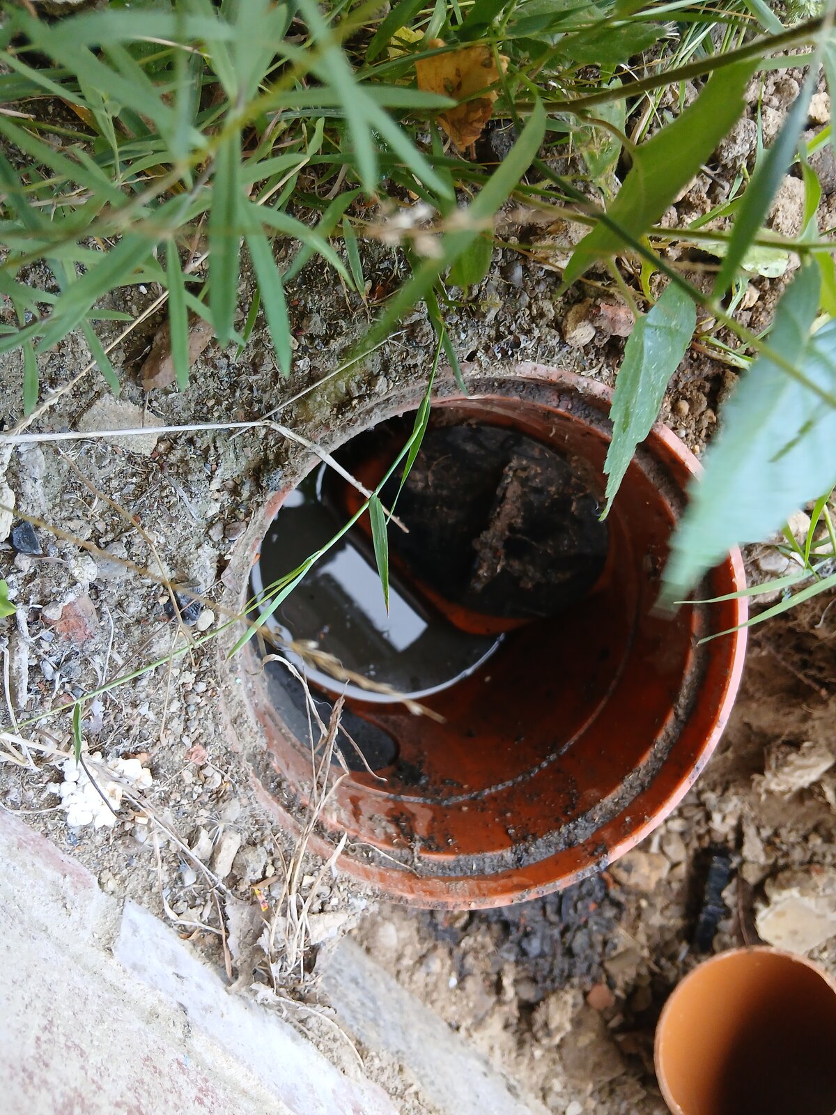

Hi , just back on with this issue as I haven't got round to it yet.
I have bought another gulley and ideally would just like to connect a piece of terracotta pipe from the outgoing socket of the new gulley to the spare outlet on the existing gulley.
However once I've dug down I can see the outlet has a smaller diameter hole so I'm not sure if it is purely for that size pipe only or can I drill a 102mm hole in that (it fits fine) and insert the pipe into that gulley?

All five inlets on the chamber are in use?
Yes, you can cut out the large Boss on the side of the gully and connect a 110mm pipe to it, it's what it's designed for. You'll need to use Solvent Weld cement to glue the new section into the Boss though to ensure a watertight joint.
Strap Boss connections are only for Waste Pipes, up to 50mm diameter, Rainwater is 68mm diameter, so needs to connect via a 110mm to 68mm reducer.

A really terrible idea.
Firstly, a gully needs 110mm pipe and if you reduce it then it will block.
Never couple a downpipe to a sewer, otherwise you've just made a new sewer vent. The top of the pipe and all its joints (not airtight for downpipes) will stink for ever.
You were/are going the right way before the crazy suggestions above. Put a gully in to trap the smells, pour the downpipe into that.
