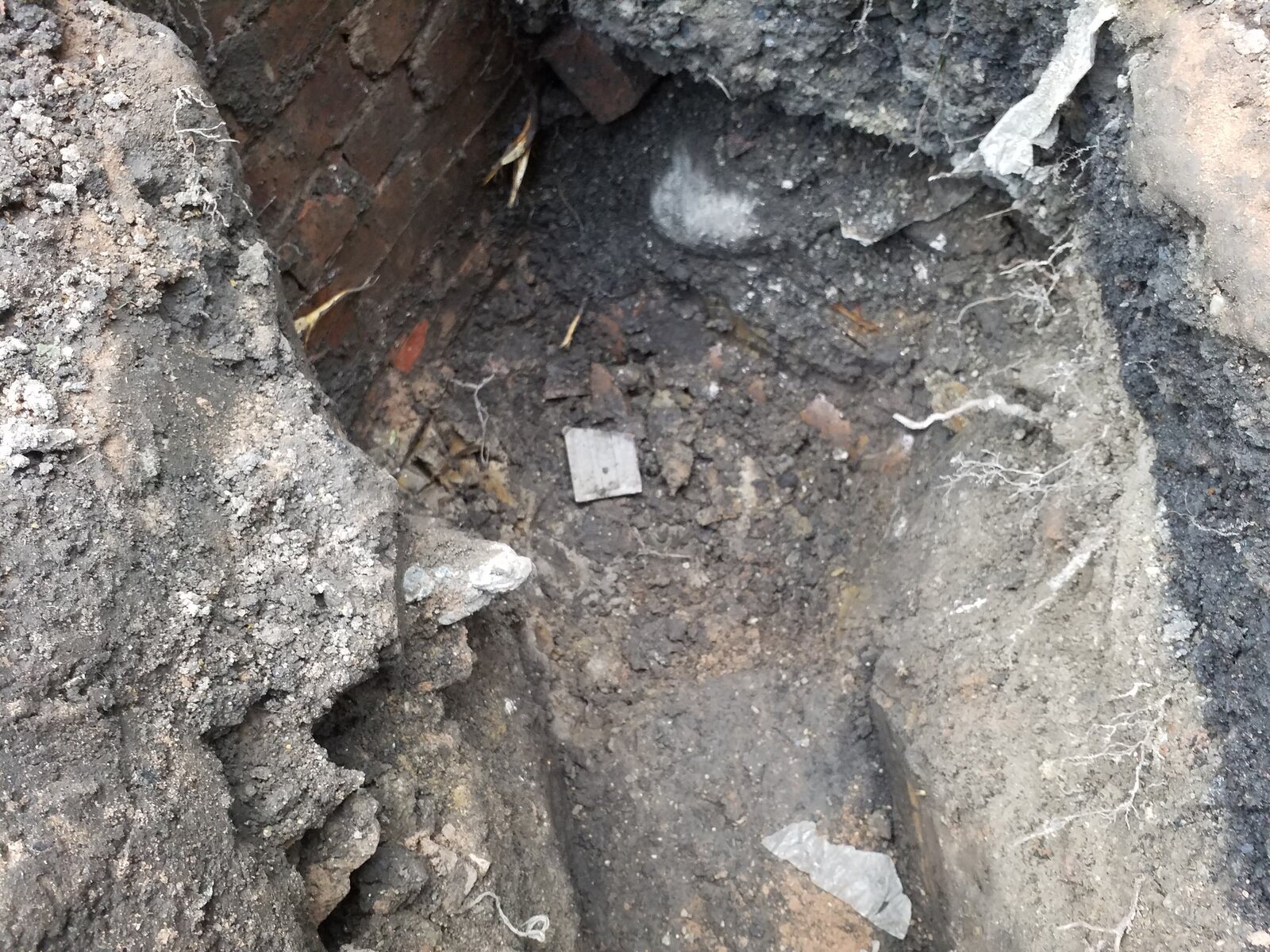

Can I tee into a gully pipe which is connected to the manhole or do I need to break in to the manhole separately? It's the old brick construction type about 4 feet deep?
Hope you can make this out, to the left is the wall of the chamber and amongst the mud is the terracotta gully pipe that you can just about see

Your call, its an equal amount of work, possibly easier to go through the brickwork?
How far away is the house gulley - does the gulley take waste water and rainwater?
Check with Building Control what they'll allow first of all, but that also depends on the existing gulley connection to the manhole. Soil connections need to be made to allow smooth flow of solids through the chamber and avoid build ups of material on benching, walls etc.
If the connection looks ok, then I'd say you have 2 options. Firstly, break into the clay pipe and fit a 450mm plastic chamber at that point, or you may be able to break in using a junction, provided you fit an access point on your stack immediately above ground level. If it's coming in too high, wrong angle or any other problem, then you may not have any option other than to break into the manhole with a new connection, suitably placed to avoid any issues.
You are aware you need a long radius bend at the foot of the stack I assume.
Thanks. The gully has rainwater and washing machine going into it at the moment and continues through the wall and benching in the manhole. I would use a swept tee of connecting into the pipe. The whole breaking in and chiselling out the benching seems a bit daunting if I'm honest. I've tried to find the answer in the regs but can find no mention of connecting to the gully waste as it tends to refer to the modern multi connection type manhole you refer to.
I'm ok with the regs and construction up to that point
