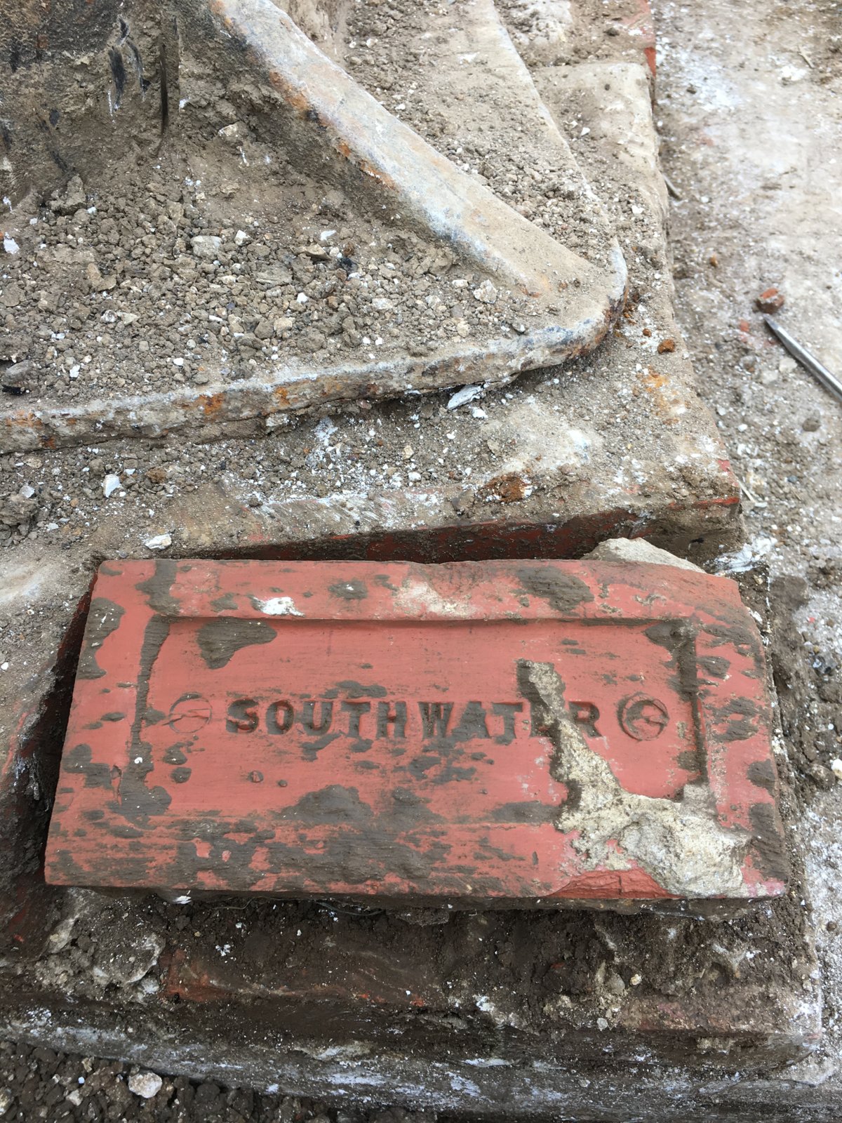

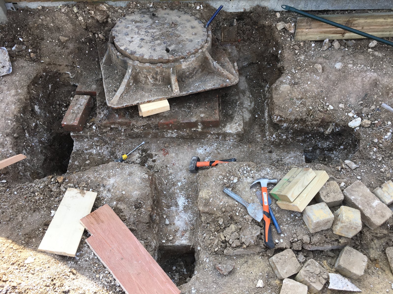

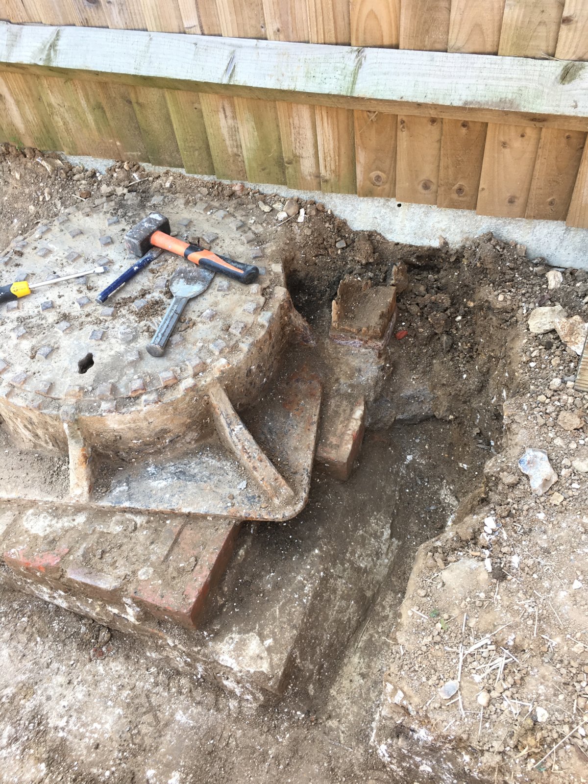

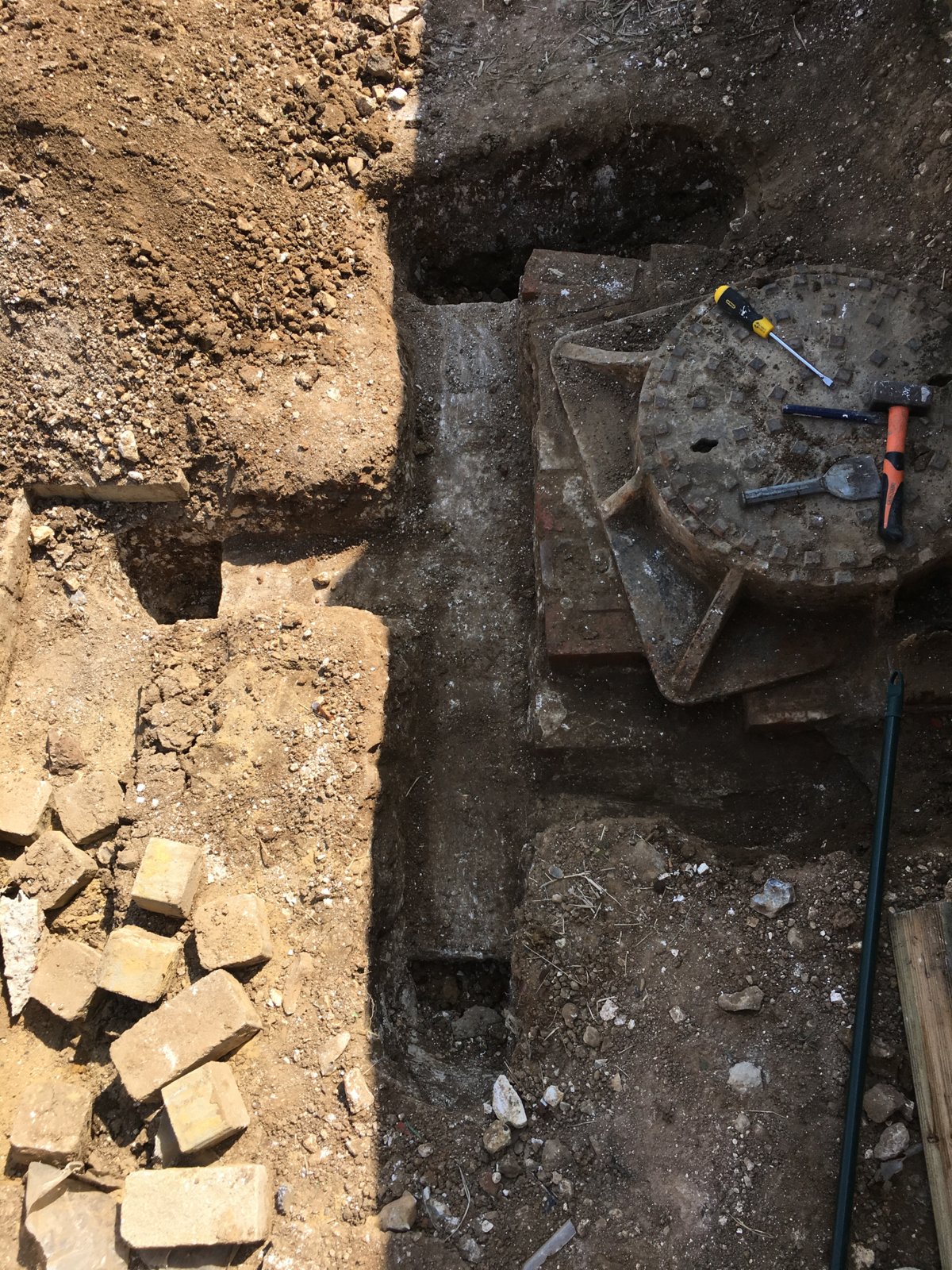

More digging... seems to be sat on a big square which might not be in the way of the pond afterall.
Also seems somebody has managed to stick a fence post through this at some point.
The lid is loose, so will see if can get it up.
The brickwork looks tidy enough and professional, just the way that cover is sat on it at an angle and the sheer weight of all that metalwork.

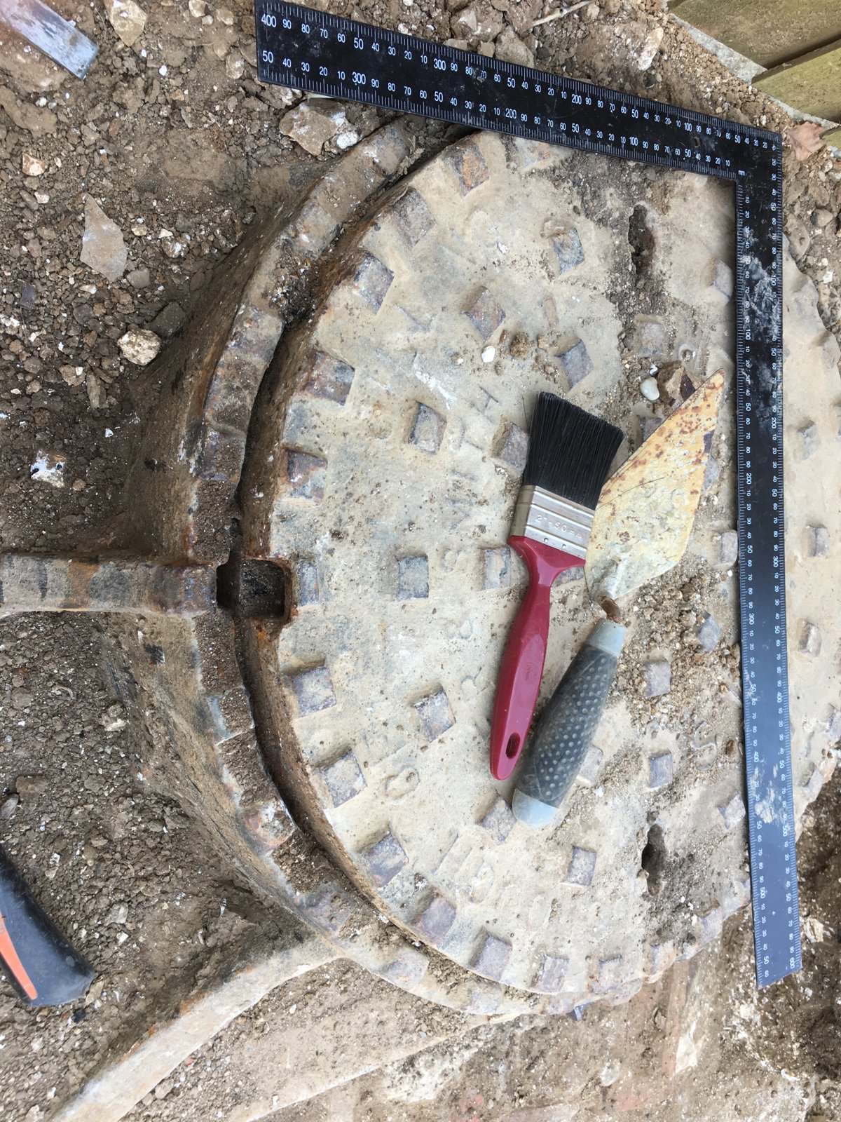

Is this a Time Team thread? If so you need to add a cheap Wilko trowel and 2" paintbrush to that set of tools on the IC lid.(y)
Nobody expects the Time Team sewer inquisition. There chief weapon is surprise, surprise and fear ....
Lid seems to be about 4 inches deep, and I’ve not got anything to lever it off further with.

Give the lid a whack around the edges with a lump hammer then jamb a crow bar into one of those key hole lugs. Get the angle right with the crow and you should be able to lift it. Its the twin iron triangle fellas you want to avoid. They can end up falling into the (usually very deep) chamber.
Crow bar is about the only tool I don’t have!

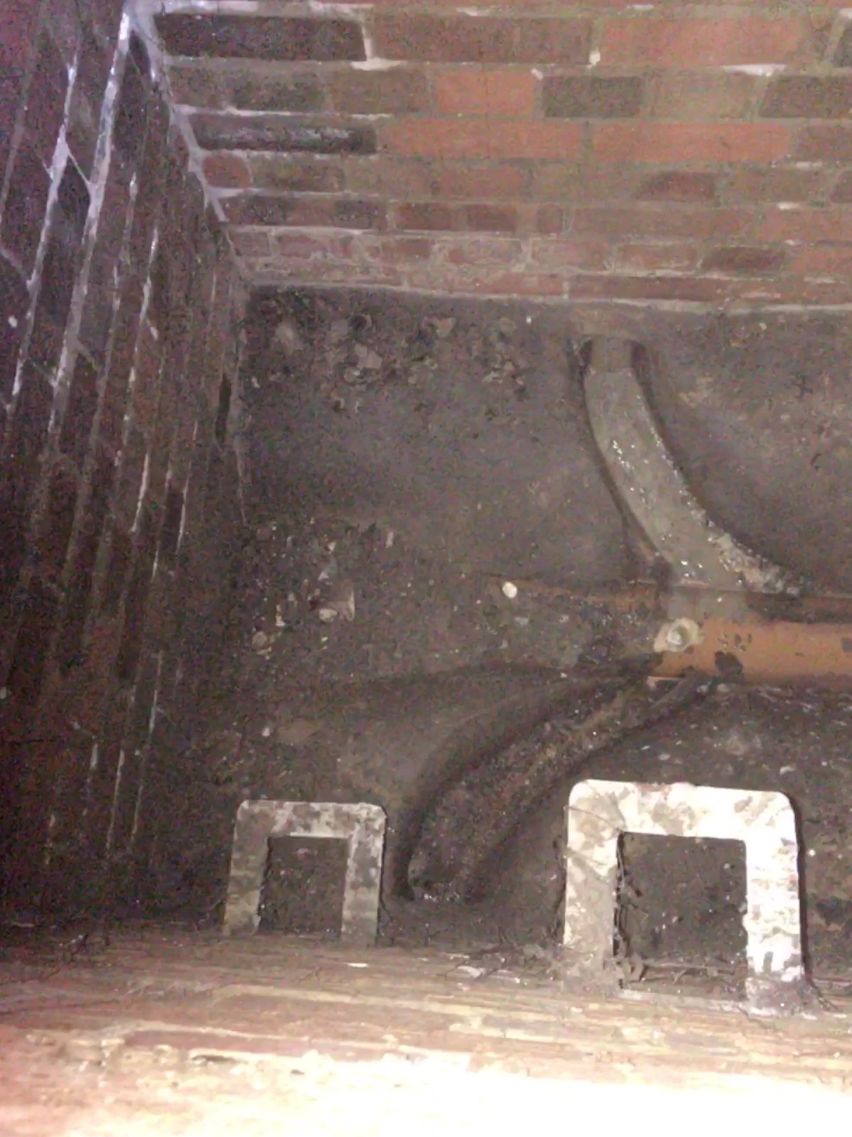

Anyway, a spade and few bit of wood do the trick to lift the whole thing.
Is currently live as I heard the house behind water come down their down pipe, and a flow through the chamber. (Which would the one at the top).
We’ve only the road to the left of us, and the straight on one looks blocked.
The strange thing being inside is only the width of the manhole cover. The big concrete slab it sits on with bricks under that is much bigger. A chamber within a chamber?
Am I any closer to being able to plant a tree anywhere near this thing?

Well, at least you know where they run and at what depth now :)
I'm no expert, of course, but I believe that being a sewer for both yourself and your neighbour the responsibility for its upkeep would lie with the water supplier.
That doesn't help with your wish to re-site it, though, I suppose.
