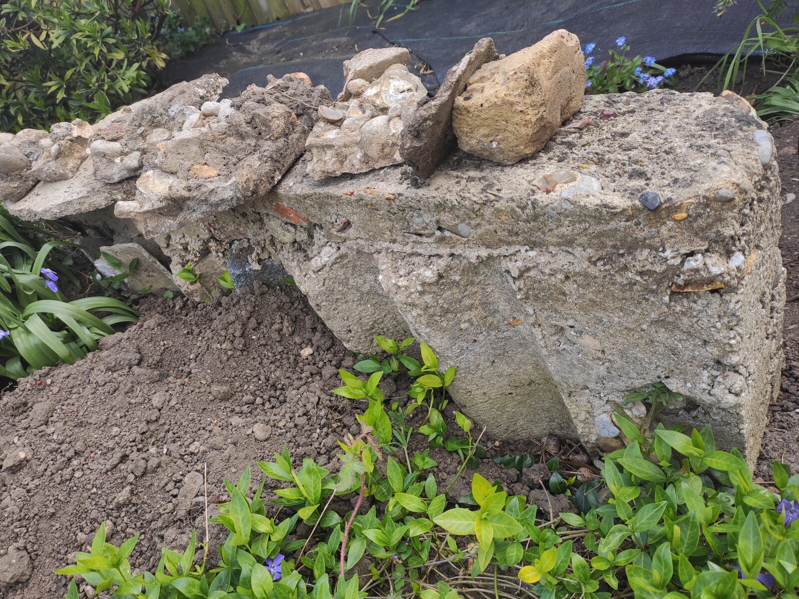

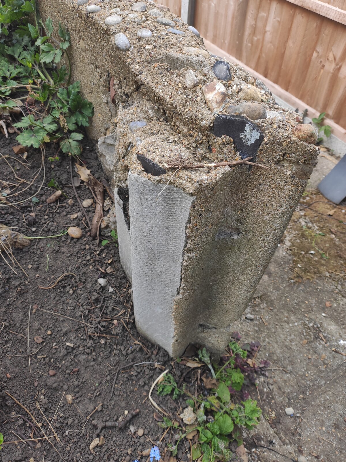

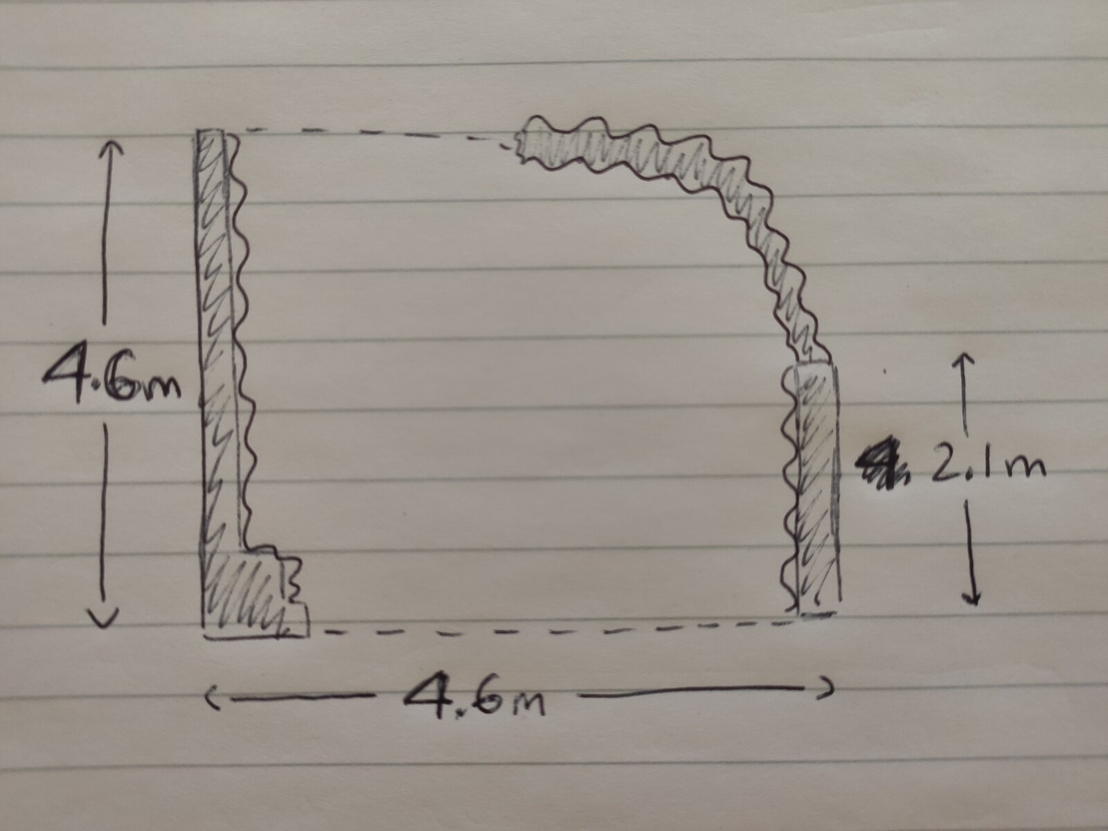

Looking for any suggestions on when and why someone would have built a cement and corrugated asbestos structure in the garden of a 1930s property in SE London. Nothing on planning permission and pretty sure it's 1980s or earlier.
See drawing!
- 2 parallel walls of roughly 4.2m and 2.1m length, 4.6m apart, made from gravel mix concrete lined with white corrugated asbestos sheets.
- One curved wall made from corrugated gravel mix concrete but no asbestos. Dotted lines show where we think walls would have been.
- Walls are max 85cm high and don't appear to have been broken off at the top.
Theories, no particular order:
1. WWII bunker / Nissen hut (odd shape though)
2. Garden room (very low walls...)
3. Garden landscaping as its currently piled high with earth and growing a couple of trees
4. Any other ideas?

surplus anderson's were sold after the war and mostly repurposed as garden sheds, so not dug into the ground or mounded over.
the shed ones generally have an ordinary door, and the door surround in brick or timber on the inside of the arch
not the flat panel, bigger than the arch, used on the ends of the shelters to retain the mounded earth covering
Looks more like asbestos cement, like they used for the roof in Marley garage kits.
Not as bad as "proper" asbestos for disposing of, but care still needed.

Thanks for the suggestions! After about more research we're pretty sure it wasn't an Anderson shelter or Nissen hut based on the size and footprint - neither would work with the curved corner on the right and based on Wikipedia the wall lengths are all wrong.
Happy to hear you agree about the asbestos Captain Nemesis:
We definitely do want to remove it - it takes up almost the whole back of the garden which is the sunniest spot! Not sure about getting the pros in at this point. Any tips?

https://www.hse.gov.uk/pubns/guidance/a14.pdf
A roof isnt too bad to deal with, and some local authorities will allow you to dispose of a certain amount for free at dumps/tips/civic amenity sites and may even offer a free collection service.
Yours might not be so straightforward, though, as presumably its cemented to the concrete, and do you have any idea how deep its buried?
Anderson. Maybe shed, maybe shelter.
Original design was to dig out a rectangle of earth a given depth, build the semi sunken shelter, then use the spoil as added protection. I believe people even grew veg on top.
Quite possibly during the war, or after, someone acquired some concrete to reinforce it, or just shore up a rusty one. Can't see why asbestos would be used unless it was acquired cheaply. We have a ww2 or later massive shed at work that was built as some kind of barn/garage that today would be steel. A shelter of garden shed wouldn't need asbestos
