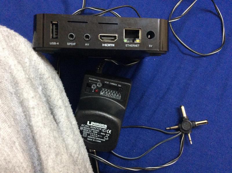

My android box came with a power plug and I use that downstairs fine. I wish to sometimes take box to my bedroom though but because wires in tv unit are not very accessible I was wondering if I can use this spare adaptor I already have in my house for power
I already have a spare hdmi so that's fine
But I don't want to damage the box if adaptor is not suitable?
Can somebody kindly explain what the + and - switch on top left is for and what I should keep on? "Polarity sw"
And then what number "volt change sw" should be on the adaptor? Ranging from off - 12
My android box says 5v at back of box....which obviously isn't an option on the adaptor
If not suitable and cause surge/voltage issues or whatever I just won't use
"Polarity" changes whether the centre pin of the power plug is positive or negative.
"Voltage" changes the output voltage.
The adapter you have is probably unregulated, which means that on a low load even the 3 or 4.5 volt settings the voltage might rise considerably above the 5V required by the android thing. On the other hand, the adapter is only 5 watt and the android thing might need rather more power at peak load.
Probably better to get a proper 5V power supply suitable for the thing.
According to its specification, how many Amps does your "Android box" require?

If you have a look at the original Android box power supply you'll find the voltage; the current, and the polarity of the power plug.
I have a similar box. I stress similar so what my power supply is labelled as might not be appropriate for yours. Do check your own power supply...
Voltage: 5V DC
Current: 2A (2 amps)
Polarity: Centre pin +ve, outer barrel -ve.
From the look of it your switchable power supply the closest voltage is 4.5V, but I'm more concerned by the current: 300mA is the same as saying 0.3A. That's just not enough to power the box under heavy load.
