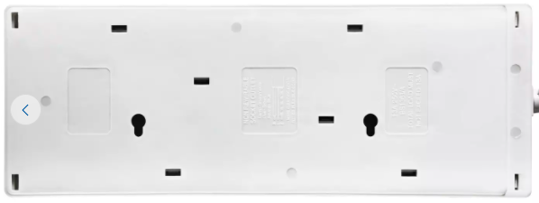

Things like this often have 'keyhole slots' on the back (as shown below) so that they can be attached vertically to a wall. Do you think they should be 'banned'? ...
Kind Regards, John
Yes, I initially wondered about that. However, I then realised that what he meant (far from clearly!) is that there is no problem with the socket, per se, being upside down, provided one doesn't plug anything into it ( :) ) - but he believes that there is a problem if, because the socket it upside down, the plug is also upside down.
However, see my response to suggestion that above!
Kind Regards, John

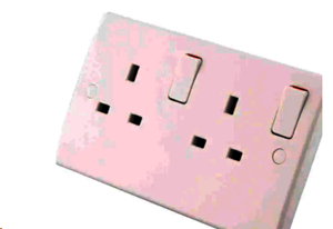

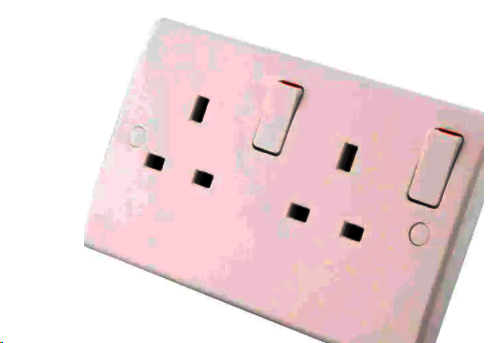

Just looked it up. Compare a white Logic Plus socket with a white M2 socket.
Thanks. There clearly is an appreciable difference but looks to be a little under 1.5cm - which might not greatly reduce the sharpness of the bend in the cable where it exits the plug (particularly the moulded plug which the OP has illustrated in post #6, which has a pretty long, probably fairly 'rigid', 'sleeve' sticking out of it).
In fact, the Logic Plus one you have illustrated seems to have an unusually 'low' positioning of the pin apertures (which are, for most makes, roughly {vertically} central on the faceplate), and what the OP already has (right-hand photo below), which he says gives inadequate room for his plug, is probably closer to the MT one than the Logic Plus one. (left to right: Logic Plus, M2, OP's) ...
