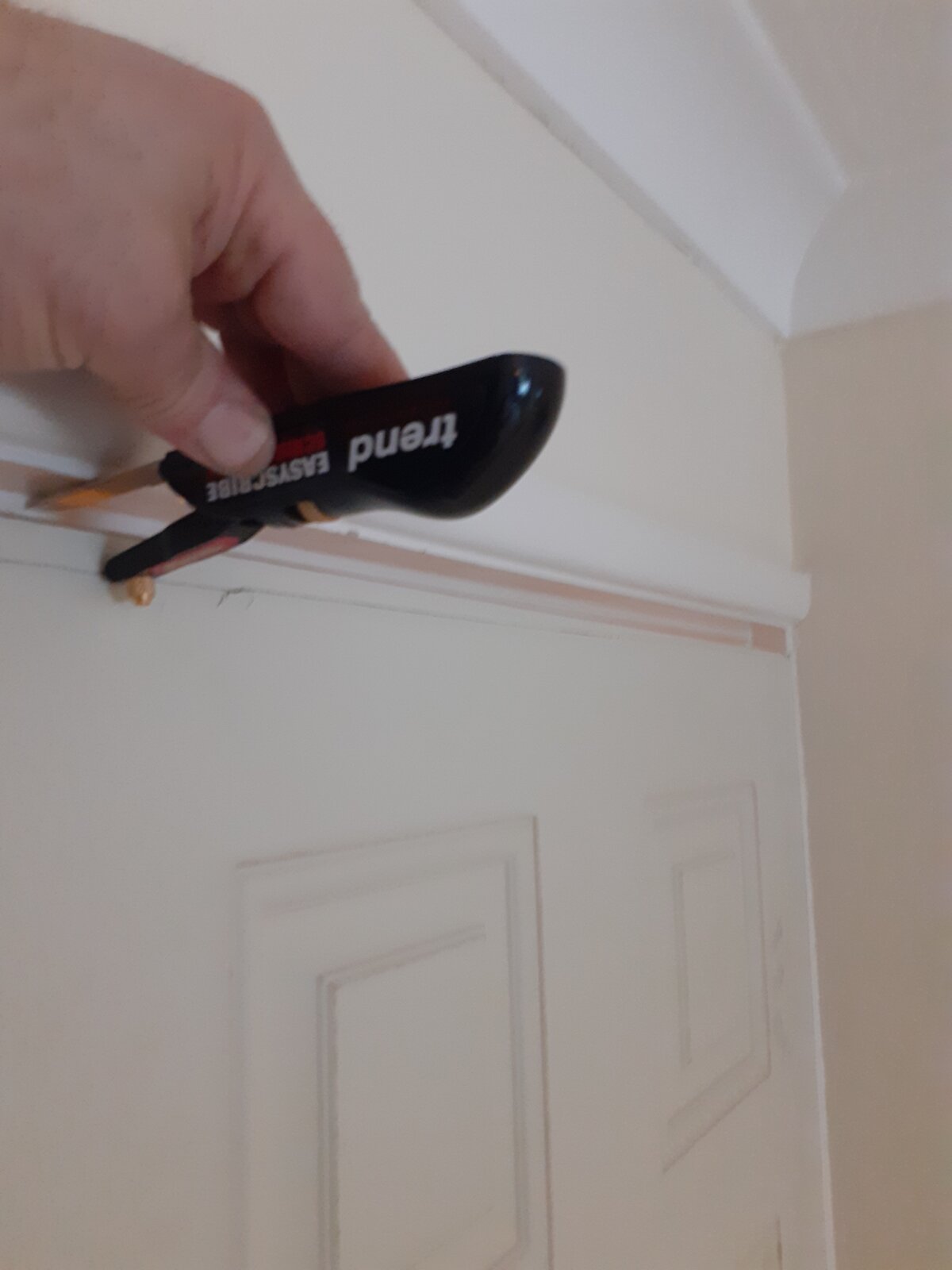

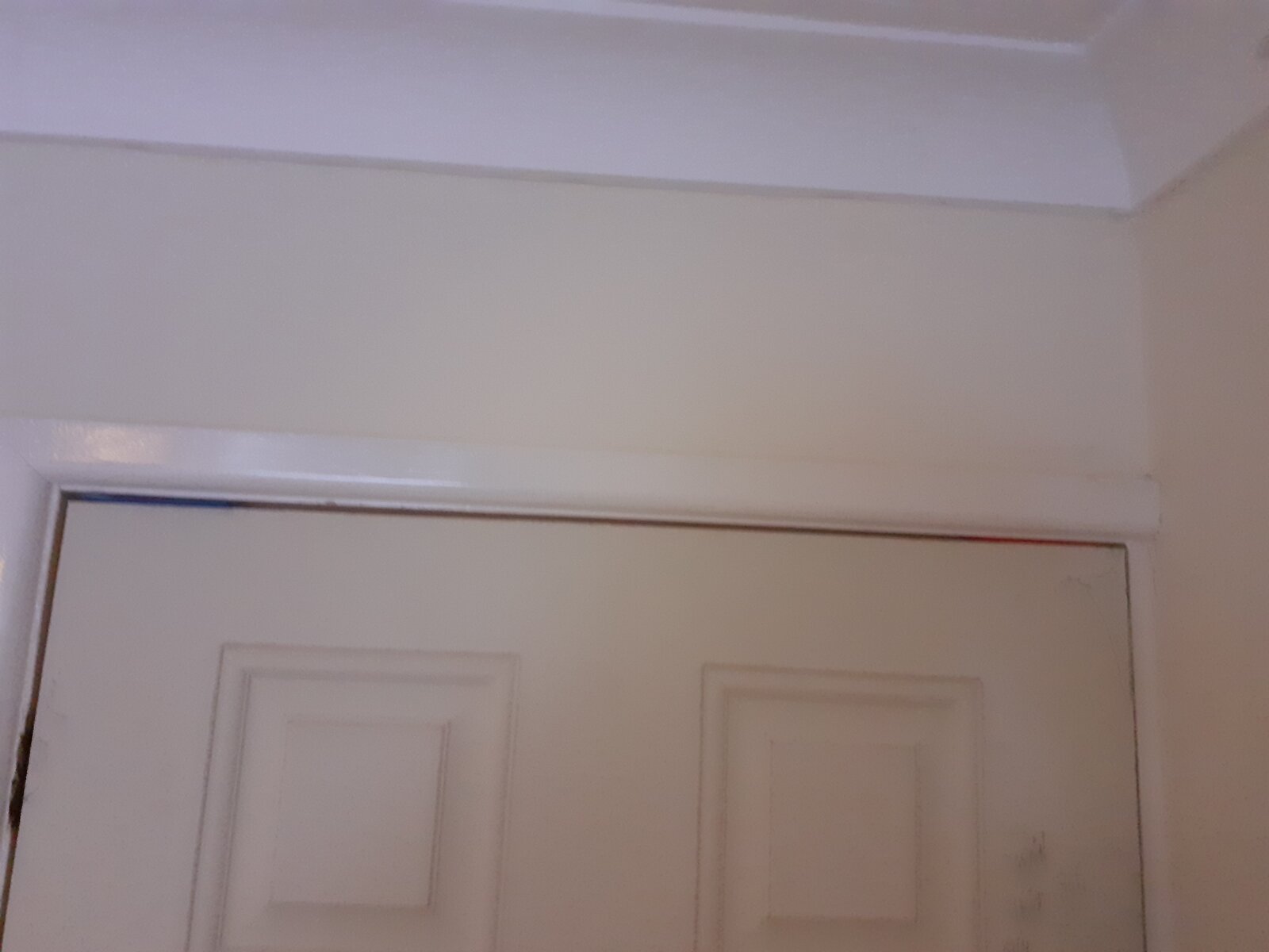

The top of the door lining in my flat isn't level.
How do I position door so I can scribe top in with 2mm packer? Put door on floor and then scribe?
You don’t need to scribe door .

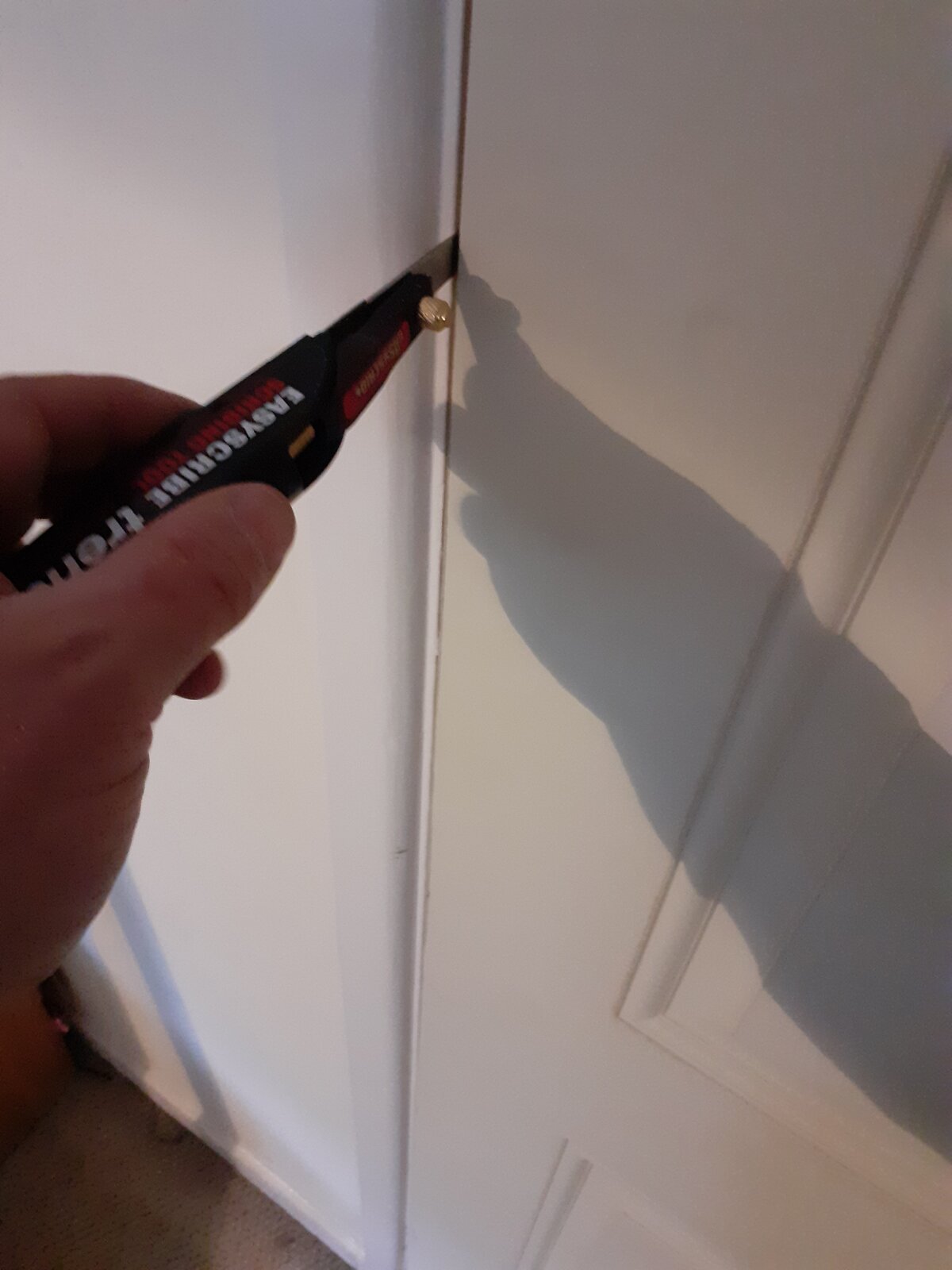

As I couldn't get a packer down the gap on sides i tried the Trend Easy scribe instead but gave up and just guessed and marked bits here and there for planing.
Used scriber on top though. On top I took loads off. 20mm one side down to 5mm (a guess) totally slanted. Maybe too much. Used circular saw to cut it.

You haven't actually cut 20mm one side To 5mm tother have you :eek:, you dont take anything off the narrow side and reduce the 20mm by 5mm to 15 mm so the cut is 15m tappered to nothing ..thats scribing in general if ive understood what your trying to do?

I tend to get it fitting in the width first, leaving it tight in the height, then scribe the top afterwards. If the variation at the top) is only a couple of millimetres this can be measured, marked out the door then planed in. When you've got the top and sides done you can tackle the bottom.
I tend to just hold the door in place with packers and wedges (or these days packers and Winbags) then eyeball the gap when I'm checking it - having a visually even gap round the three sides (left, top, right) can make even a barrel shaped door lining look better.

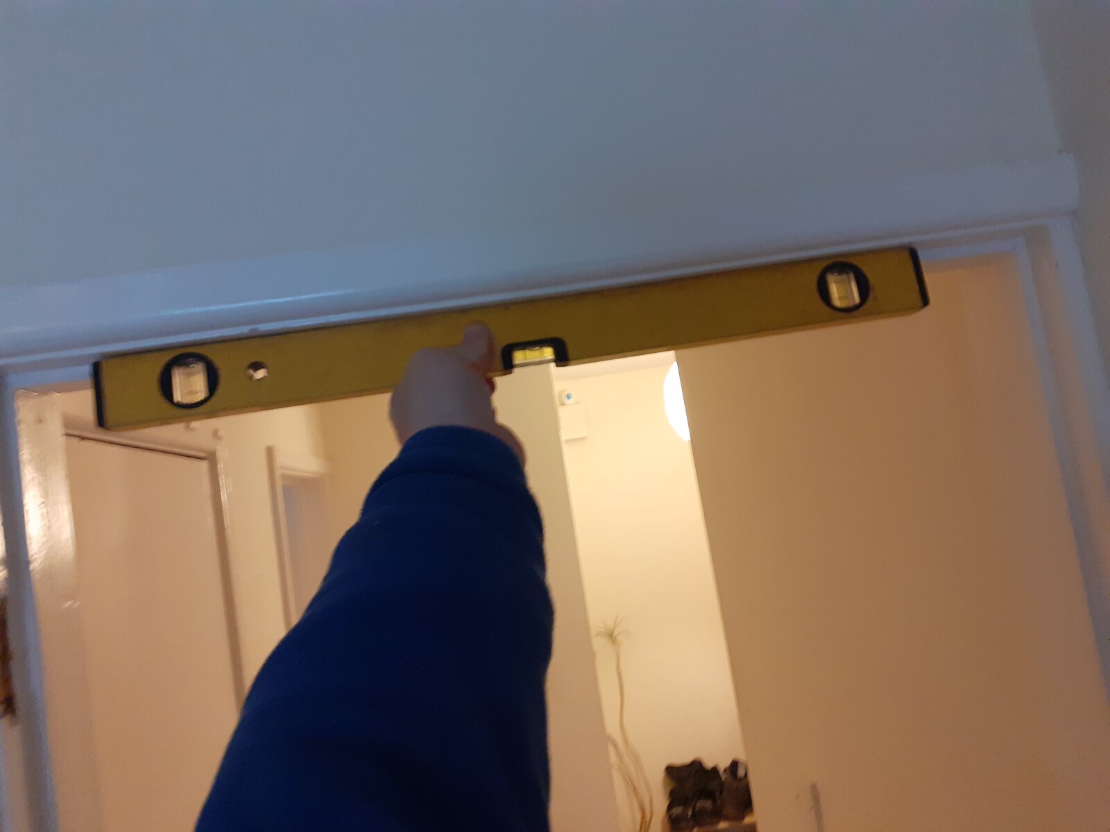

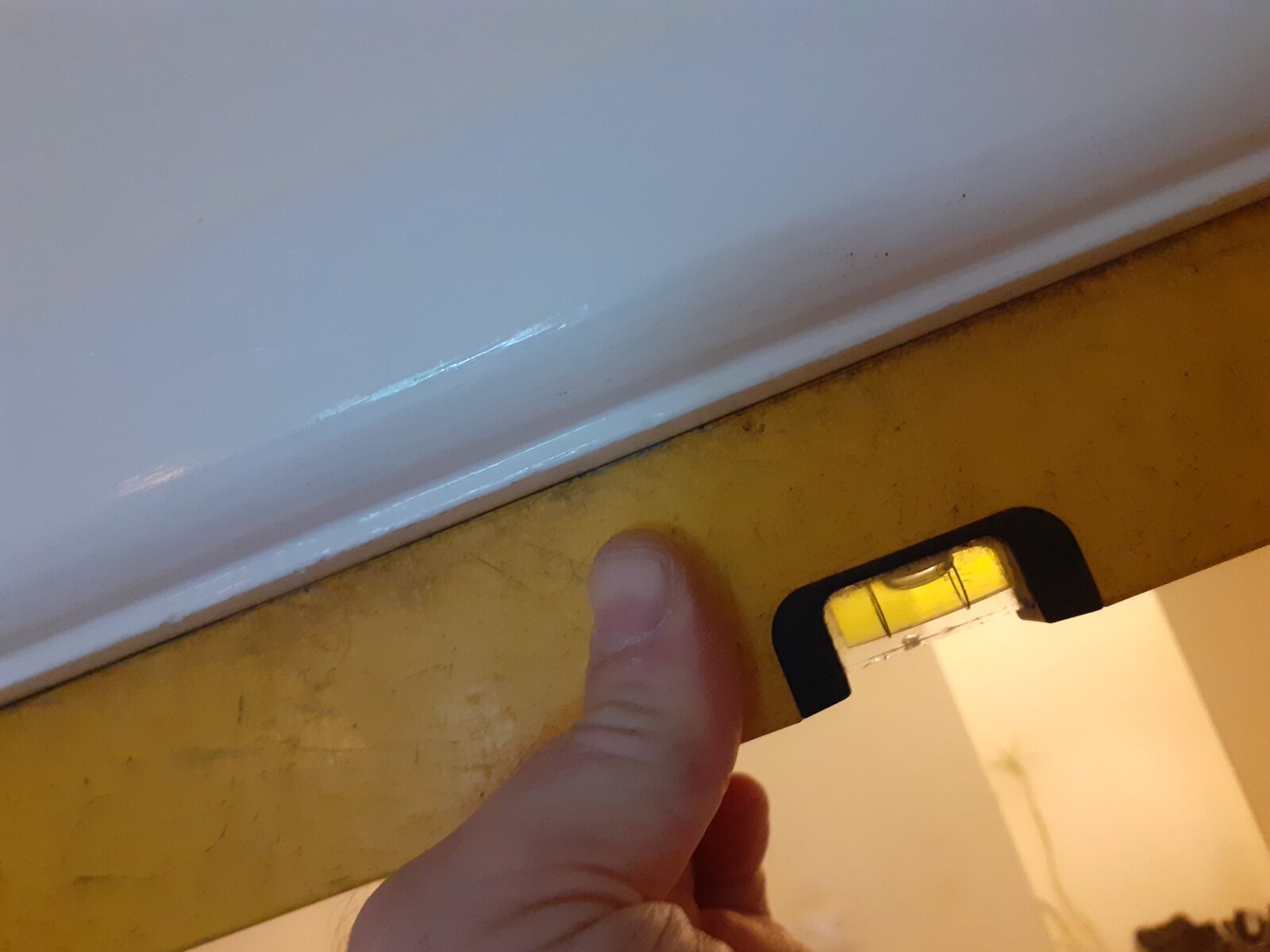

I'd start by putting a 6ft level inside the rebates to gauge whether or not the jambs are straight, pin-cushioned or barrelled ,(the terms should be self explanatory). That gives you an indication of what too expect. I generally trim the width to fit tightly which at least allows me to "get the wood in the hole" so I can see if the head is parallel to the top of the door, or if that needs to be adjusted. How much you take off and in what order is really a judgement call. The approach taken can never be a "one size fits all" one
Yes, this really is an in and out process, because old jambs are rarely straight or perfectly parallel (IMHO a lot of new ones aren't anything to shout about, for that matter) it can't be a simple measure/cut/swing process. And the older the building, the worse it generally gets because of issues like settlement. That said most of the time I can do the job in two or three passes in the 'hole before my fit is good-ish (and on the rare occasions it goes in first time spot-on - but they are flukes :sneaky: ). All it takes is practice and patience
