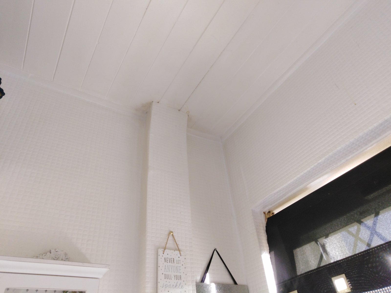

Hi, I live in a 4 in a block building, I'm ground floor. A week ago I had a heavy drip from ceiling (see pic) The box is pipework to upstairs flat. It was a decent amount of water, my neighbours washing was on, she put it off, the drip stopped. She hasn't run it for a week, no drips. Plumber came to neighbours today and couldn't find anything, he ran the machine. Where else can the water have come from. We had insulated render installed a couple of years ago, but there has never been any damp etc. It's not dripping now but if it does I need to find where?

It's a no brainer, you're right, if you are in a flat and she is up the stairs and it's coming from your ceiling then it has to be coming from something of hers she is using. You shouldn't have anything like that in the ceiling. Unless there is a communal pipe leaking in that part of the ceiling. Either way you are going to have to open the section where the water is coming from and trace back.
2 things, take pics and a video when it happens and go and get her and show her it.

What pipework does that boxing in contain?
Intermittent leaks are more often than not coming from waste pipes , does that boxing in contain any?
Leaks from hot/cold feeds would happen almost continuously

A picture where the washing machine drain hose connects would be useful...so many standpipes are too short/poorly supported, hoses are not tied down etc. or blocked pipework.
The box contains water pipes, no waste pipe to upstairs, the stopcocks in my flat. It hasn't happened again, just once on sat 16th Nov. If it happens again I could use my emergency number on my home insurance, but if its not my pipe leaking they may not pay for the repair. Plus they only pay up to 200 for water leaks
