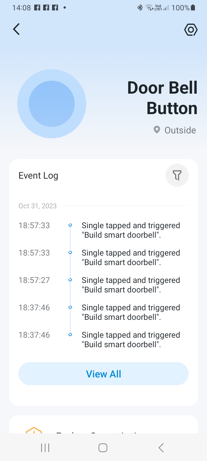

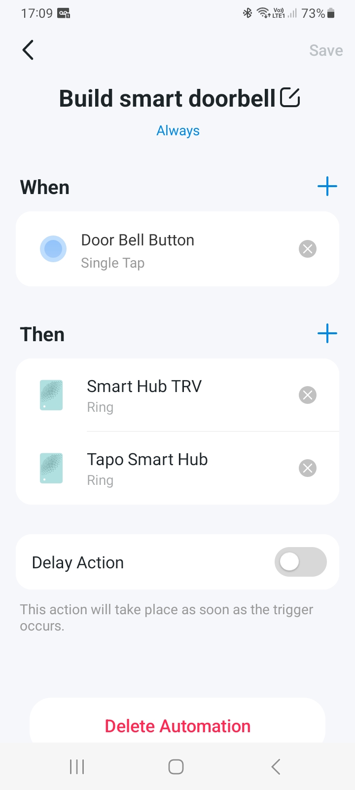

The method I use it possibly too expensive, I use LP-link (Tapo and Kasa) hubs which double as sounders, and a Tapo button, this shows how I have added two sounders. Shows one door bell to two hubs_20231007_170929_Tapo.jpgIt also logs when used Door bell report.jpg but I am sure there are cheaper methods, I had originally used the button to turn on/off lights, and I needed two hubs as some functions only work with Tapo and others (TRV heads) only with Kasa when I bought the system. But it shows it can be done.
