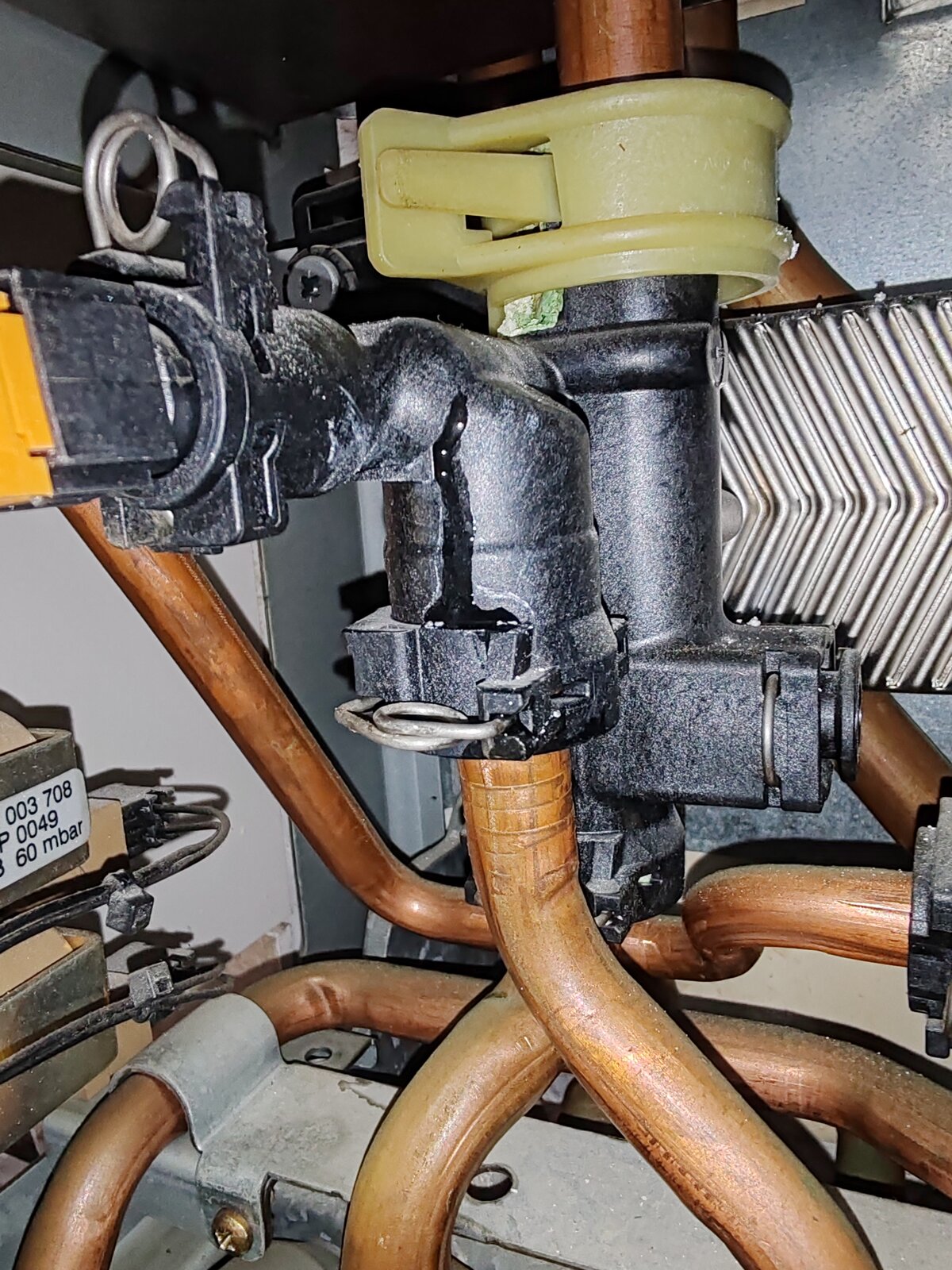

Unusually water leak on a Worcester Greenstar 25cdi boiler. The plastic section behind the dhw temperature sensor has developed a slow leak.
8 Jun 2003
3
Hi
As you can see on the attached picture a slow leak has developed on this large plastic piece.
I am trying to find out is the leak is fixable and if so with what?
If the leak cannot be fixed can that whole plastic section be purchased as a replacement part?
Nothing unusual about that part leaking, quite common. Usually because the boiler has been installed without a shock arrestor. Relatively easy job. Might be a good idea to do the right hand block too, with a new flow adaptor and silencers.
Not as cheap or as easy, and fit a shock arrestor too.
