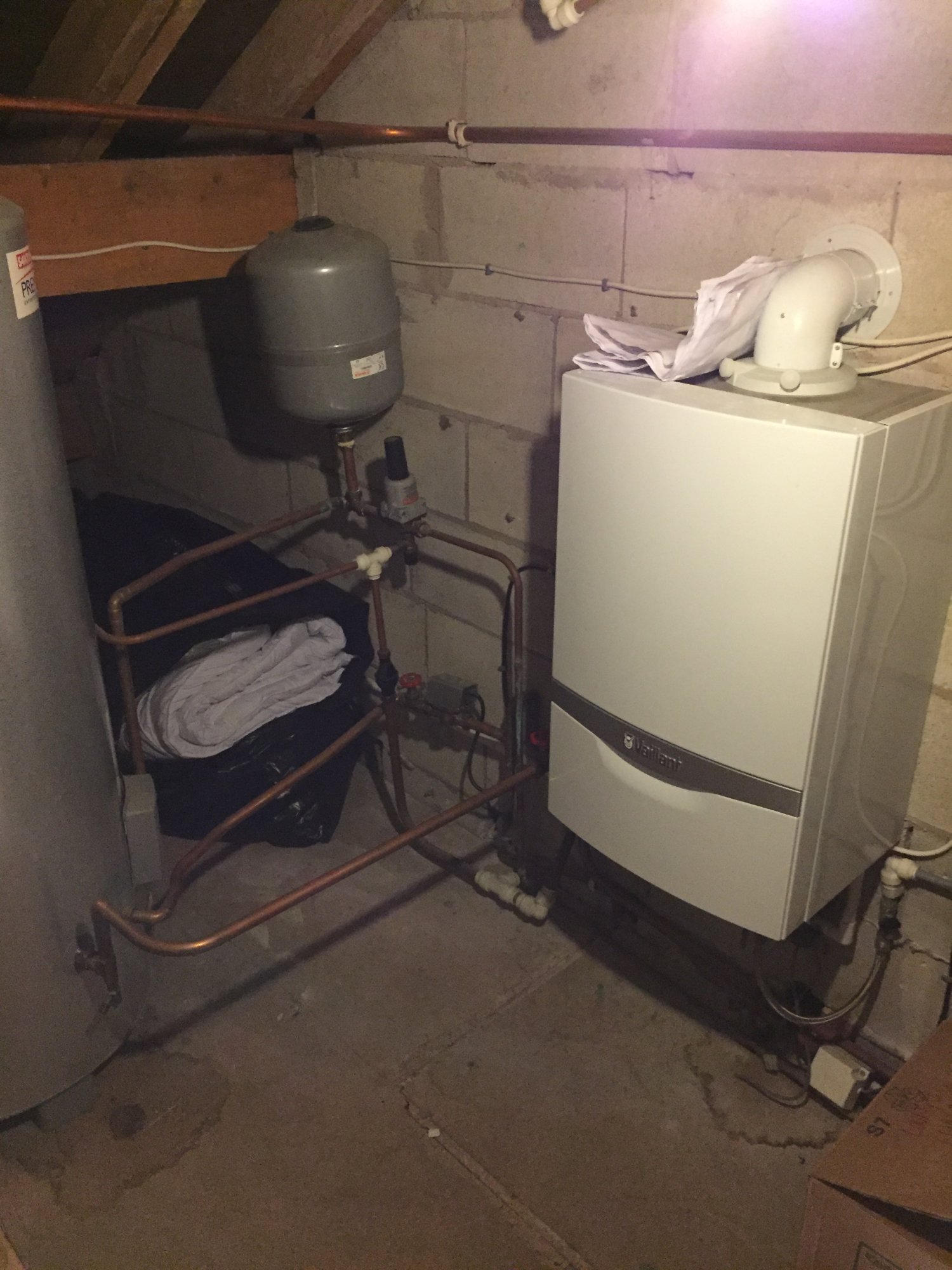

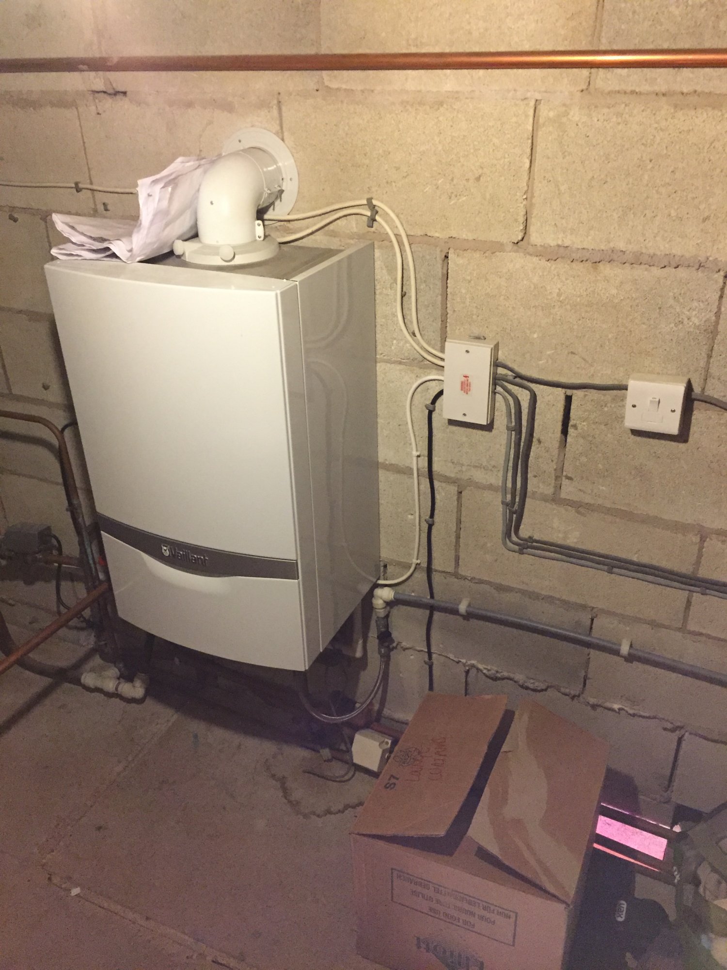

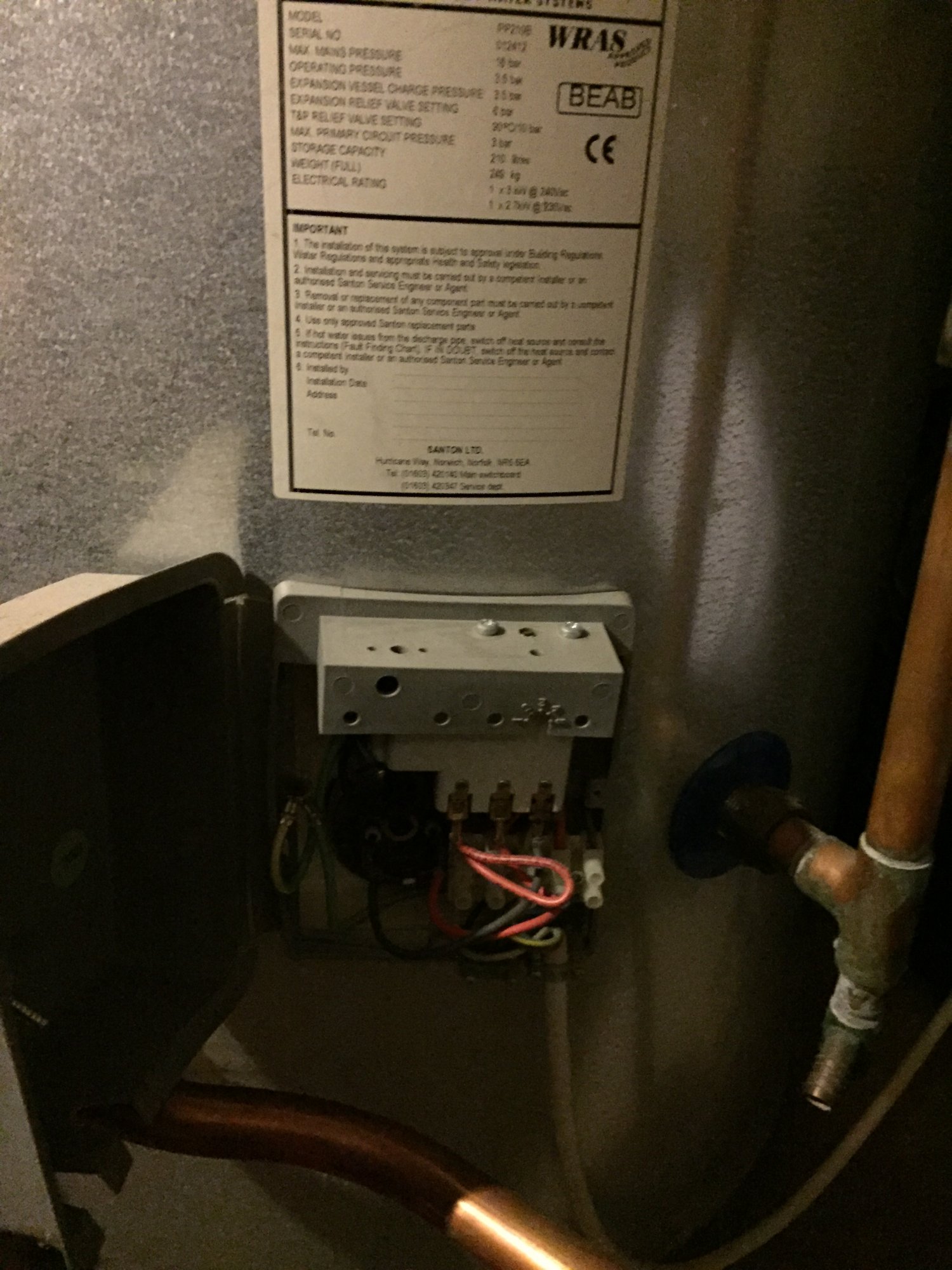

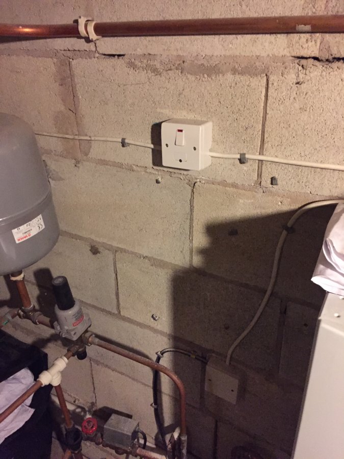

It isn't simply wired to a socket so I've taken a few photos to help. The switch on the wall turns everything off including the boiler.

There should be two cables coming from your hot water cylinder.
The thinner of the two will be the connection between the cylinder thermostat and the boiler wiring centre (between boiler and wall switch in picture 2).
The thicker will be the power supply to the immersion heater. Follow the thicker wire to what should be a switched, fused, connection unit (FCU) - NOT the boiler on / off switch. Switch off at the FCU.
The immersion heater need only be used as a back up to give you hot water, but no central heating, in the event of boiler malfunction. It can normally be left switched off.
Also, remember that unvented cylinders and their controls should be serviced annually, as should the boiler.

Just thought I'd send an update and thank you all for your comments, some more constructive than others but all in good spirit :)
After the useful info from old buffer I identified that there was no FCU, so I've wired one in to compliment my wonderful installation (no idea who installed it but it certainly was not me). I'll let you know how I get on, cheers
