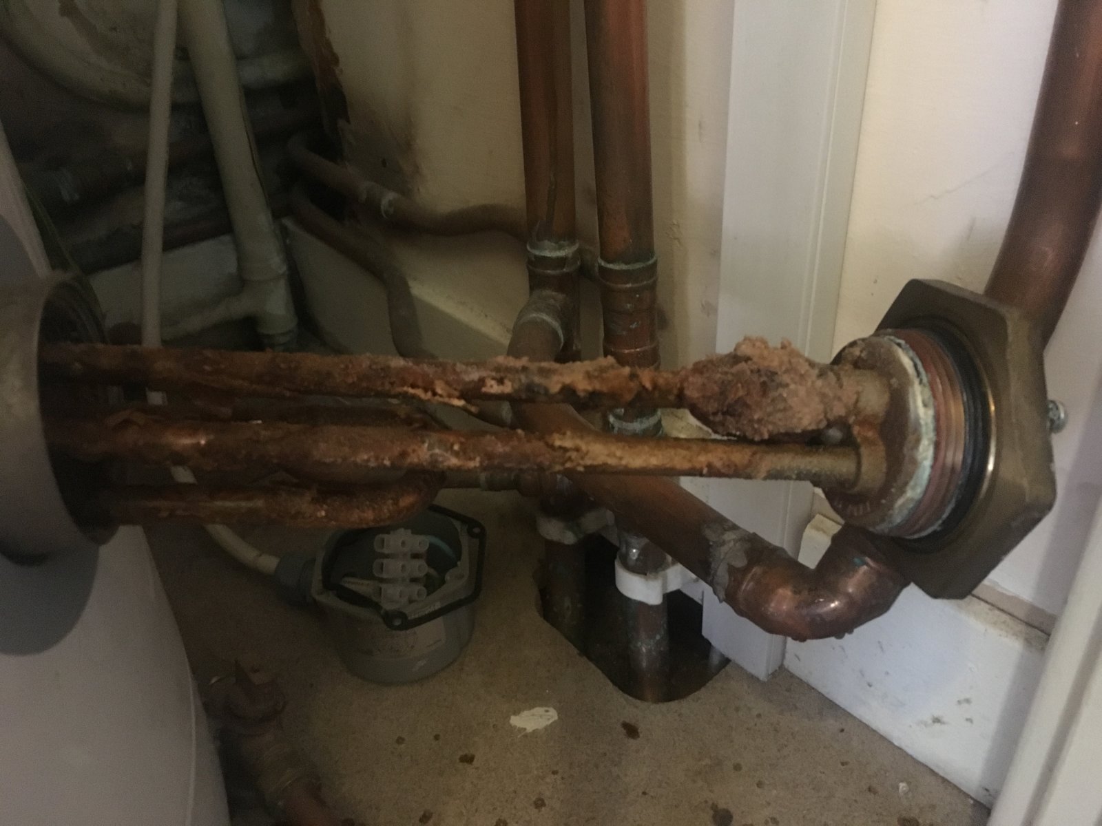

"Ariston Aquabravo ITD unvented. 5 yrs old. The lower element wasn’t heating so had the spark who installed it all investigate today."

Outlet pipework from tundish discharge , wrong material, never tested, Expansion depleted and cylinder discharging but underfloor joints leaking and coming through downstairs ceiling, immersions replaced by wrong elements, anodes never checked the list goes on

Advice above seemed to be just needing a ‘stat so I got one. You’ll see above accessing was a concern. I wanted to see if it was going to be possible to replace the ‘stat by removing the whole element (the thinking being more ability to angle the element and pull it out once it was freed whereas the ‘stat pretty much has to be withdrawn horizontally).
I therefore drained the cylinder to see if the whole element would come out (it won’t). I also felt seeing the element/s was sensible before just getting the stat only fitted. See picture.
The cylinder is less than 4.5 years old. I can’t believe the condition of the element. I have had the system “serviced”/checked twice. I was happy enough with the visits but I recognise (especially now) they didn’t involve changing/inspecting the anodes or elements.

I’ve sent Ariston the picture and I think they’ve taken the condition of this element fairly seriously but I’m not holding my breath on a positive response. In Edinburgh our water isn’t known to cause things like this. I honestly expected the element/s and anodes to look in ok nick mainly because of our water up here supposedly being really good.
Anyway, while some will say I shouldn’t have emptied the cylinder I’m glad I did so as have inspected the parts myself otherwise I may have just had a new thermostat fitted. I will now of course need to get two complete elements and see what can be done to move the cylinder round for better access. Crazy design of the cylinder having the safety valve way around from the immersions (this stopped more ideal positioning)
I am interested in opinions on the condition of the element and my thoughts on realistically how often people have the elements and anode inspected (anode and element all one but anode of course available separately). I suspect loads of people don't even know UV systems are meant to be checked regularly. Certainly not impressed by this when some old vented type cylinders seem to go on for decades problem free.
Can you post a pic of the top of that cylinder please, I dont get what you are saying about the element and anode being combined , I have never seen that
