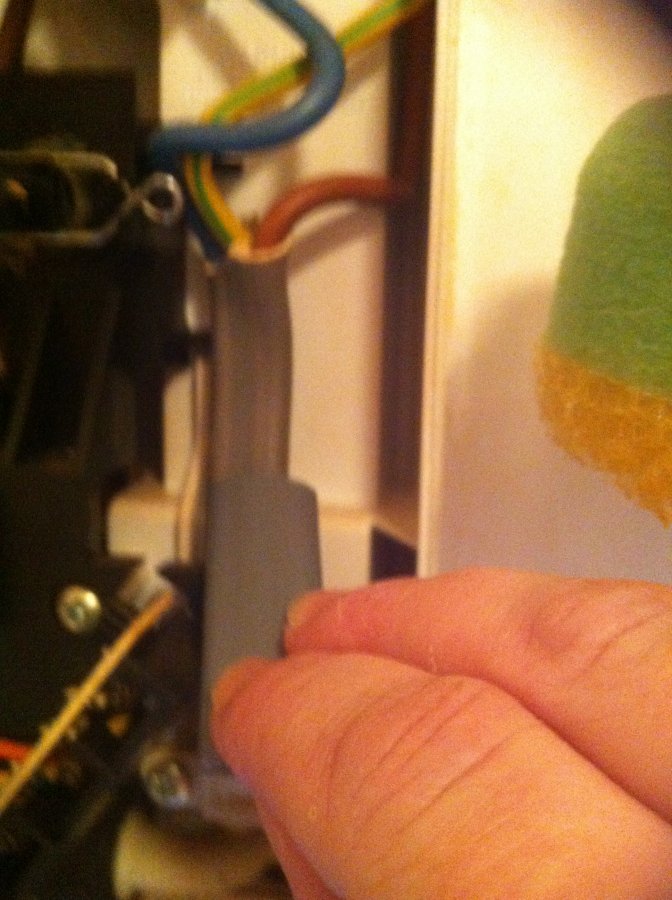

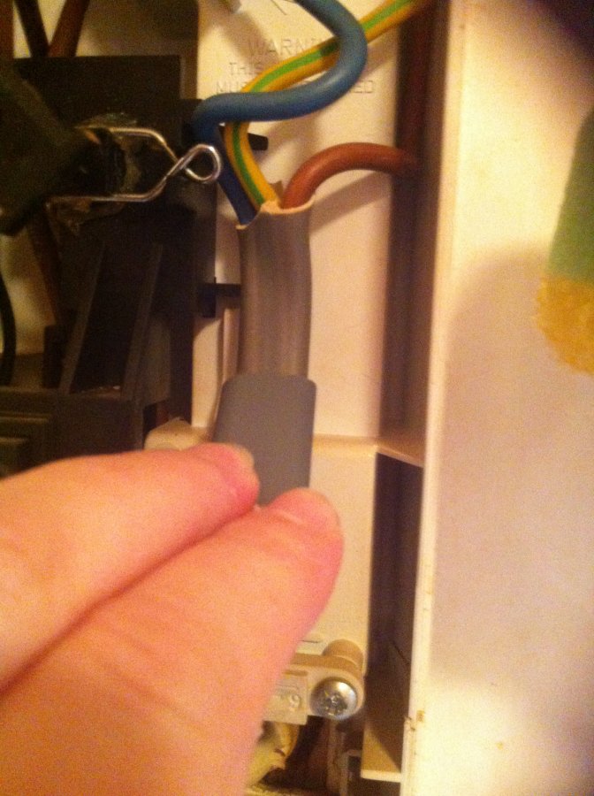

My mum was wanting to upgrade her shower - it's an 8.5kW that she has in and she was looking to get a 10.5kW shower.
I'm not sure that the cable is thick enough though. I got a bit of 10mm cable to compare the sizes and it's marginally thicker to what's in. It's on a 40amp fuse.
I'll say it's 4m from the fusebox to the shower but that's being generous as the fusebox is just outside the bathroom door.
Could a 10.5kW shower safely run on this cable (I know I'd need to put a bigger fuse in). If not, what would be the highest watt shower we could put in?

No good 'saying' what it is. You will have to make sure.
If it is 6mm² cable and runs through NO insulation or conduit then you can fit a 10.5kW shower.
You mean I need to know exactly how far the shower is from the fuse box? I'll measure it. The cable goes under the floor and there's no insultation there and I'm pretty certain there's no conduiting - not sure how I'd check on that though - I can't get under the floor any more.

Sorry, my bad - it's a 40amp MCB. I tried taking pics to show the cable that's there and the 10mm cable they gave me to compare but the cable that's in looks a little bit narrower.

Ive no problem about replacing the MCB for a 50amp but it's the cable that I'm concerned about. I can't even gauge what cable is in the existing one - I had a look at how to work it out in the wiki but it went over my head :confused:
The cable is 6mm. There are no sizes between 6 and 10mm, so if it is smaller than the 10mm piece, it is 6.
You can't use a 50A MCB, as that is greater than the cable rating, which is 47A assuming it is not contained in insulation or conduit.
A 45A MCB could be used, if one can be obtained for your consumer unit.
A 10.5kW 240V shower is 43.75A.
