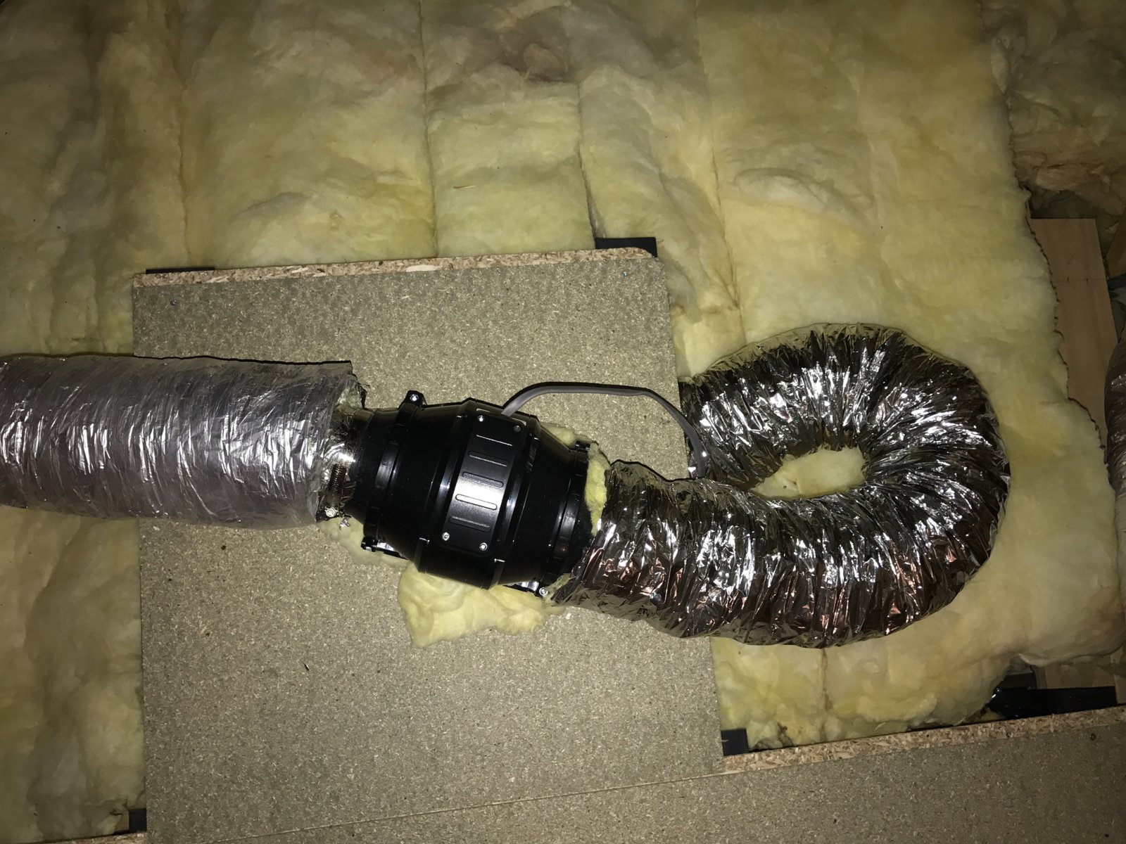

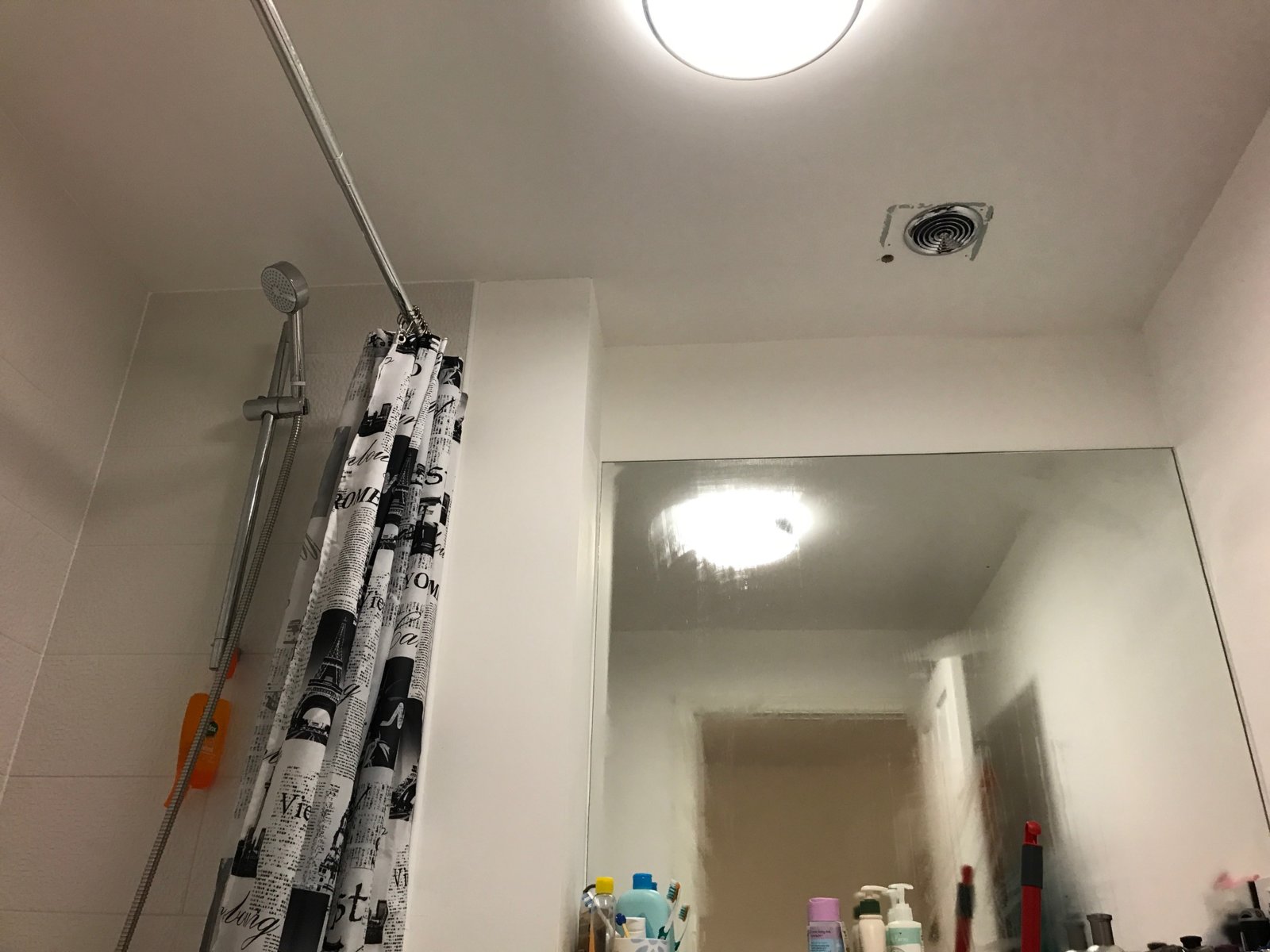

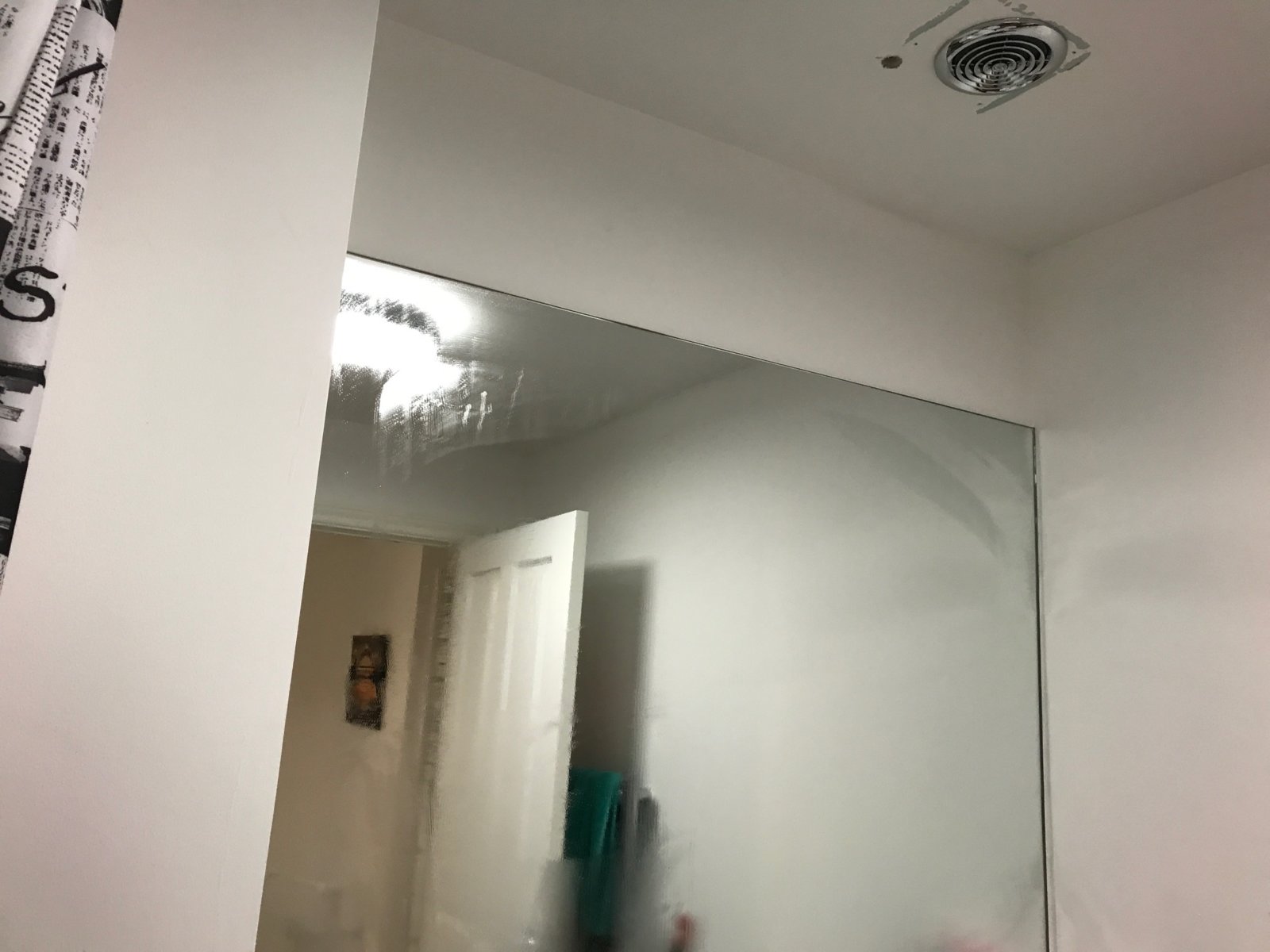

Newbuild (in 2014) house, main bathroom has no windows and mists up terribly when anyone has a shower, especially the large mirror.
Here's the layout: IMG_1323.JPG

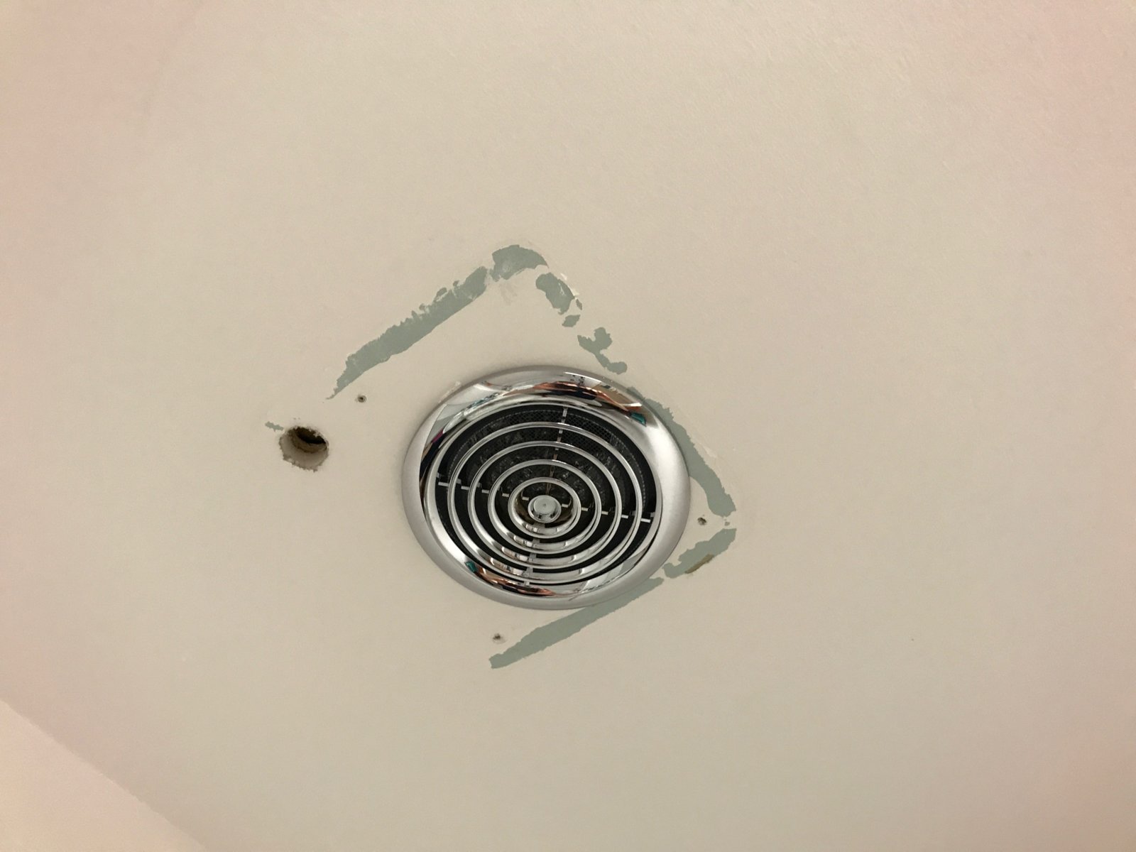

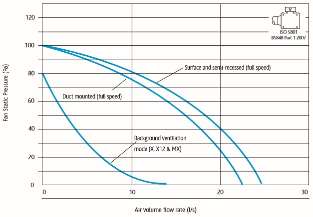

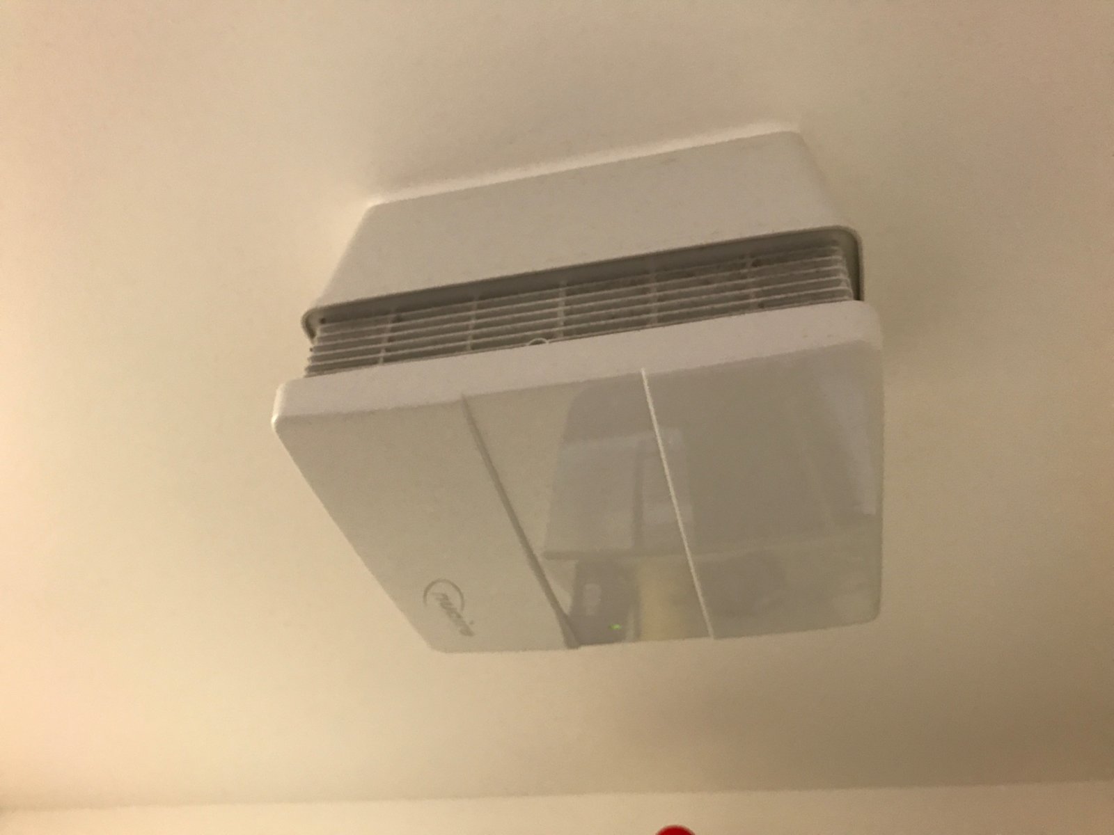

The original fan was a horrible looking surface mounted Nuaire Genie, which according to their specs produced a rather weedy max flow of 25L/s: Genie.jpg IMG_1321.JPG

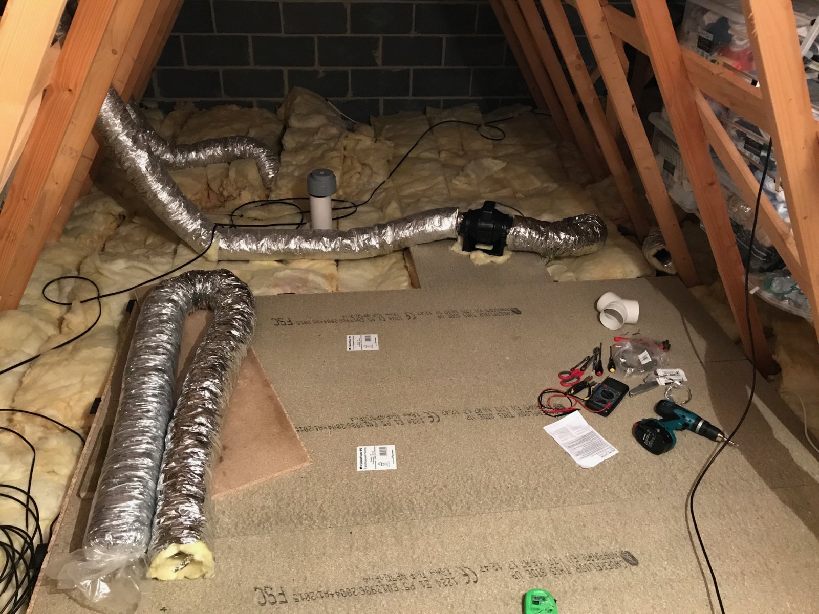

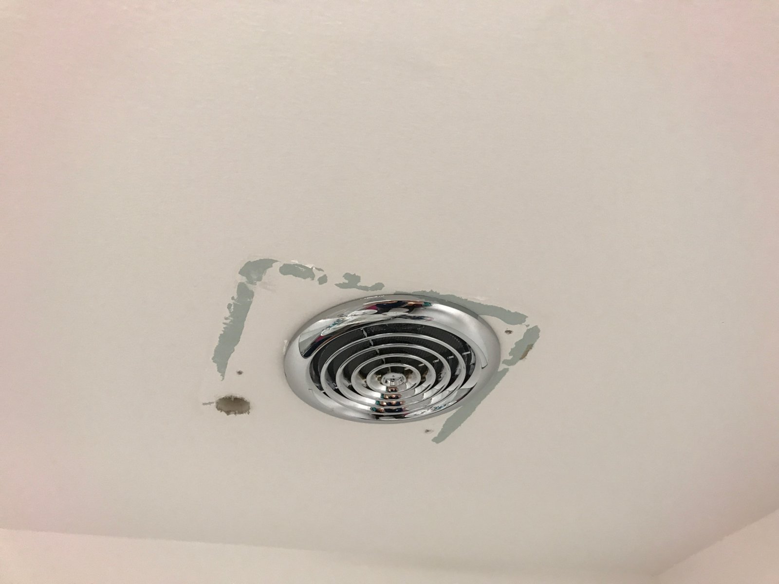

So I've upgraded the fan to an inline Manrose MF100T, which produces noticeably more airflow (max flow of 68L/s). But the bathroom still mists up badly, even if the door is left open a crack.
Any suggestions? Would moving the fan grille to above the bath/shower help? What about using a 100mm Y-junction (which I have) and having the existing grille AND a 2nd above the bath/shower?
IMG_1318.JPG IMG_1320.JPG (still some patching up to do to ceiling!)
Any suggestions appreciated!

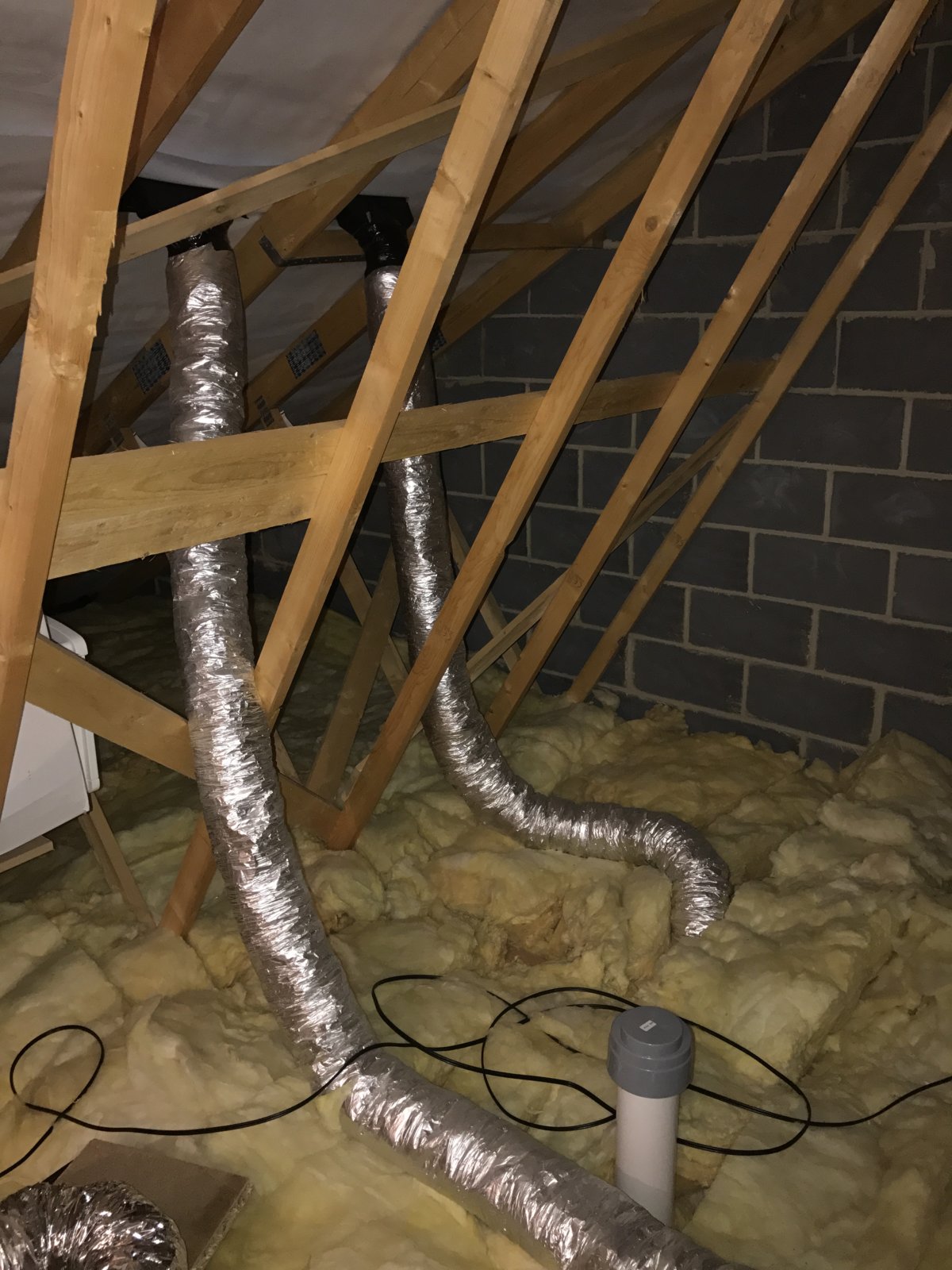

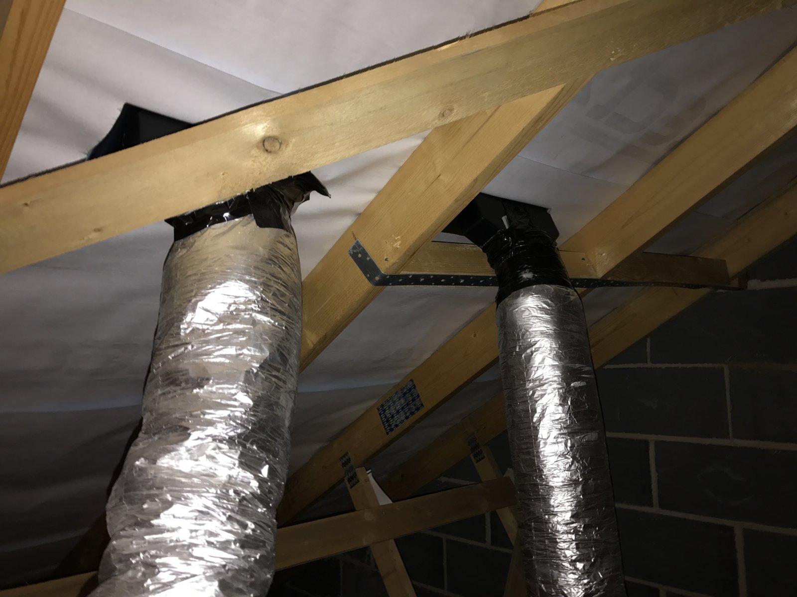

the picture of the loft ducting won't enlarge. Can you show us where it comes out?
you say there is good airflow. When does the fan turn on and off?
Thanks for replying.
Yes, airflow seems to be good enough, will easily hold a sheet of A4 paper up against the grille.
IMG_1325.JPG IMG_1326.JPG IMG_1327.JPG Hopefully these photos will work.
Fan comes on with the bathroom light (which, as there is no window, is any time someone is in the bathroom) and, unlike the previous fan, stays on for ~10mins after light is turned off.

Starting to think that a mirror that size in a smallish bathroom will always steam up when someone's in the shower, regardless of what I do. Just wish I could add heating pads to the back of it, but it's bonded to the wall (why, I don't know!).

I used a 6" fan connected to twin 4" hose inlets via a Y joint.No condensation at all even to ceiling height mirror adjacent the shower
Although a fan isn't the one-stop solution for all - there's too many variables (north facing wall, distance of fan, size of bathroom, volume of water vapour, etc., etc.)
