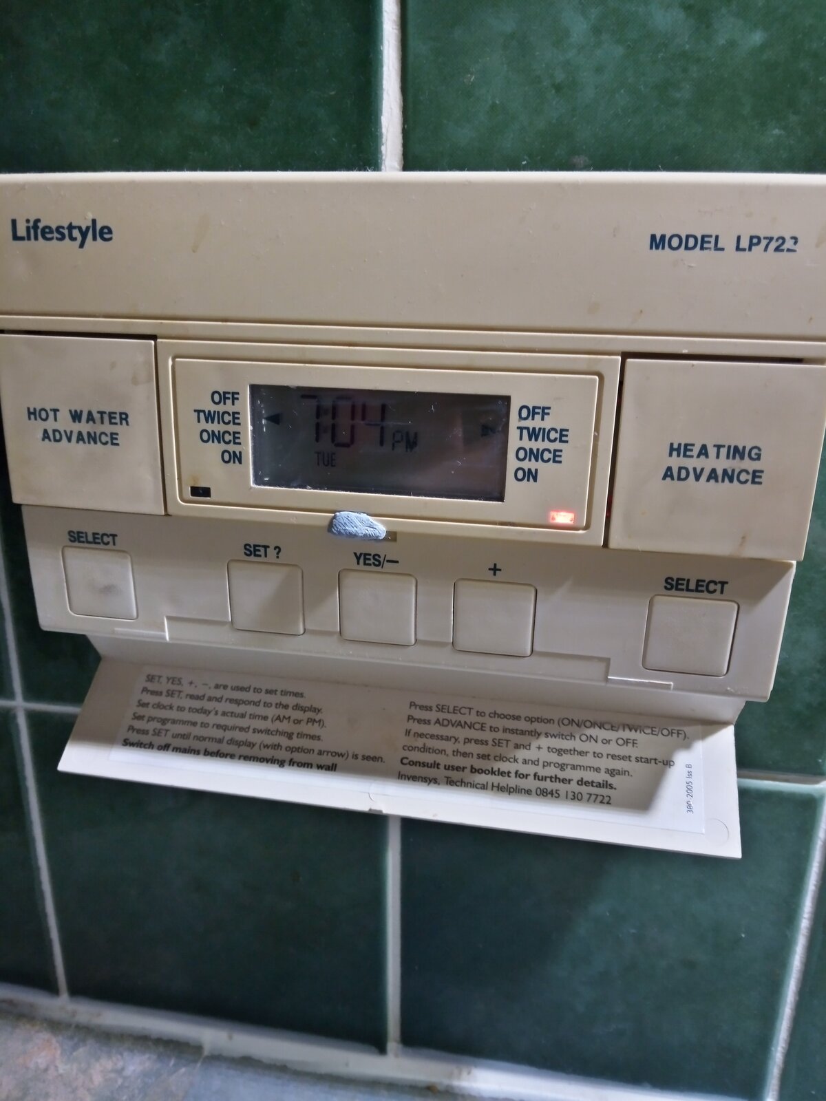

Current system is a Baxi Platinum 30 gas boiler heat only. I have a Drayton LP722 (dual - hot water and central heating control separate) programmer/controller next to boiler and a mechanical/analogue thermostat in the hallway of 2 storey house circa build 2002.
The system is working, but I can't set the heating to a higher temp ie. 20C from 15C without getting out of bed and coming downstairs first thing in morning.
Reading around it is suggested that people use the existing controller set to 24hour-7days CH on all time and use the controller just for hot water.

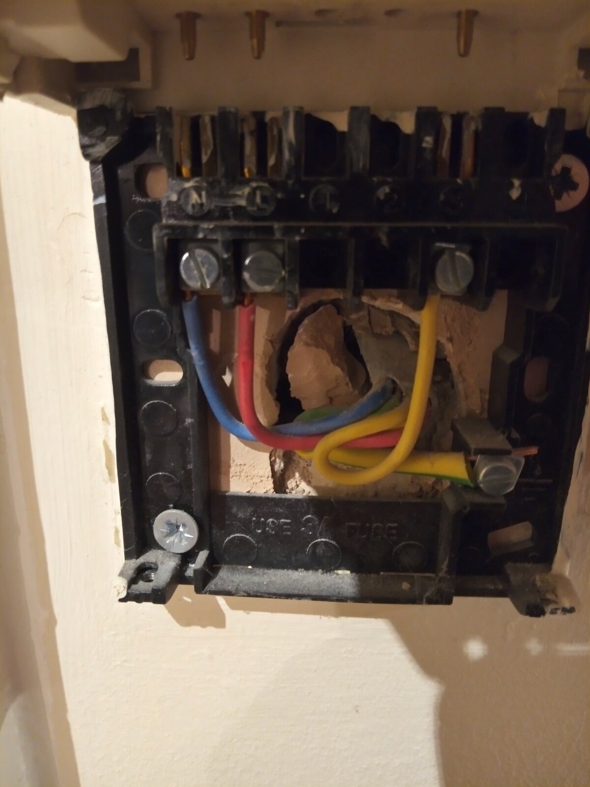

Thermostat is 3core plus earth.
Lp722 controller is 4 wire (CH on, CH off, HW on, HW off) and both have industry std plate.

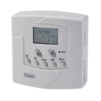

I found cheap hard wired programmable thermostats work well, ae235.jpg around £35, but with wireless had problems with lack of fail safe, if RF is lost, you want boiler to turn off, not just keep on heating. So with wireless we jump from £35 to £100 in the main.

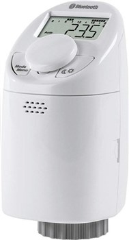

These EQ-3 Bluetooth Smart Radiator Thermostat.jpg cost me £15 each and they allow me to set temperature in each room at different times of the day, but they do not tell the boiler when to fire up. Hive TRV heads link to the Hive wall thermostat, so if we for example have two rooms, one which catches morning sun, so some times one room heats up first and on another day it is other room, a Hive wall thermostat with one linked TRV head can ensure the boiler runs when either room is cool.

I found cheap hard wired programmable thermostats work well, around £35,

The current thermostat is supplied with L, Red, N, Black, Switched live, Yellow and Earth, Yellow/Green.
See photo.
Any advice on what to do with the Drayton LP722 controller? If it fails, it appears they still sell this model. About £40 to £60.
Keep it (I have one too). You’ll need it to control timing for the hot water. Just set the heating side to always on and use the time function on the new stat.
