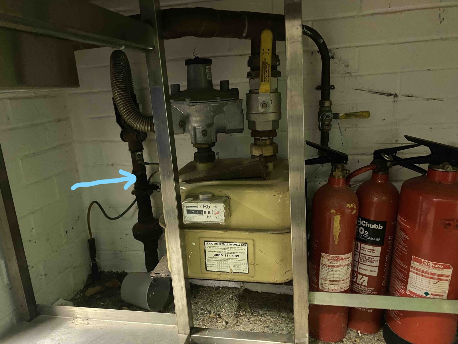

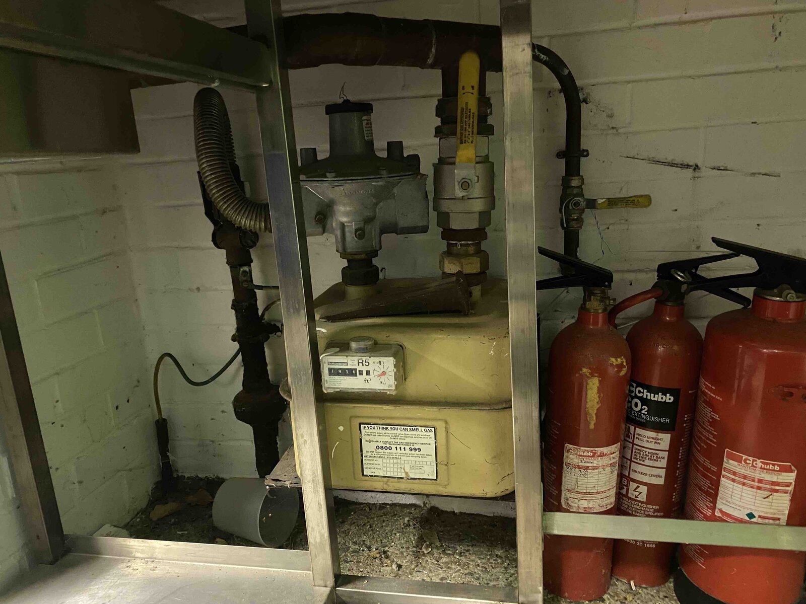

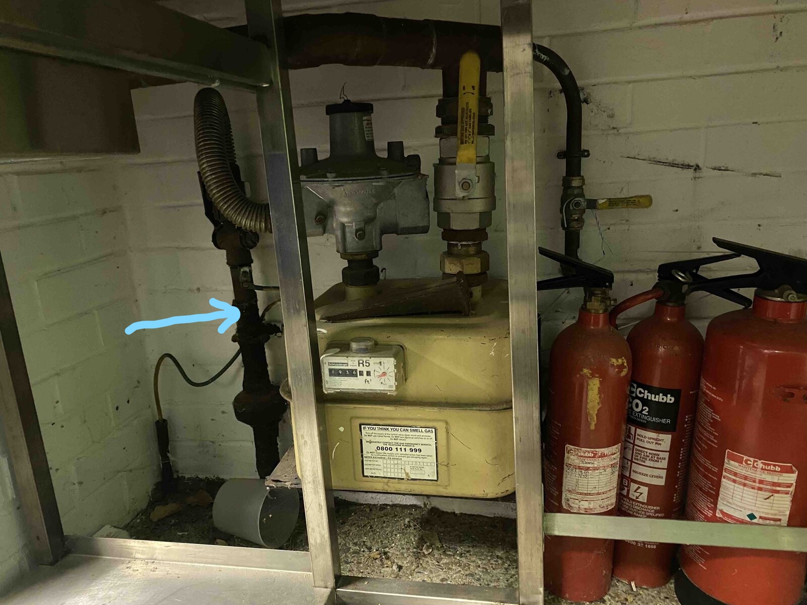

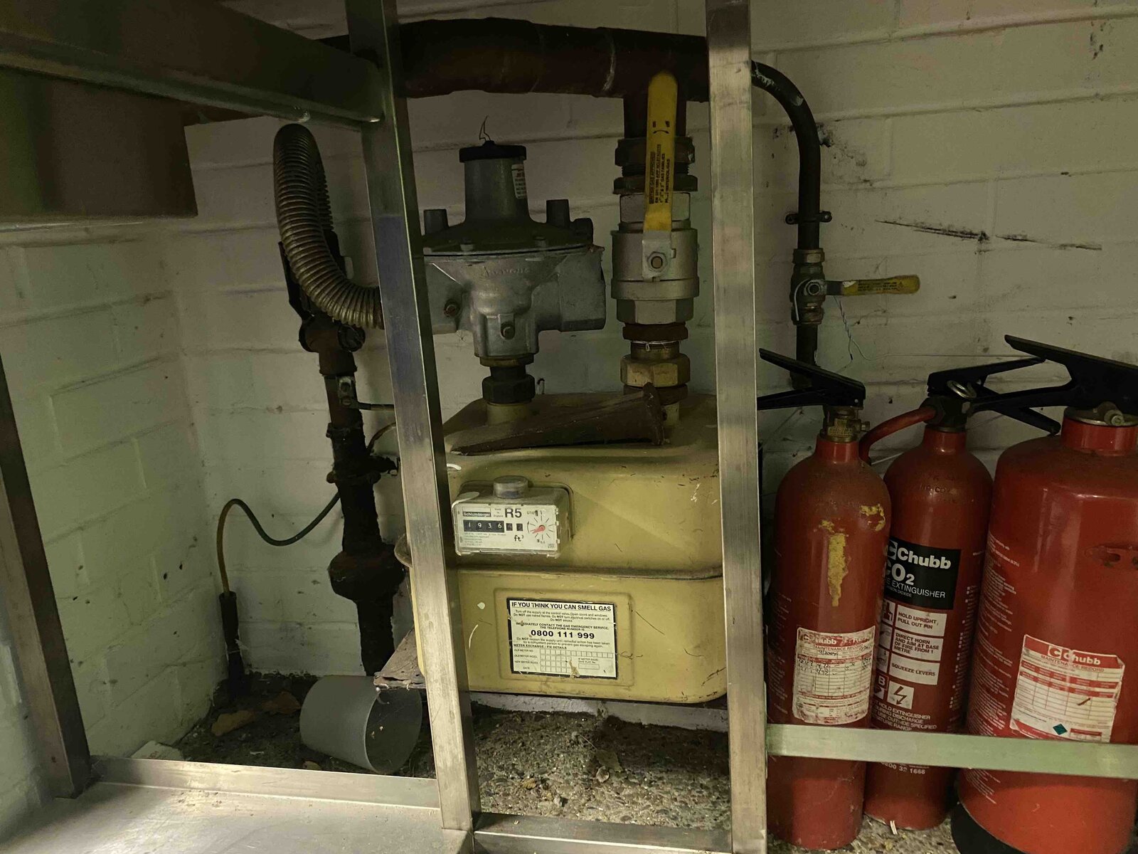

Service pipe is huge. According to the plumber (and domestic gas/heating engineer we happen to have on site today). Not sure if this picture helps!

The service pipe is the one at the left of that picture its 1" at best.

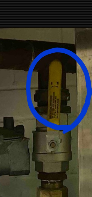

Even the shut off valve looks sad about the situation....

service is definitely too small and will need upgrading and they will be working from maps detailing sizes of pipes already in the road .
1 , He is talking shyte
2 Is also talking shyte
3 have the information to hand and know what is underground and should be working from that ,their price is their price

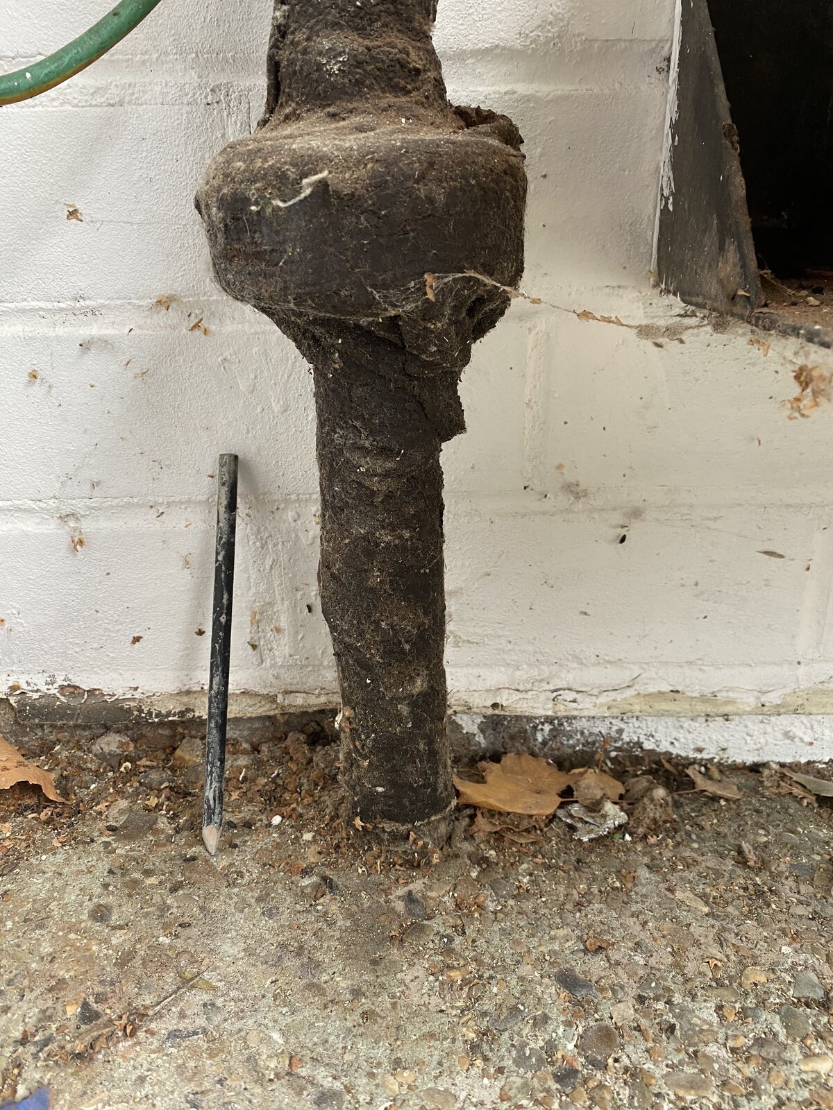

that is the service pipe and way too small for your requirements

I did say inch at best lol
Yes I agree the 133kW available sounds about right. I presume it was a GT1 survey?
They measured it with a micrometer screw gauge - 31mm apparently...
