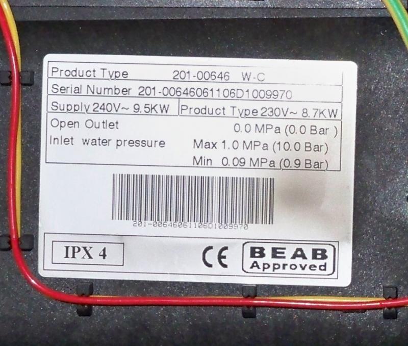

Which value would that be? If they quote two values, I don't see how that would aid people in knowing which of the two is 'the value to be used' - they would have to look elsewhere (e.g. to the regs) to discover that, wouldn't they?However, some manufacturers do quote both values ( 240 & 230 ). Not necessarily on the box but on the actual parts. It would be difficult to attribute a reason for this if it were not the value to be used, would it not?
I meant the 230 - otherwise why would they quote it?Which value would that be? If they quote two values, I don't see how that would aid people in knowing which of the two is 'the value to be used' - they would have to look elsewhere (e.g. to the regs) to discover that, wouldn't they?However, some manufacturers do quote both values ( 240 & 230 ). Not necessarily on the box but on the actual parts. It would be difficult to attribute a reason for this if it were not the value to be used, would it not?
One can but speculate. It could, for example, be for 'international' reasons - after all, 240V has always been a pretty inappropriate figure at which to quote power for most non-UK countries. Are you sure that those shower engines did not quote a power figure for 230V (or maybe 220V) before the change in nominal supply voltage.I meant the 230 - otherwise why would they quote it? Not for the general public - for the electrician. Presumably why its printed on shower engines, for example.Which value would that be? If they quote two values, I don't see how that would aid people in knowing which of the two is 'the value to be used' - they would have to look elsewhere (e.g. to the regs) to discover that, wouldn't they?
What else?Plus it's in English.
Goodness only knows - not a contender for the 'Clear Label Award'. It almost sounds as if it 'wants' a 240V supply!What is the distinction between 'Supply' and 'Product type'?
I mean that it's not just numbers - hardly appropriate for Europe.What else?![]()
