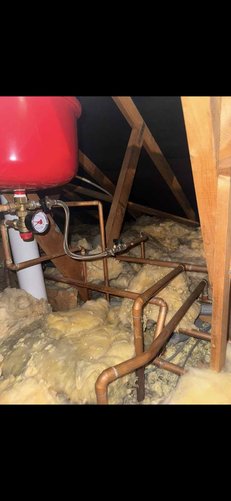

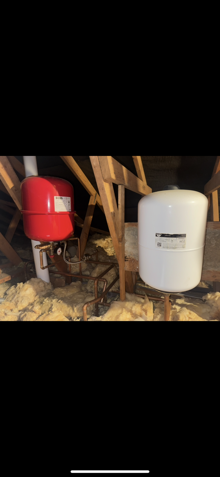

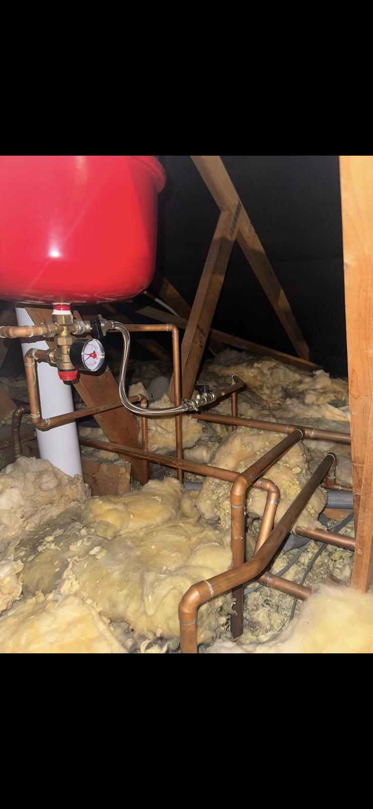

In the loft I have 2 vessels one of which looks like an expansion vessel with a pressure gauge. That is about 1.6 bar with the red fixed needle set on 2 bar.

Some pictures of the valves & things would be useful.

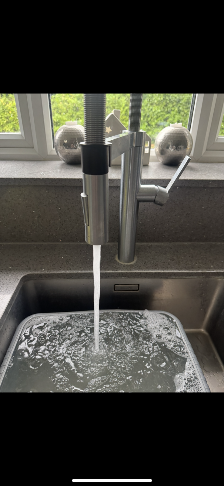

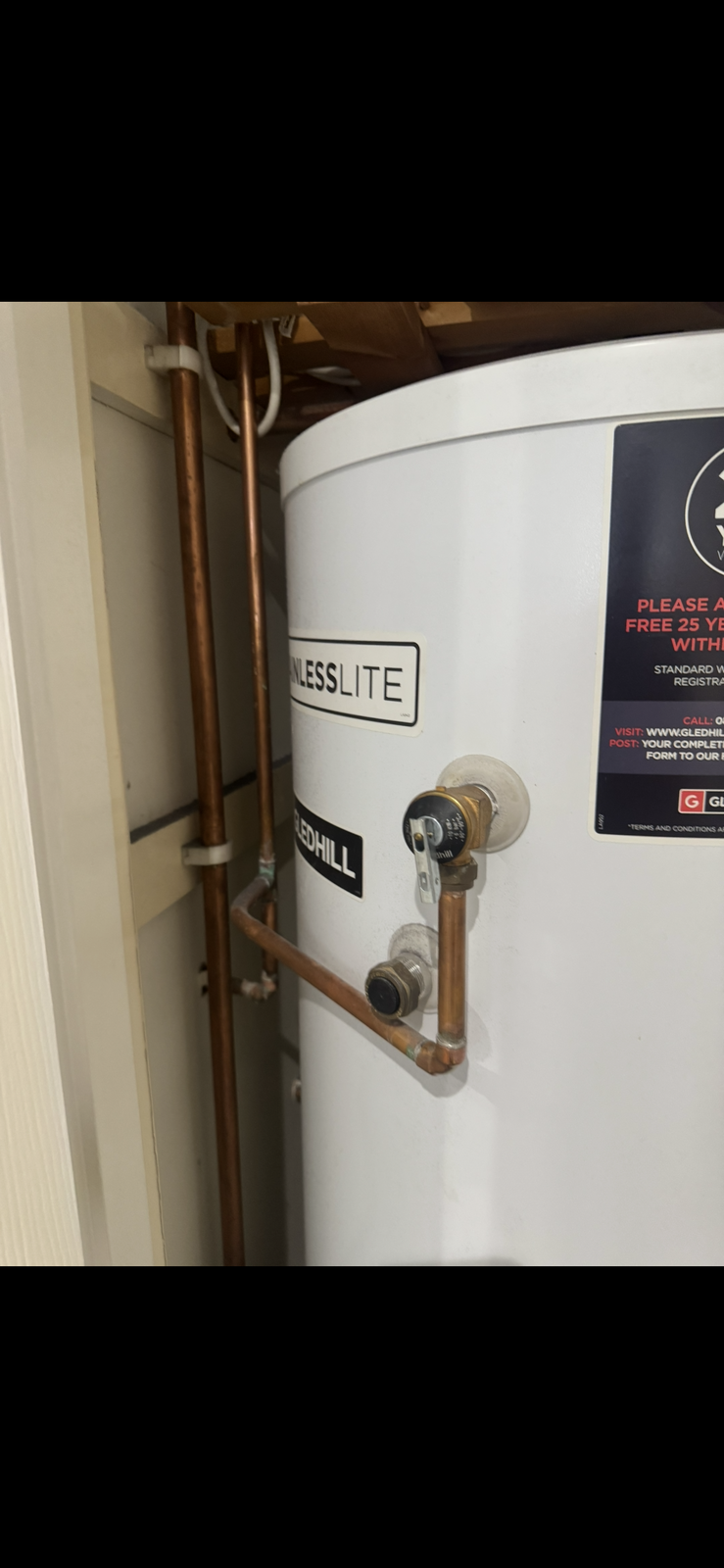

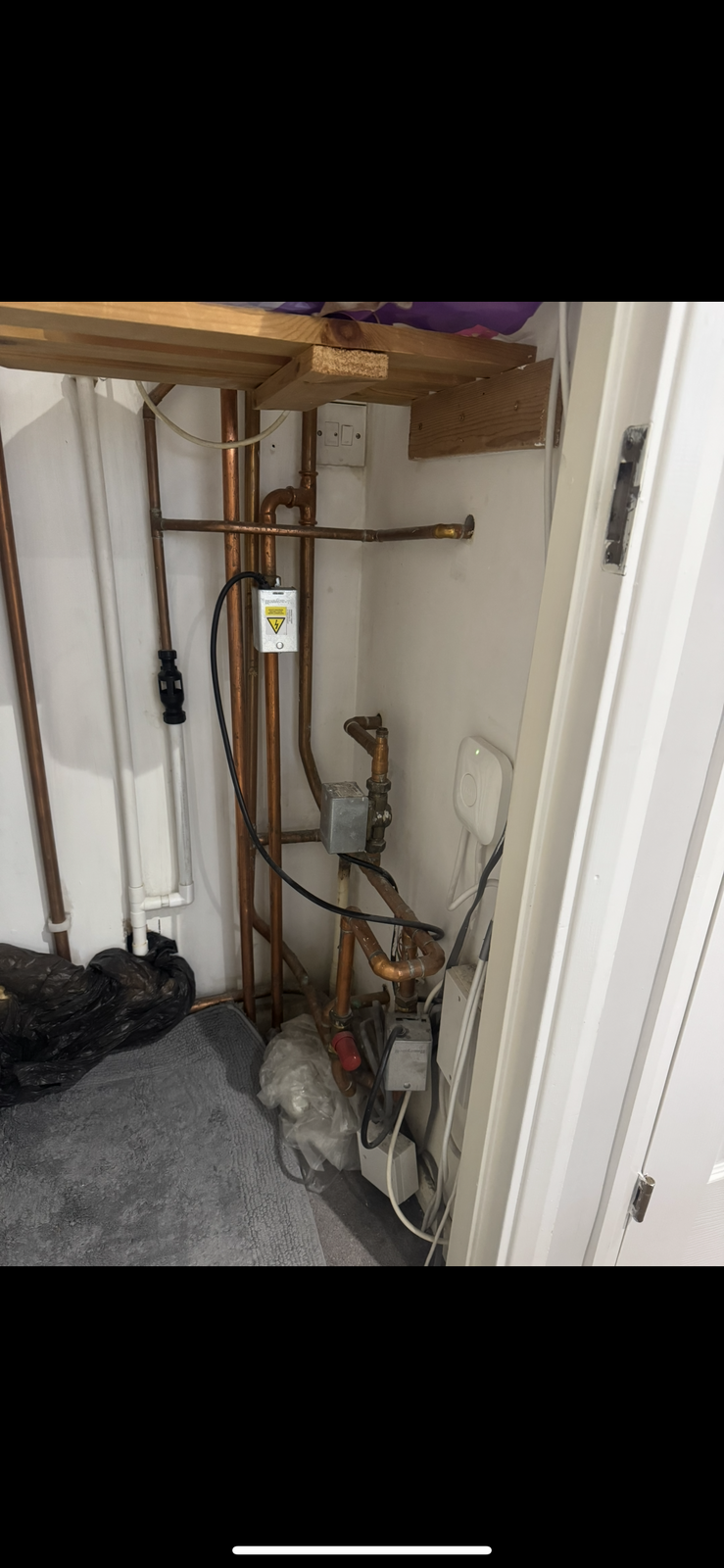

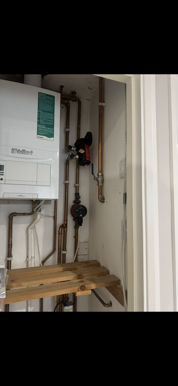

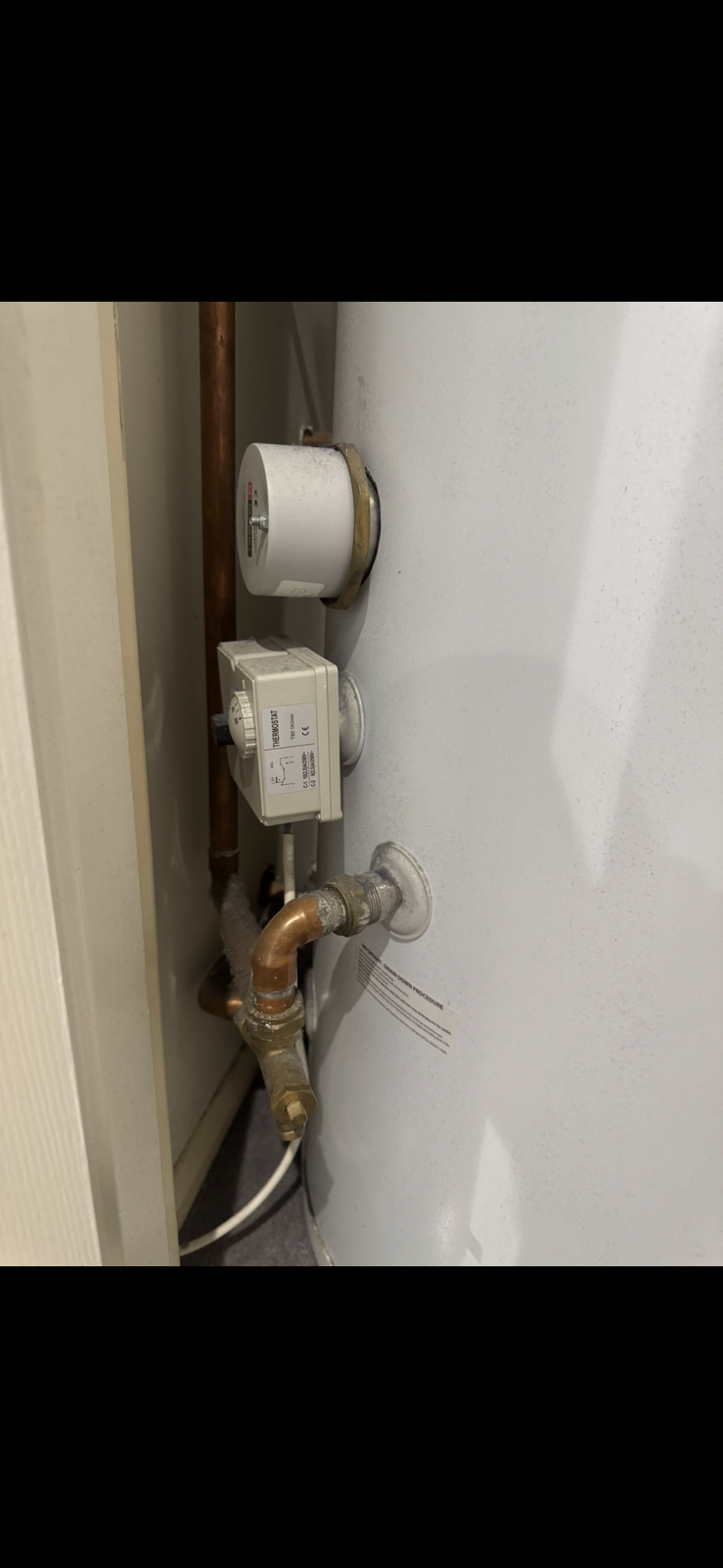

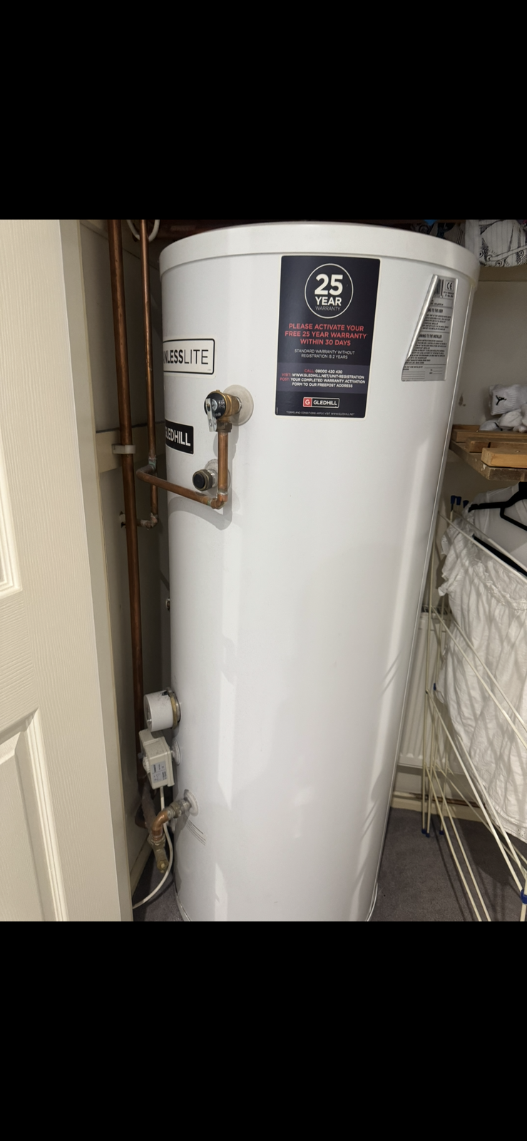

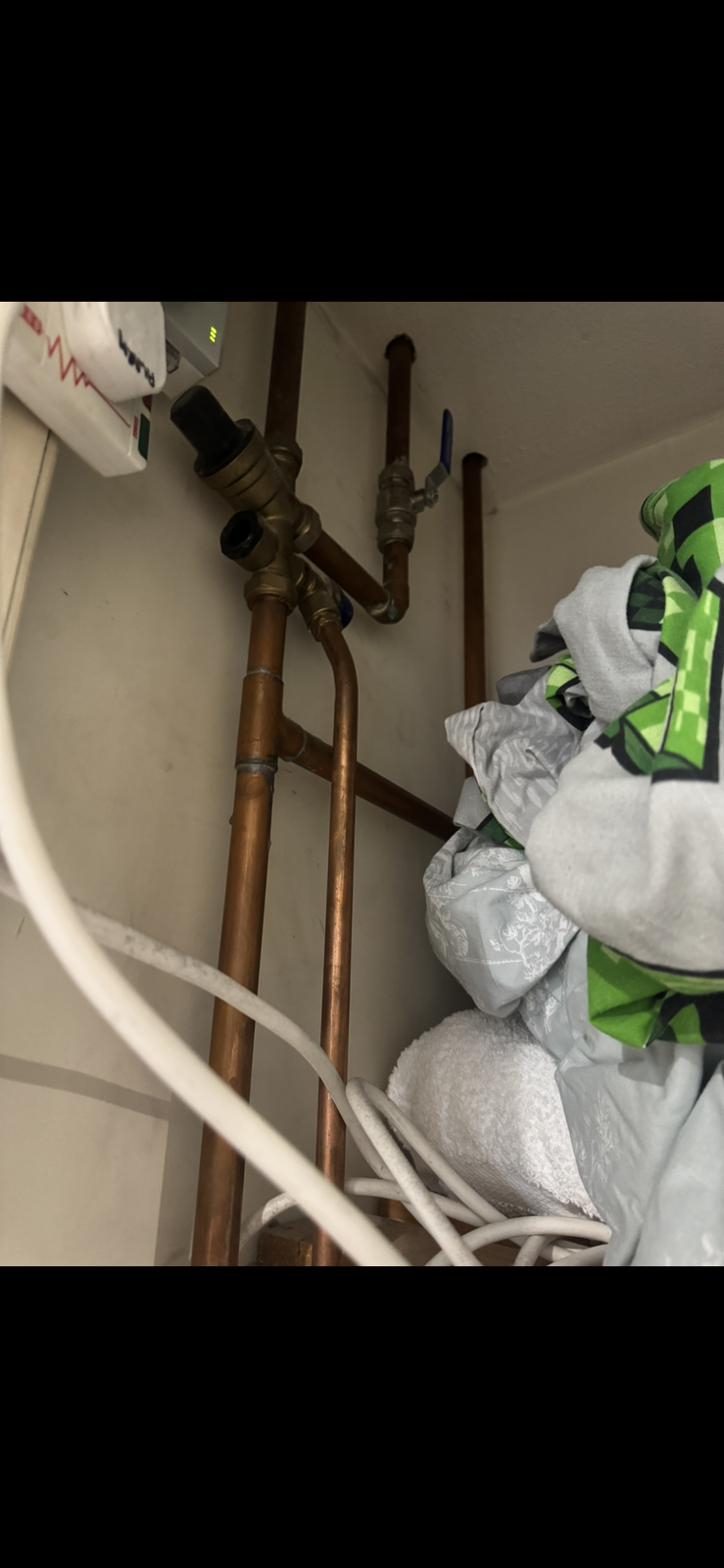

Ok here are some pictures. I also left the house 2 hours ago and checked the water meter. Returned just now and the meter number of needle has no movement. So at least there is no leak.
Pictures as below
1) mains tap in kitchen showing good water flow
2) pipework around boiler with outlets to the water tank in the cupboard next door
3) unvented cylinder and pipework
4) pipework and cylinders in loft
