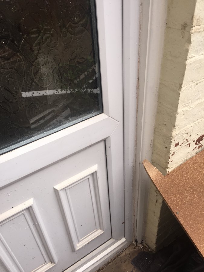

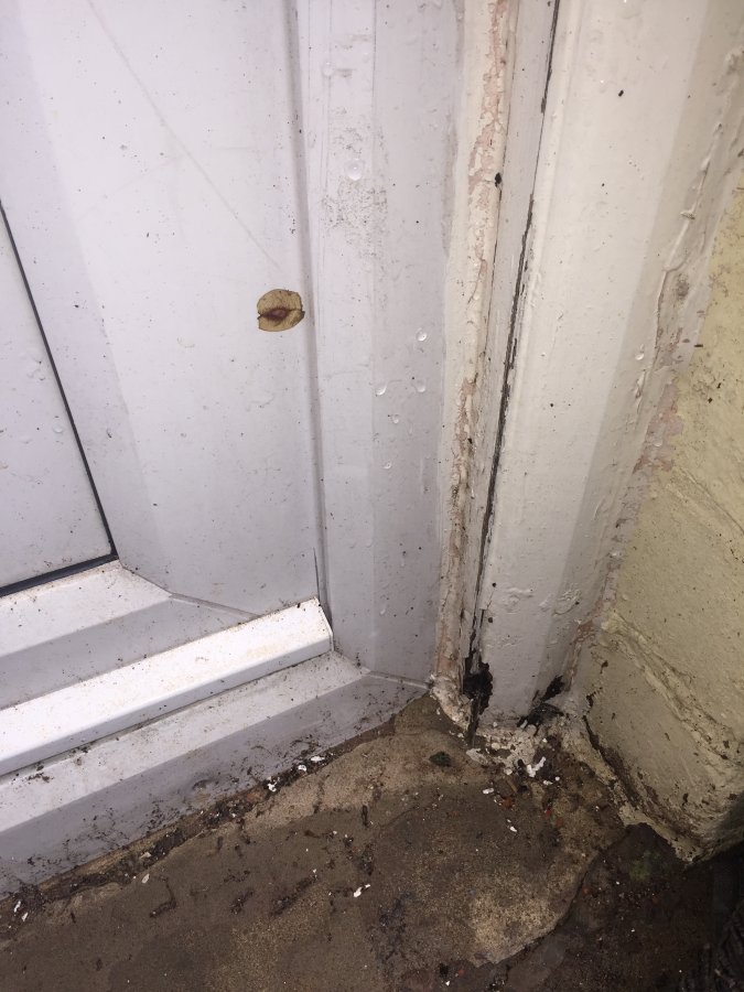

the back door has been fitted to some timber, which I believe was part of the old wooden door frame.
This has become rotten at the base and is allowing water penetration.
(See attached images)
I was going to remove the door and replace this timber with treated CLS, refit the door and clad the the outside with a UPVC strip, lipping it just over the edge of the door frame and sealing it will a bead of silicon.
Is there any solution to making a joint where it hits the ground?
