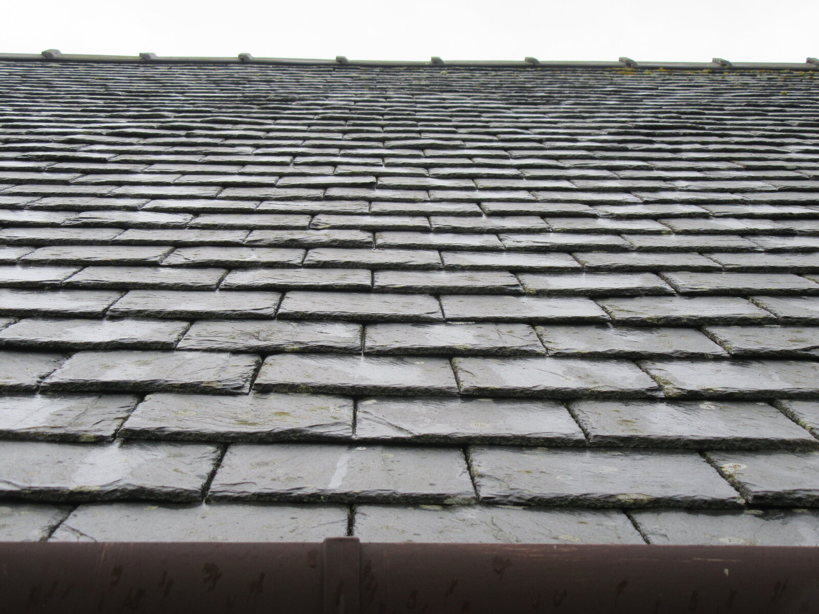

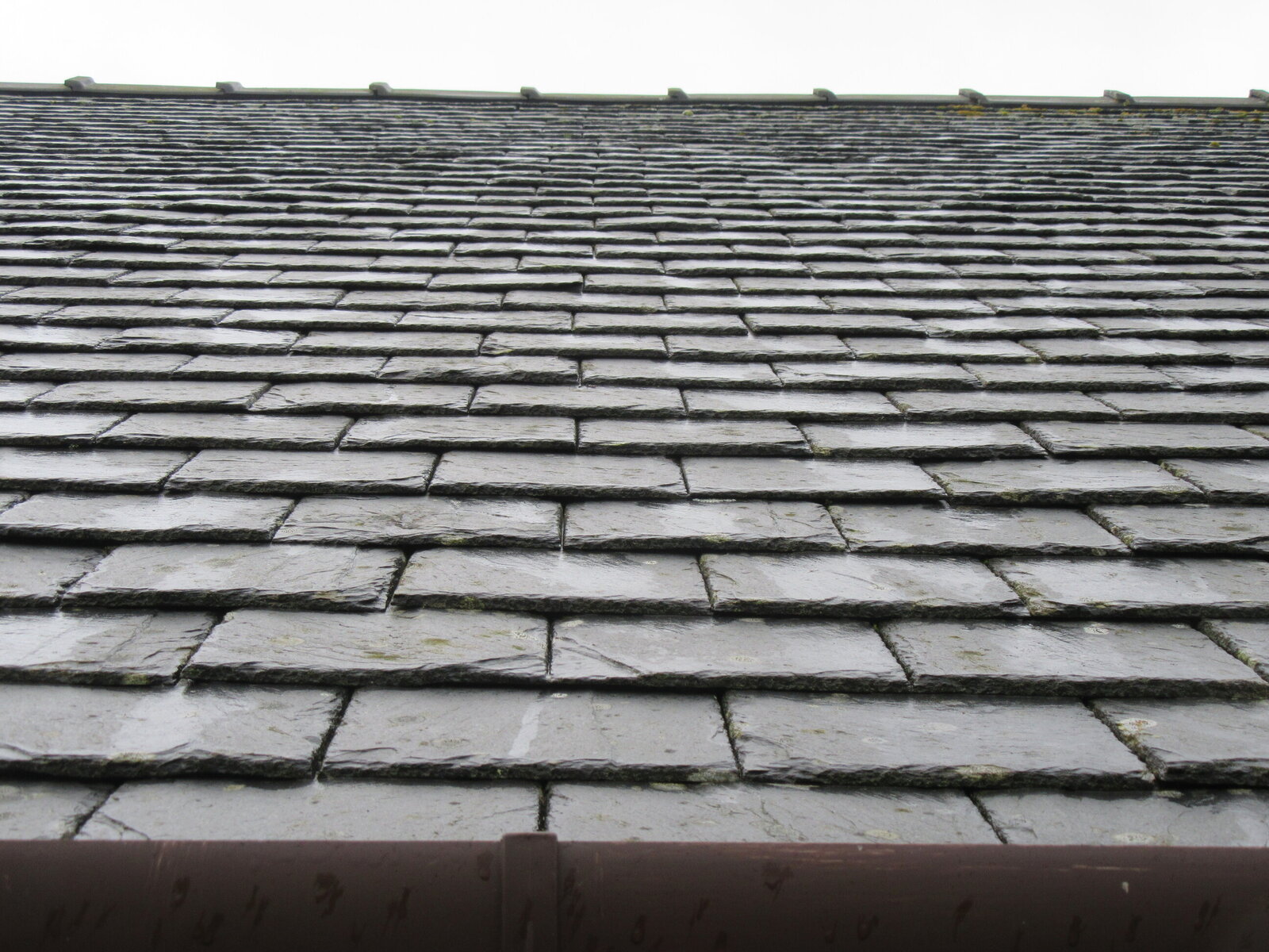

I'll see if I can add a photo of the roof too, the slates are 8 x 16" that's all we know about them. It is a fairly modern house, only 13 years old. Surprising to see so much rot in wood, but then it does rain a lot in Scotland and up this hill it is permanently windy.

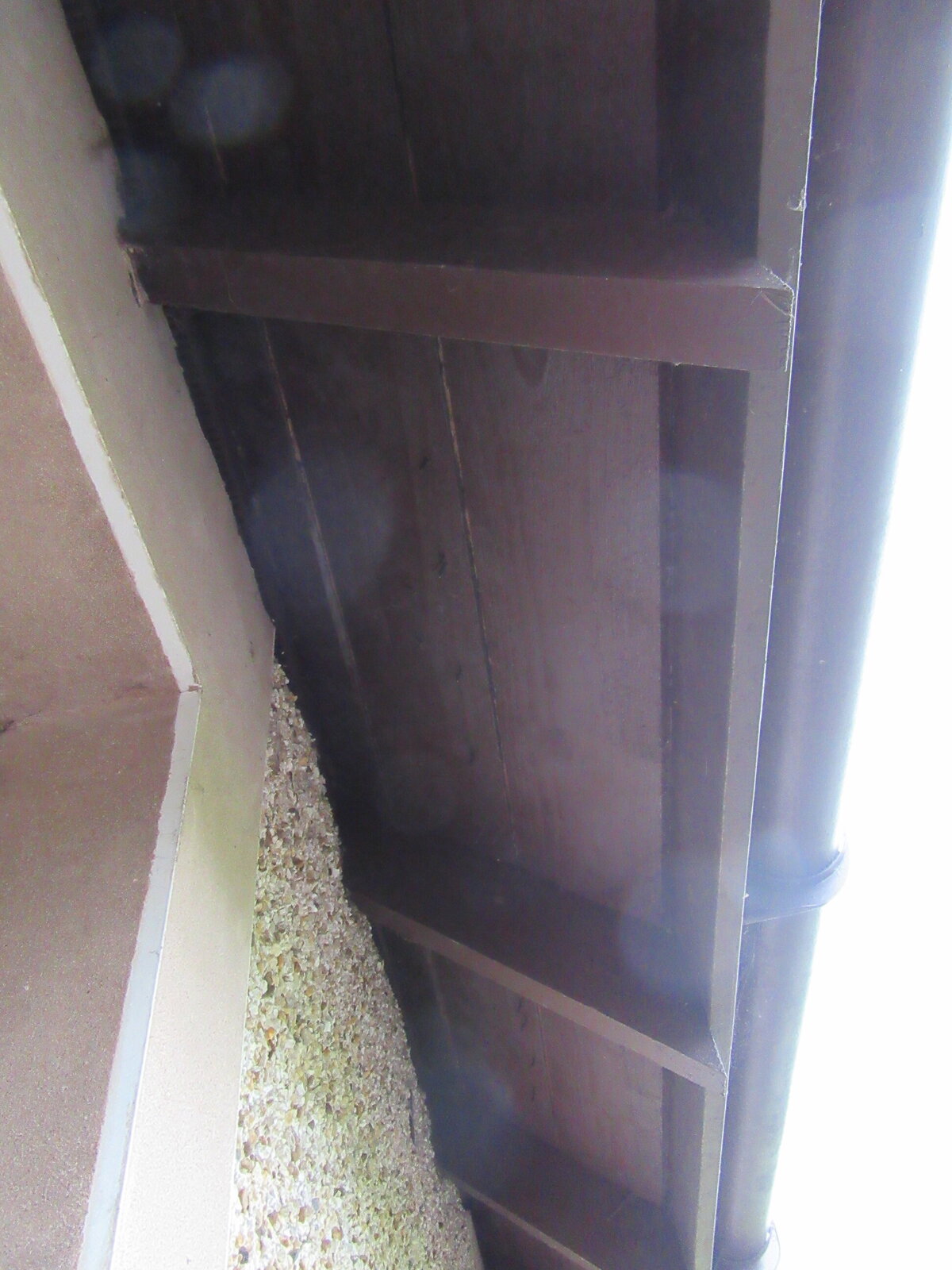

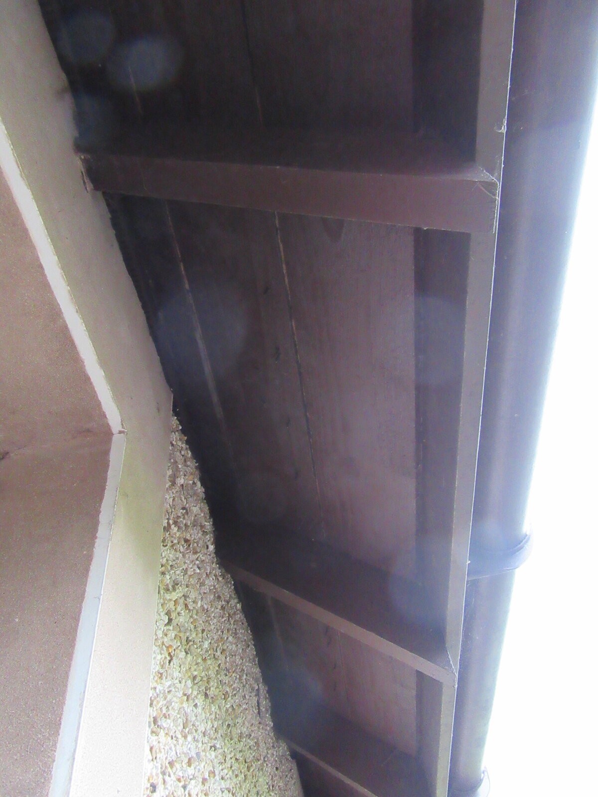

Both the bungalow and garage have high pitched roofs. I added a photo of the slate. The roofline comes down over the windows slightly, the roof line guy said he could cut the ends of the rafters slightly and run the soffit up along the rafters at that angle. It is a slightly different roof to most you typically see.

Looks like Spanish slate, good heavy slate to work with, are the slates nailed straight onto sarking boards? Your quote from the small builder would be quite close if he is renewing the rainwater goods...personally I wouldn't change the character of the roofline by installing soffit boards.
