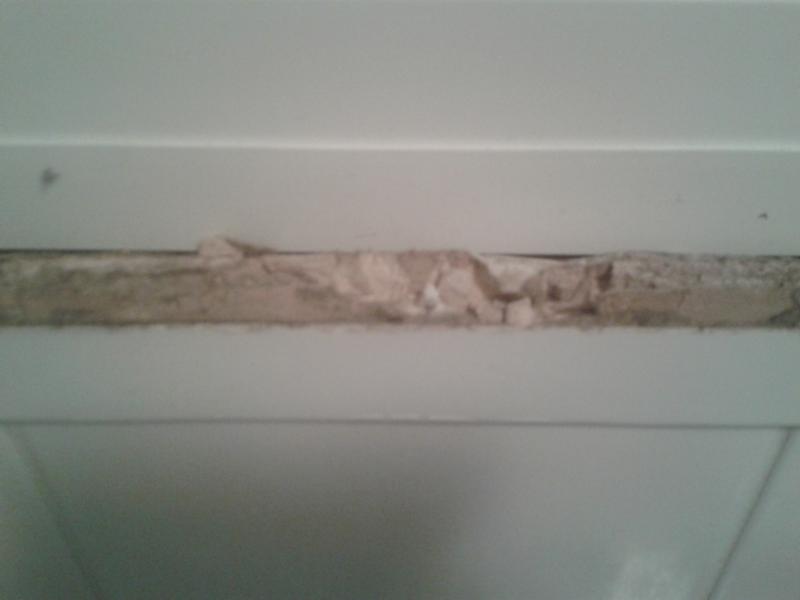

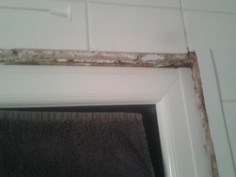

Hi, a builder mate of mine fitted new upvc windows for me. Due to his workload I agreed to fit any trims on the inside of the dorma windows.
The depth to fill is approx 50mm. I've looked at the upvc board that you can fit on top of existing board (the one with a profile like a walking stick) but the minimum depth is 15000mm leaving me with the job of cutting the majority of the depth off to fit.
For the sides I require an quite rigid L shaped profile and I cannot find this anywhere.
Any ideas? Help appreciated! :?
Have a look for your nearest Eurocell outlet and give them a call
http://www.eurocell.co.uk/8/branch-finder-1
There are other company's too but this is who I use.
Window trims come in 5m lengths of:
20mm
30mm
45mm
65mm
90mm
And rigid angles I think are
25 x 25mm
45 x 45mm
90x 90mm
You can get any silicone and stuff you need too. I would recommend cleaning the backs of the trims and what ever you are sticking too with some solvent cleaner first, It will then stick like s*** to a blanket
Good website! I can get the trims locally but was looking for something a bit thicker. The only L shape on the website is 100 x 80. I will contact them to see if they have smaller.
Thanks for the reply
They definetley do the 25 x 25 and the 45 x 45. I have bought some recently.
The 100 x 80 is the largest one they do in 3mm thick but I dought you will need larger than that my the looks of it.
Cheers. I will pay my local branch a visit on Saturday morning
