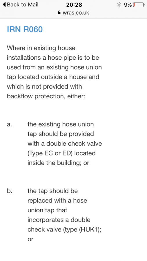

No, you are required to have a double check valve inside the property to comply with water regs
To be pedantic it doesn't actually say that in the Water Regs. Some of the guidance from the Water Suppliers does, like the one you quoted from Southern Water, but some others say a check valve on the tap is ok.
In practice Jon, I agree with your post above, but to be fair, the WRAS website states the following...
And while I agree with that sentiment we aren't talking about an existing installation. This is to be a new install to the front of the house.

I would say that the hose Union bib tap with the integral check valve is perfectly suitable for what you are doing. You are making the effort to comply and the thought police are not going to be calling on you any time soon :D
