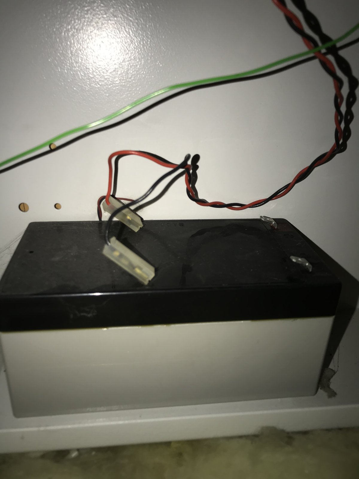

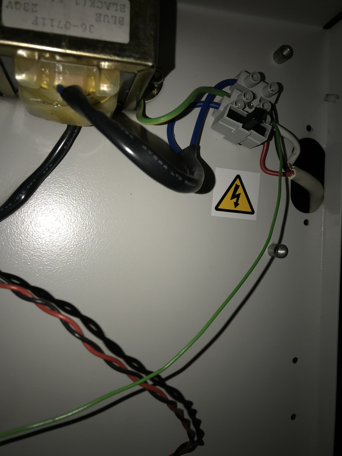

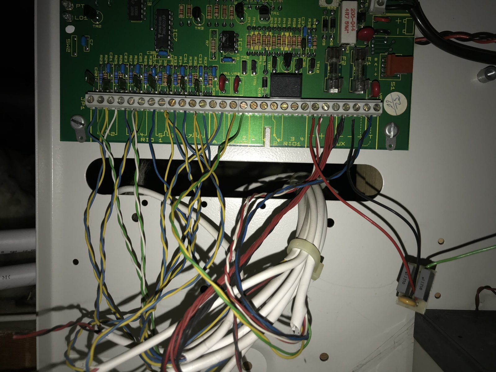

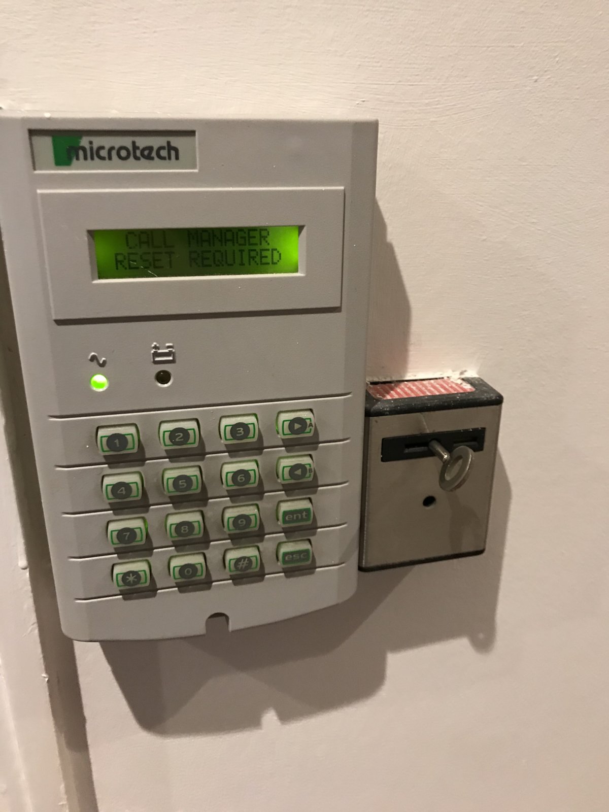

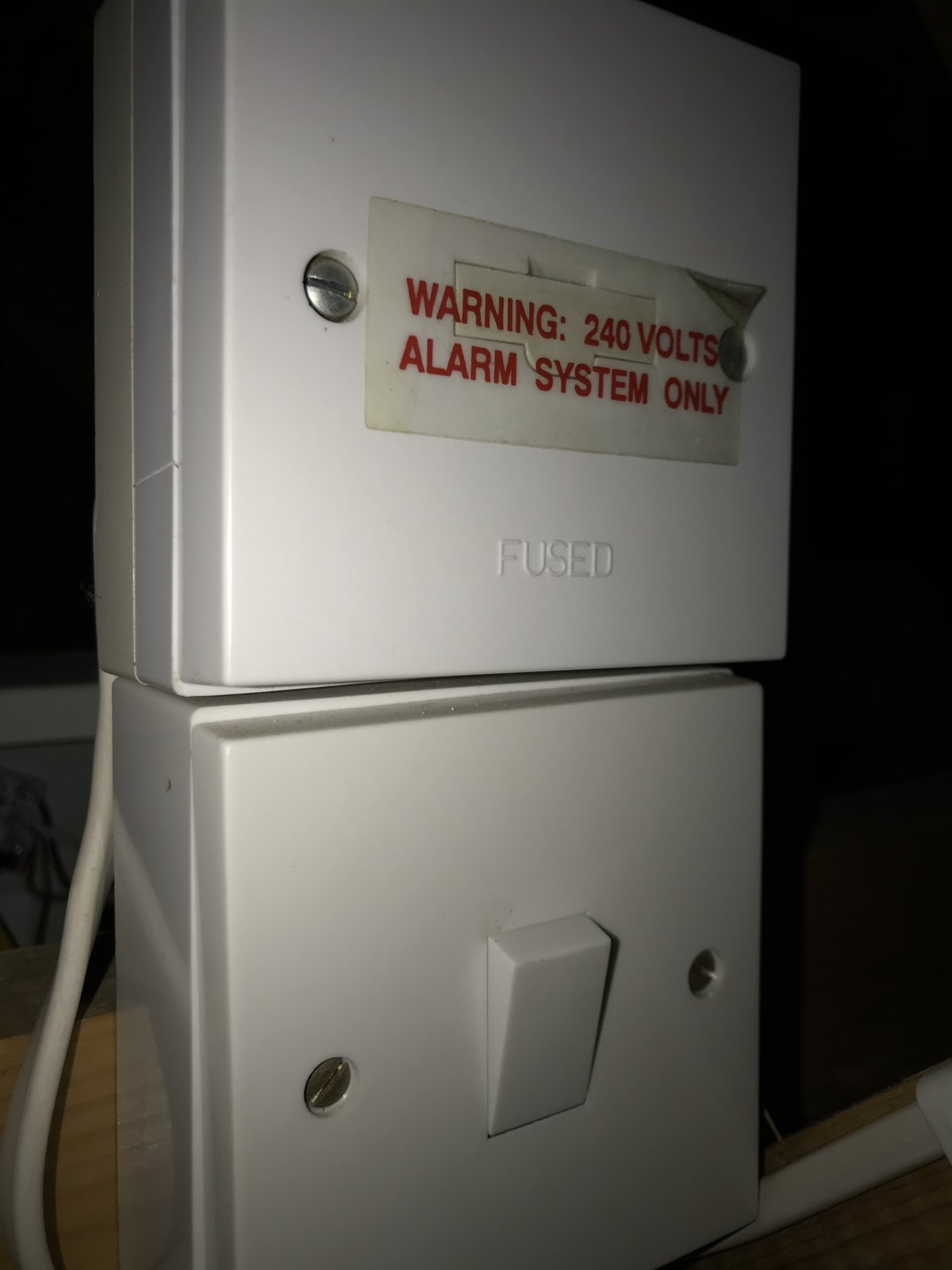

Hi we have recently moved in a new house and there is a Galaxy alarm from 1994 fitted. The problem is I need to change some light fittings but when I turn the fuse box off the bell goes off. So I have removed the battery from the main board but it still goes off.
Any ideas would be a great help

That “battery” you have removed keeps the system running in a power cut ....so it needs replacing ....or a set of ladders to disconnect the battery in the bell box
Thanks for the reply any other way instead of a big ladder can I remove any wires from the main control panel?
Looks like big ladders then does the cover come off easy ? and do I just disconnect the battery?
Should I turn the mains off first.
Thanks for the help.
A...don’t know as you haven’t posted any pictures of the bell box
B...as above
C .. either way
Thanks for your help if I replace the battery in the main box in the loft and don’t touch the bell will that work?
Just to update change the battery in the main control box and alarm now works fine.
Thanks for the help
