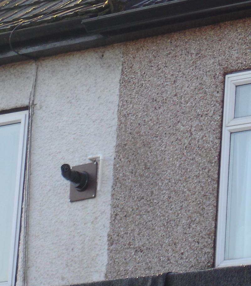

URGENT-Is the boiler flu too close.
Unfortunatly trundles it is mis-leading infomation like what you appear to have supplied above that creates the problems made from the OP.
Had he not have had a window there this installation would have been signed off as all well and good even though the window belonging to the neighbour to the left of the flue is far closer.
I must admit i don't agree with pointing the plume across the boundary which has now probably made it closer than 300mm but 800mm is far enough away from the window IMO to be considered reasonable.
Had this boiler been fitted for the OP and 800mm away from his own window i'm sure the benefit of a new boiler in what i can only presume is a convienient and agreed position internally, would have outweighed a slight inconvienience of having to keep the window closed a little more in the winter or maybe the odd puff of steam floating by in the summer when a hot tap is run.
It would appear that the OP has taken all of the negative 'evidence' (including some fiction) from this post whilst dis-regarding most of the sensible fact's in order to kick up stink when the installer/inspection takes place.
I hope there is an easy outcome for both the installer and OP to be honest.

In my experience 90% of the boilers I come accross have the correct co2 or are very, very close to it and only require a minor tweak.
Anyway, back to the original question.
The following two statements are from the Ideal installation insructions.
"FLUE INSTALLATION Pluming will occur at the terminal so terminal positions which would cause a nuisance should be avoided.
The flue must be installed in accordance with the
recommendations of BS.5440-1:2000. In IE refer to I.S.813:2002.
The following notes are intended for general guidance."
and
"IMPORTANT.It is absolutely ESSENTIAL to ensure, in practice, that products of combustion discharging from the terminal cannot re-enter the
building or any other adjacent building through ventilators,
windows, doors, other sources of natural air infiltration, or forced
ventilation / air conditioning."
As I said earlier get your neighbour to ring Warm and a plume kit will be fitted.
