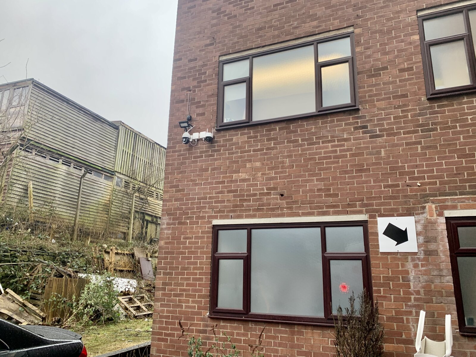

There is a fused spur that feeds the front security light of our property.
I want to add a second security light to the side of the property and can either feed it from the wiska box where the first security light is fed from or using a separate fused spur that already exists inside the property next to the first fused spur.
Inside, the second fused spur is fed from the first one and the previous owners have just left a redundant cable hanging on the outside.
what would you do? Remove completely the second fused spur and feed both lights from same wiska box or keep them on separate fused spurs ? I can also upgrade both spurs to RCBOs.
