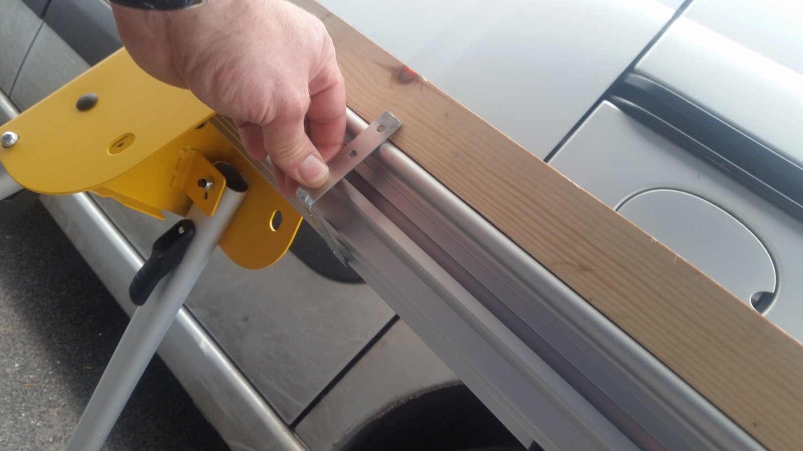

Use this mitre saw as a saw horse?
Thought you'd asked this one before, but yes, if you remove the end extensions then that will function as a saw horse in the same way that a DE7035 does - they are almost identical and share the same legs, top section, etc

Would this work as a saw horse as well as Mitre saw? Would have to attach wood using gaffer tape as can't really screw the bottom

i made a wooden platform that clicks on to allow the use off a second saw without transferring the rather expensive clamps that come with it
i made it sit under the outside lips rather than the inner groove to give a greater area off grip in case off load on the front edge
now mines is well made and the full bed off the saw is over the stand but i will only load the saw at the back on the fence as i dont trust my £500 battery slider on the grip off the screws :D
would i trust it as general work surface well not really as its too high to work comfortably with large bits off material
as said 2 saw horses and 2 bits off 4x2" works a treat

it may work well if you use the official clamps and attach a board but to be off any real use would have a fair bit off overhang and require some additional support to stop sag
I guess just pull arms out and remove them. They add a lot of weight. But how would I attach wood to the top? U cant screw through because the two tubes underneath get in way. Gaffer tape?
My own (the plain trestles) have 4 x 2s screwed from beneath. As you say the chop saw stand version has the tubes, but could you not fit a timber capping using something like repair plates at the sides?
I got the mitre saw to use as a sawhorse as well. Cant take tubes out mind. How l attach the wood on top. Longer repair plates than the ones in picture ?
