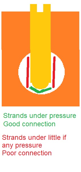

Ferrules also increase the contact area between the copper and the terminal by stopping the copper from spreading so much under the pressure of the clamp.
That presumably depends to at least some extent on the nature of the clamp and the degree of squashing of the strands that occur -since I imagine that, under some circumstances, "the copper spreading" might actually increase the contact area (so that 'stopping the spreading' might actually reduce contact area)?

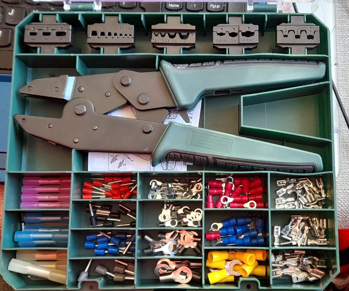

I have a lovely set of crimp pliers with exchangeable jaws. But for them to work, you need to use the right crimp with the right jaw, Crimp plyers.jpg they look good, but I have found wrong crimp or jaw used, so maybe on average better not to use pin crimps?
I should have been more specific and said that the ferrule stops the strands from spreading, rather than the copper.
Fair enough, but is it not the case that, in some cases, the spreading of strands will facilitate the spreading of copper within those strands (with a consequent potential increase in contact area)?
