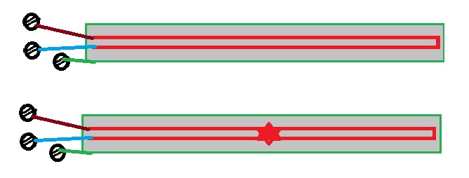

But for other readers.... Some heating elements are bifilar and insulation failure can create an over current fault without the Earthed casing being involved.
As often discussed, that is the one sort of scenario in which something like a heating element can theoretically result in a 'non-negligible-impedance' L-N fault (i.e. an 'overload', rather than 'fault', current), without involving anything earthed. However, I suspect that is an incredibly rare occurrence.
