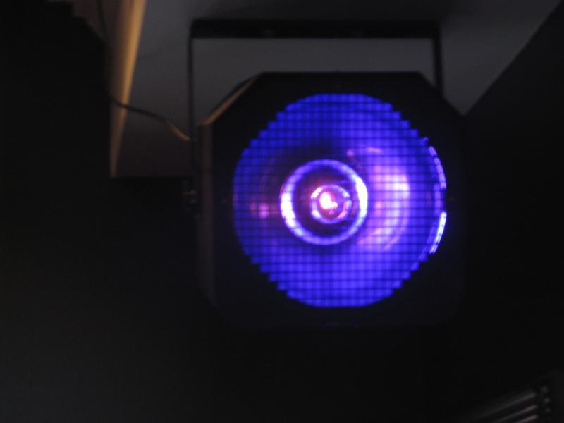

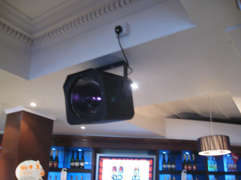

We wire these up in pubs, for there U/V party nights
400watt each!
Yes but its not the power , its the wavelength. If you compare the bacteria killing pond lights with the disco tubes, you will see there a different colour,
Ultraviolet A, long wave, or black light has an energy of 3.10–3.94 eV per Photon. (eV=Electron Volts)
Ultraviolet B or medium wave is 3.94–4.43 eV per photon
Ultraviolet C, short wave, or germicidal has 4.43–12.4 eV per photon.
The pond light is UV-C, Disco lights are UV-A. Pond lights are more than four times as energetic. It gets worse in space, the other side of the ozone layer - the stuff from stars, and the sun can reach 10.2–124 eV per photon, seriously dangerous, would fry you in minutes if you were exposed naked.

No, if you actually read my post you see they are the wrong wavelength to do you any harm, because the eV per photon is too low. You think the Elf'n'Safety Nazis would let you put up dangerous lighting in a Disco? ?

Still done some last year, they tend to go for smaller LED panels now which do similar.
As for the place where they took them out, you need to turn the main lights down for the effect or there pointless,sometimes if the site has drug problems then they tend to have to improve lighting.
Was actually fitting them ones when you posted about them last year.
//www.diynot.com/forums/viewtopic.php?p=1314759#1314759
Yates tend to like them, for there U/ V nights where you paint up and dance like a spaz on U-tube.
I wondered about them being safe, never realised about the wavelength.
