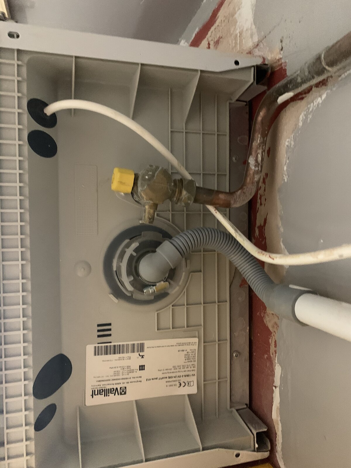

Ok so if it’s a system boiler, you will have a pressure gauge and a filling loop. Has the loop been left open? And what is the current pressure. Are the flow and return valves open? Could be a fault on a motorised valve. A picture often tells a 1000 words. If it’s open vented refer to post number 5.
I can’t see a filling loop, the underneath of the boiler looks like this (see picture).

You've got a heat only boiler ( a system boiler would contain a pump, expansion vessel, pressure sensor, pressure relief valve etc).
Have a look in the airing cupboard near the cylinder...you might find the pump, zone valves, pressure gauge and filling loop (if it's a sealed system).
Post pics...
Ok with the hive off, you’re getting a demand from elsewhere. You may have a stuck motorised valve or a link left in the boiler (which can be quite common), but please do not remove the cover to find this out. What pipes do you have coming from the top of the boiler? Do you know what the pressure is if it has a gauge?
