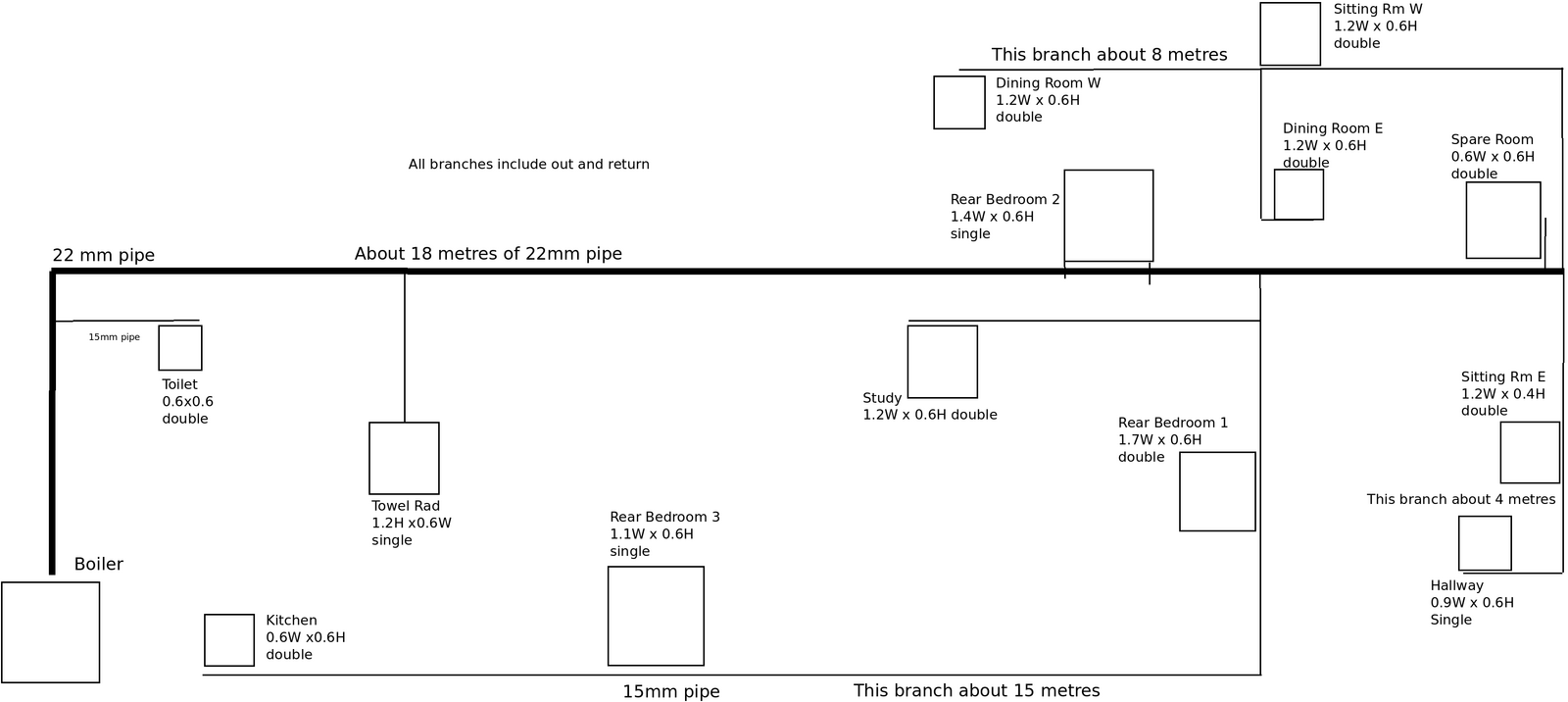

How may rads on your system? any UFH?
Well I had enough of the system misbehaving, so as the diverter valve was the only bit that got changed, I took it out for a good look at it and found a bit of scale had dislodged from somewhere else in the system. It was a large curved bit that got stuck in the passage where the brass screw protrudes, to me that is an indicator that the system needs a good clean for a bit.
Any recommendations for a system cleaner I should circulate round for a bit?
Fraid not, have no experience with chemical cleaning but if your magnetic filter doesn't also have a particulate filter then suggest installing one that has. These boilers have a internal bypass so maybe removing this to have a look for any bits of scale, these come set to 2.5M which I think is far too low for most CH systems but can be adjusted to a max of 3.5M, see page 24.

Not yet, I went out to get some cleaner from toolstation this afternoon. The diverter valve was fully cleaned before I put it into the system, so the scale has come from other pipework, I suspect the bit I found would not by itself have caused this problem, but it does tell me scale has built up elsewhere. So I will circulate some cleaner around the pipes for a bit and see if it starts behaving.

It is still at the stage of blocking up then pumping properly again, so it needs some more hours. I may add some citric acid if it is still misbehaving in the morning. I added a whole bottle that says enough for 16 rads, and I only have 12.
The system has had a power flush, but the boiler is still bad, there are knocks and bangs while it is running now.
Currently been drained and a whole bottle of adey cleaner added, still not any better.
I have set the pump to run at 100% and not modulate until the system is able to not keep kicking back to timeout after an S.7 event. I have also set the pump to 12Kw for now to try and give it more of a chance to not end up at S.7, but not sure if the 80% at startup is actually changed when you edit that setting?
