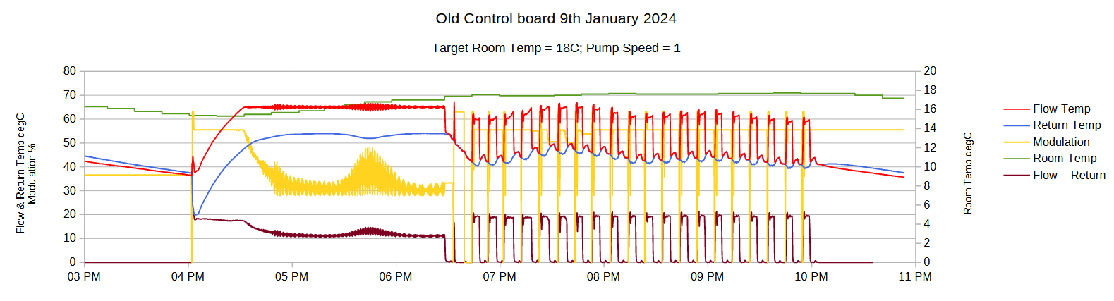

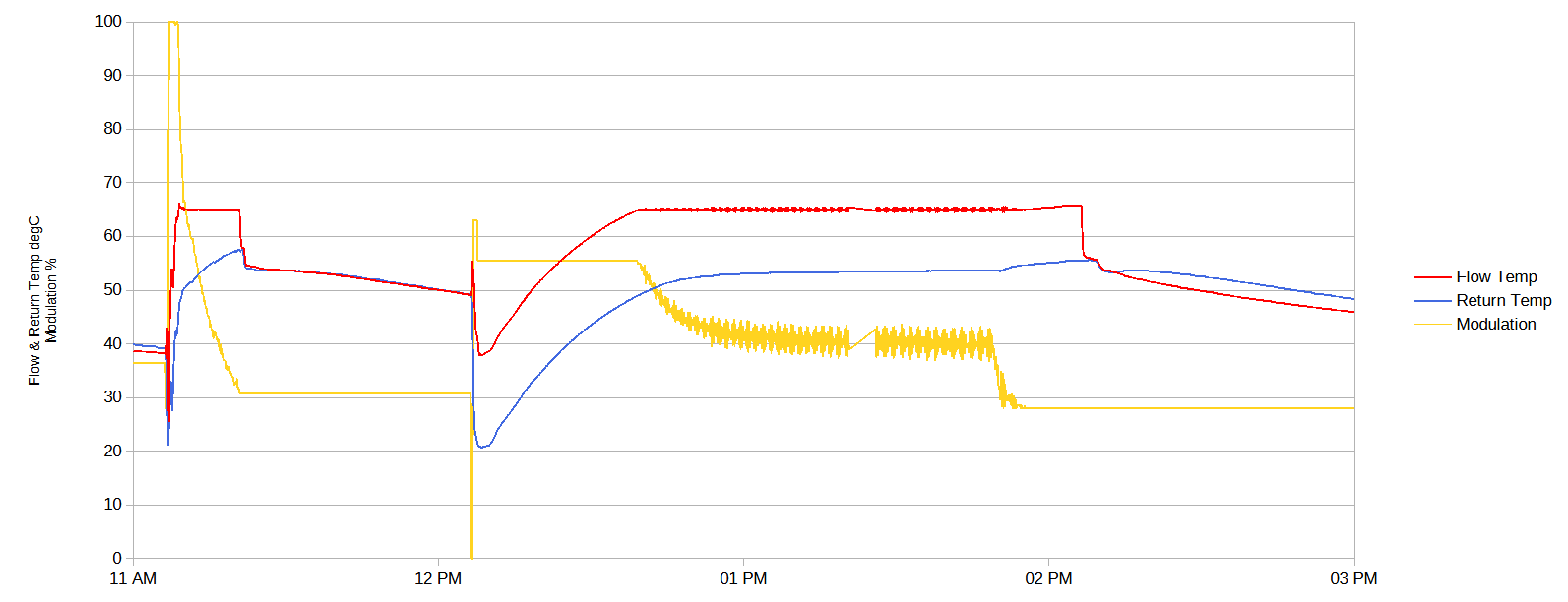

Regular visitors to this forum will know that I have an unhealthy obsession with monitoring my boiler's ebus. I noticed recently that the modulation during the CH on periods has a weird instability that has been getting gradually worse. The boiler is 13 years old and recently had new flow and return NTC sensors fitted. Any guesses as to what may be causing this? Control board? The graph shows HW period followed by CH period.

This problem only appeared a few months ago, prior to that the modulation was clean. I wondered if a component was failing on the control board.

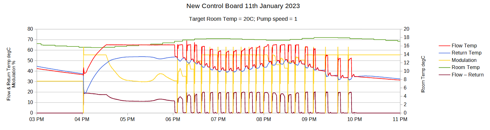

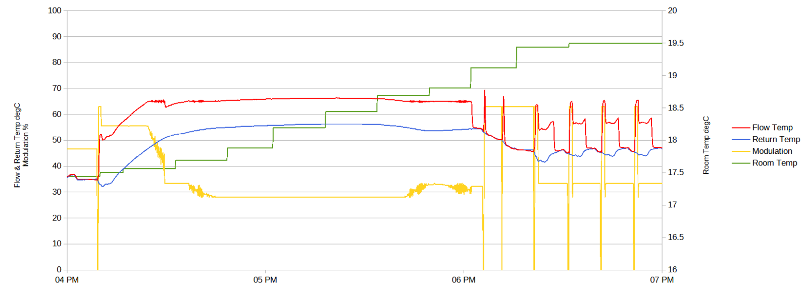

I was right about the control board. I had it replaced and it fixed the problem. Not surprising really as it was 13 years old.

That's good to hear but why is your room temperature only reaching 18.0C max, with a target room temperature of 20C?.
Put the 350F on analogue (room modulation), turn the pump up to 2, change D.1 pump over-run to 10mins, and you‘ll get much better and longer burn times instead of all that cycling. You can also drop the maximum flow temperature to prevent over shoot too in D.71.
I've always struggled with the boiler settings so thank you for that advice.
Regarding the pump speed, I reduced it to increase the temperature differential between flow and return. My heating engineer said it was fine on 1 and the house warms up just the same as it did on 2.
I've now switched back to the vrc470f weather controller to see how that works.

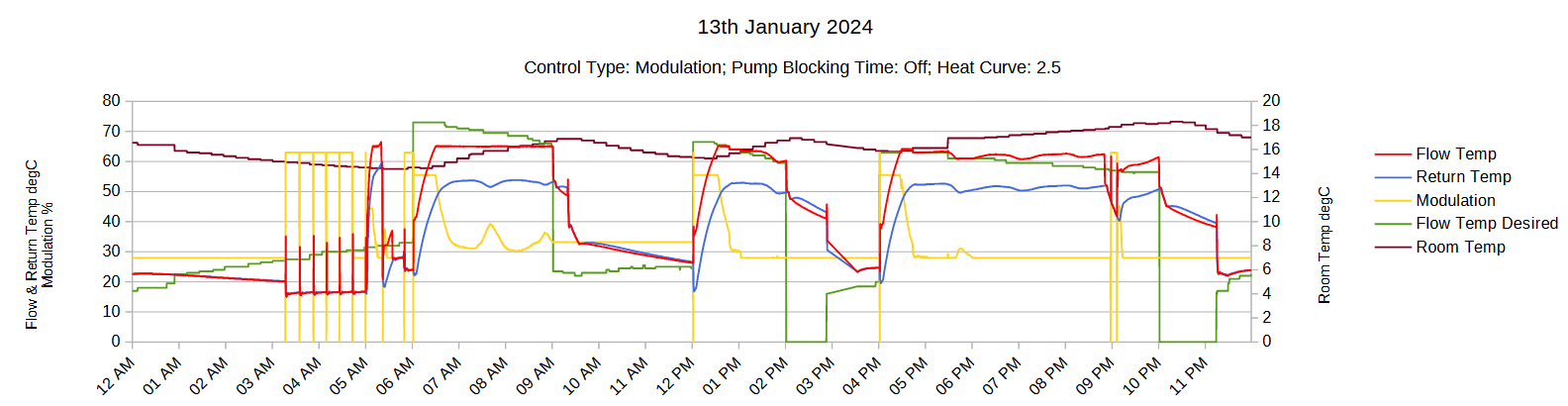

Could you advise me on another mystery please, this time with the VRC470F weather controller. It gives longer burn times but the boiler fires up every 17 minutes before the HW cycle comes on at 5am. Any idea why?
