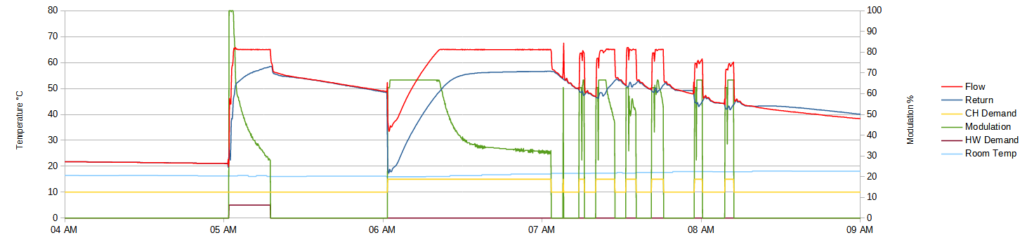

I have an ecoTec 418 boiler with VR65 controller, VRT392f thermostat and a conventional 42x18 HW cylinder.
I have set the CH part load to 12kW and it keeps the house nice and warm. The HW part load is at the default value of 18kW. Is there any advantage to reducing this, i.e will it save money? Here's a graph of how it's all working at the moment. 66% modulation = 12kW.

If the boilers heating the water ok and the burners not cycling on and off during hot water reheat then I would leave it as is. Some conventional older cylinders had coils that could only transfer a low power (say 4kW) so when the boiler would heat them it would cycle on and off a lot, which is wasteful and adds stress to the boiler, so in that case I'd range it down until it can heat on a continuous run. But if its already doing it ok then I'd leave as it is.

Data is just noise if it does not provide an answer to a question or can be used to make autonomous decisions....if its manual intervention that is required after looking at something then its not automation..great graph..what's the point?
So I see a boiler being switched on/off yet the room temp remaining constant irrespective of flow temp. That's not right.
What is the time frame and method for collecting room temp data?
Where is the gas consumption data? Don't you need that to calculate operational efficiency as a £ value?

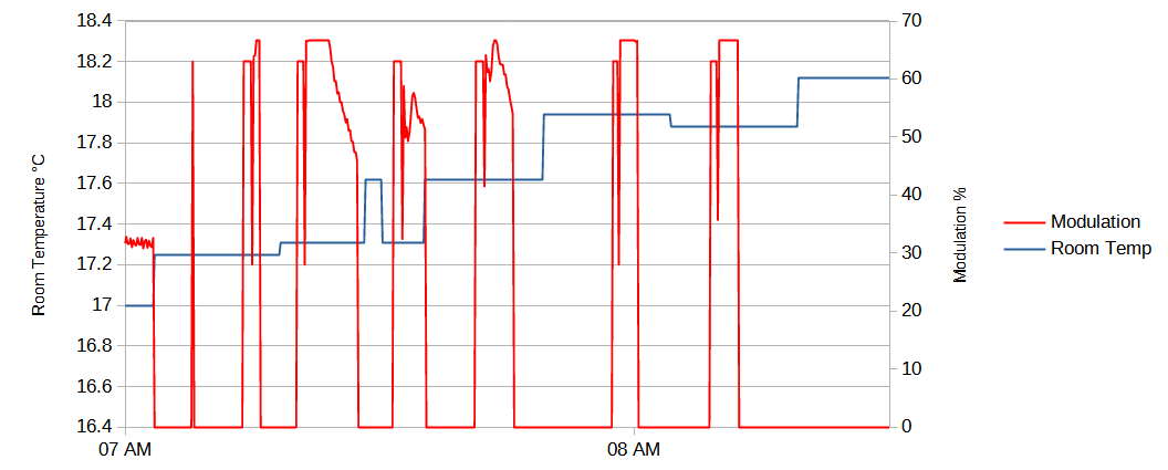

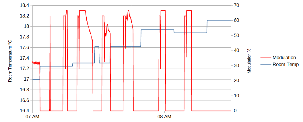

The room temperature is collected from the VRT392f every 10 seconds. Here is an expanded graph of the central heating operation:
The room thermostat is set for 18degC so it seems obvious to me that the boiler will keep supplying heat until that temperature is reached.
Mike

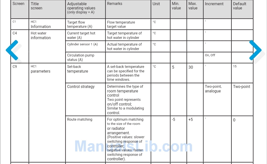

Looks like it's set to on/off control (two point)
Rather than modulation control (analouge)
Could be worth looking in the room stats installer level and changing it from two point to analogue.
This let's the boiler use lower flow temperatures and condense more, and can reduce the number of ignition and off cycles.
Thanks for that. You're right it was set to two point (default). I have changed it to analogue and will be interested to see what difference it makes.
Mike

So in order to raise your room temp by 1 degree, I see that it took 1 hour to do this and I can see that the boiler kicked in/out 6 times, with burn times much longer that pump run times (just circulating the water).
how much gas did you consume doing it this way? What was the outside temp? a staring point of 17 degree is not cold by any stretch...

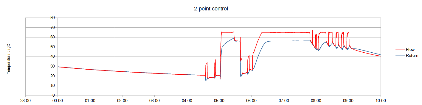

I have a comparison between the two modes for the period midnight to 10am. The HW is timed to come on from 5am to 6am and the CH from 6am to 9am. Here is the plot for 2-point control. The heating comes on briefly before 5am when the temperature drops to the set-back of 15C:

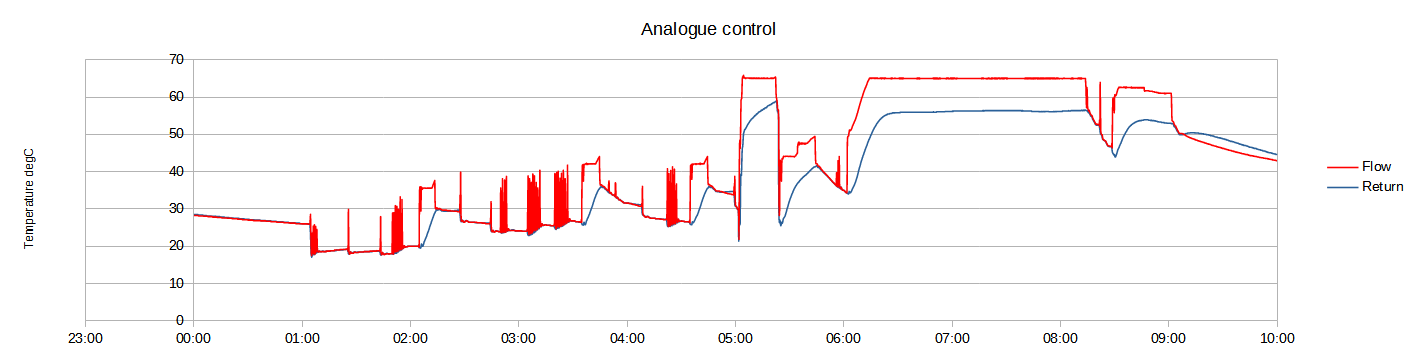

Here is the plot for analogue control. Although the overnight temperature stayed above 15C the heating come on throughout the night. I haven't started to measure gas consumption yet but it looks like this mode is prioritising comfort over economy? All that firing can't be good for the boiler.
