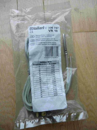

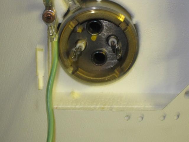

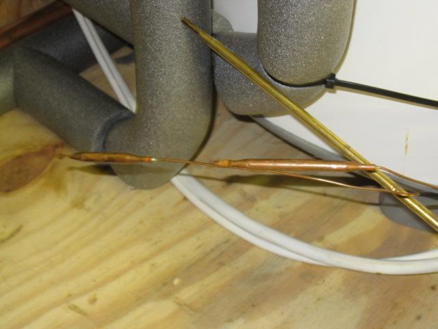

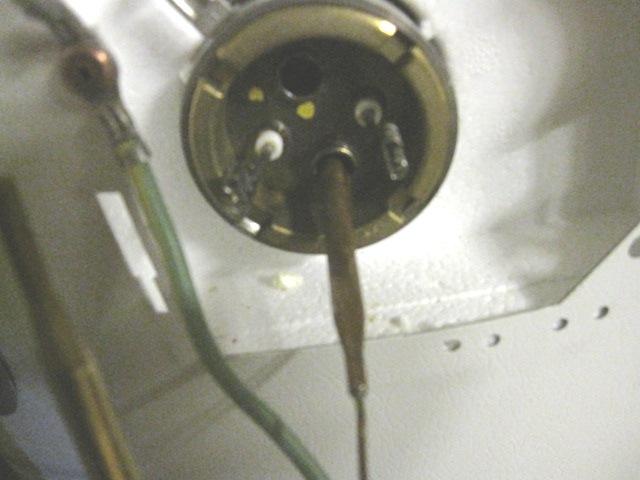

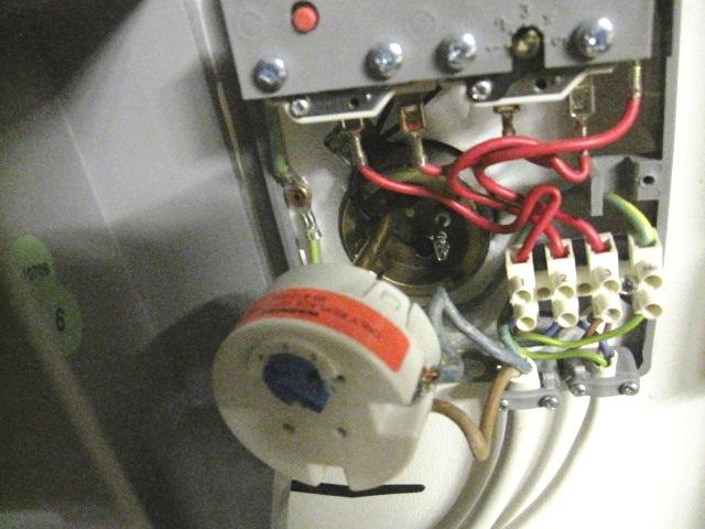

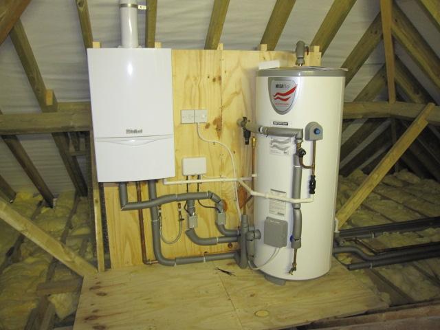

I was a bit worried about fitting the VR 10 into the megaflo so had good look at it today and can see it should be pretty straightforward, took a few
pics too.

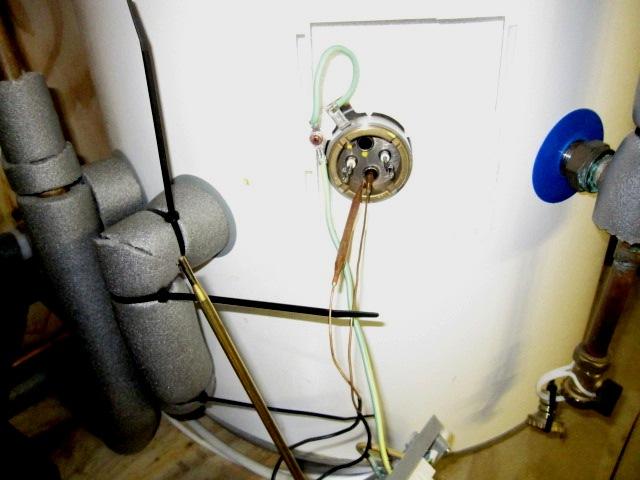

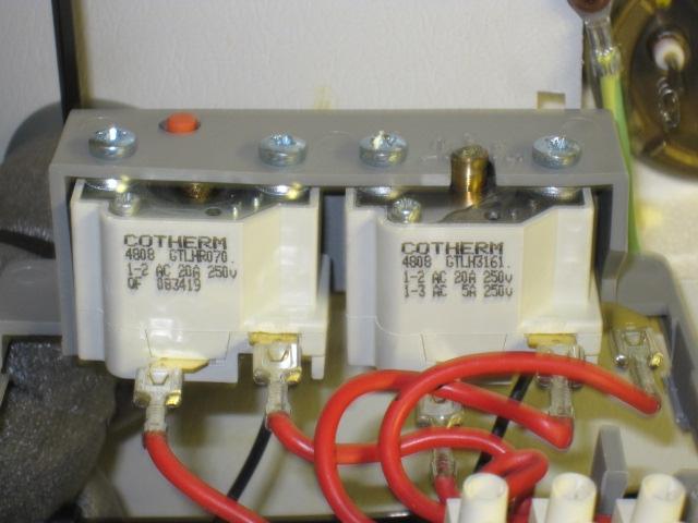

So the relays, or temperature switches in my world of process control, are capilliary type. There are two separate relays. One for the water temperature setting and the other is the overheat trip with manual reset, currently wired in series.
I see there are two trains of thought (at least) for wiring in the overheat relay when employing the VR 10.
1. Wire it in series with the DHW 2 port valve actuator control from the VR65. This would rely on the spring return closing the valve which may decide to jam open. The valve position switch is not wired and there is no utilisation for monitoring valve position or interlocking with the boiler (similarly with the CH valve).
or 2. Wire in series with the boiler 230v supply to definitely chop the system which seems preferable to me.
Remember that the pump is (should be) wired directly to the boiler, cutting the boiler 230v will prevent the pump overun occuring which in turn could cause damage to the boilers heat exchanger.
I have a 'normal' DHW cylinder; as the VR10 was designed for the Vaillant cylinder, I choose to leave in the existing cylinder stat as a fallback 'safety measure' when I updgraded my controls. Here's how I wired mine:
The pump is located and wired within the boiler. I realised there would be no overrun, same as a power failure I suppose.
The overheat trip is at about 90-95C on the megaflo, I believe, which would mean something pretty serious is occurring so what action to take, shut the valve or stop the boiler.
it is perfectly acceptable to rely on the boiler over heat stat to protect the cylinder...Modern condensing boilers just wont over heat......
I kept a secondary safety measure to protect my children from potentially getting burned by (unexpected) scalding hot water through the taps rather than protecting my cylinder per se.

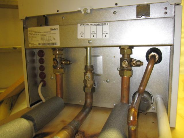

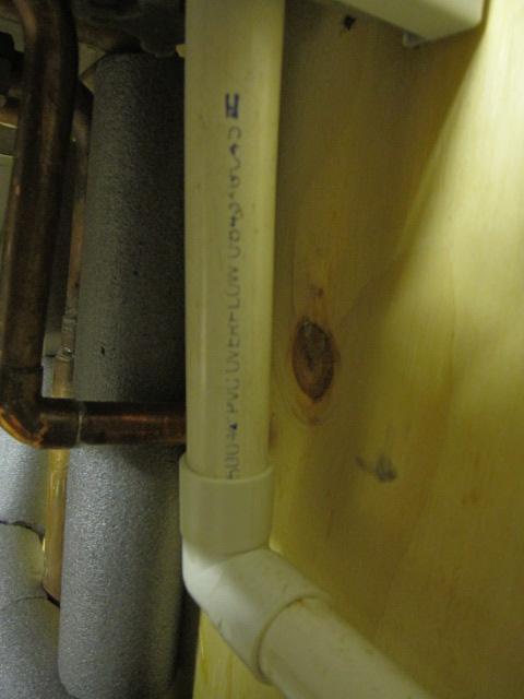

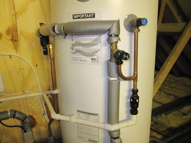

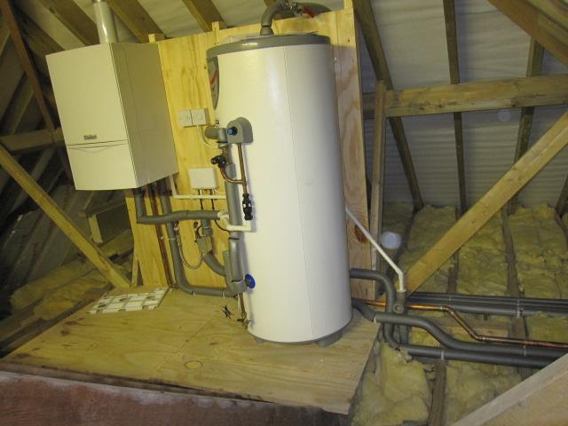

Looks like overflow plus the fact D2 doesn't conform , gonna have one wet loft space when that blows. :roll:

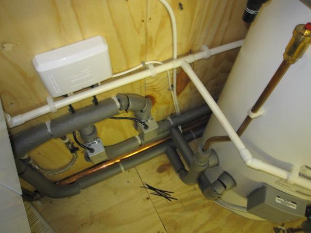

Ok been and taken more pics.
Had a look at megaflo installation guide p13 etc.
Where does the D2 nor conform? If there are hard facts I will get builder back to repipe as required to G3 and guidance section 3.9.
view below boiler pipe from boiler
My interpretation of the Megaflo installation manual based on building regs G3, Hot stored water and where my installation doesn't comply.
1. There should be a vertical pipe drop of 300mm min below tundish before a change in direction eg. an elbow.
2. The pipe material should be copper sized to suit G1/2 Relief valve.
3. If not allowed by BCO to pipe into foul water branch then run in 28mm down to grade/below trapped gulley.
4. The condensate drain from the boiler can run into the FW drain separately.
Better get the 'builder' back then , has he got a ticket? (G3)
