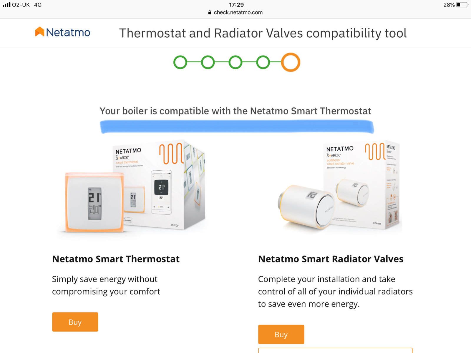

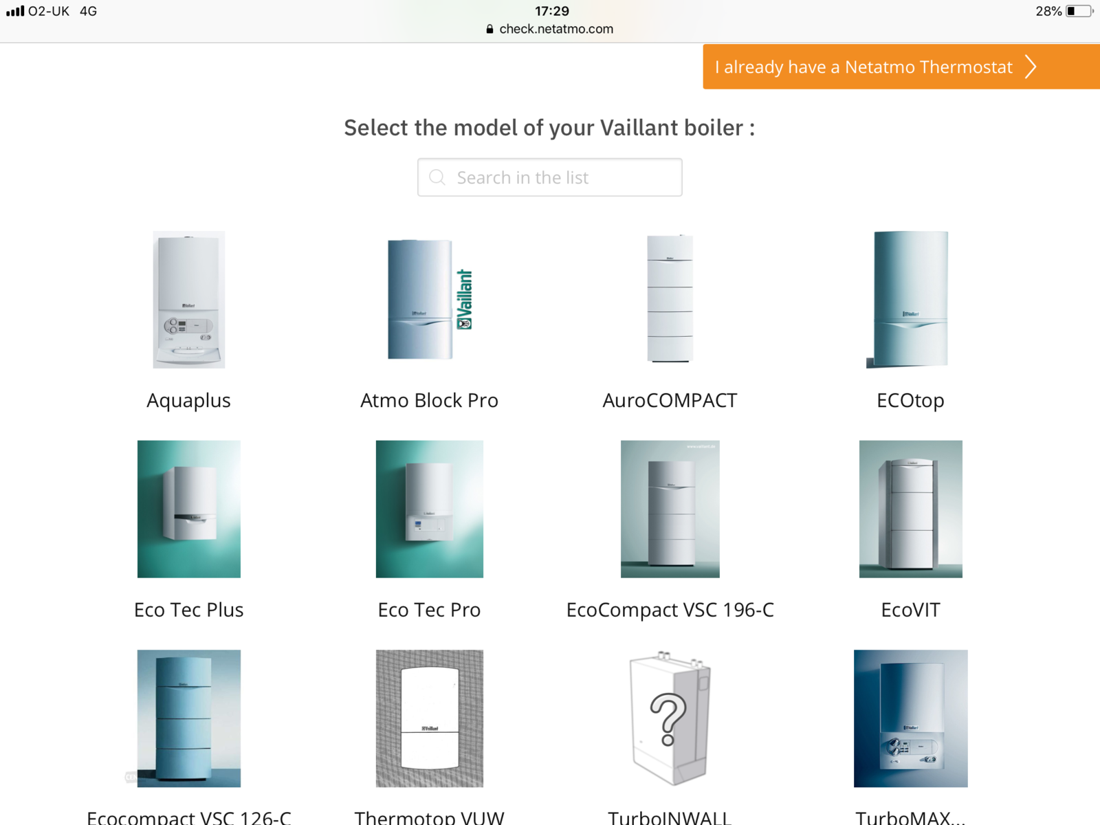

Edited message: Just checked compatibility, and guess what yours is compatible according to Netamo:

As @The Novice , I am not familiar with your Netamo, I have read about them but never seen one in the flesh, some manus do not support third party controls , but if this was the case they should have removed the external controls and returned the boiler to factory settings , restoring heat and HW, it is then up to you to sort that from there on , it is simply a matter of removing two wires isolating them and fitting a link, ten mins job at most
Thanks. That’s what I thought - at least leave it so we can do manually!

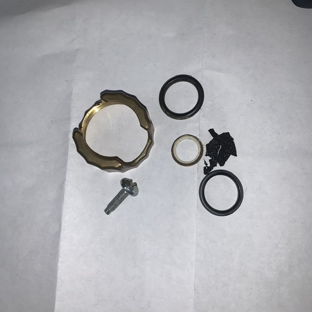

More info! This is all that seems to have been left behind. So could it be rather than change the leaking/faulty diverter valve, they’ve just repaired the leak -
but the valve is still faulty and not switching between hot water and heat?

(What I’m wondering is if the diverter valve was not changed and the solenoid is sticking could that explain the problem?).
Can't see it, but wouldn't rule it out. Check out stuff in my last post and we'll go from there.
