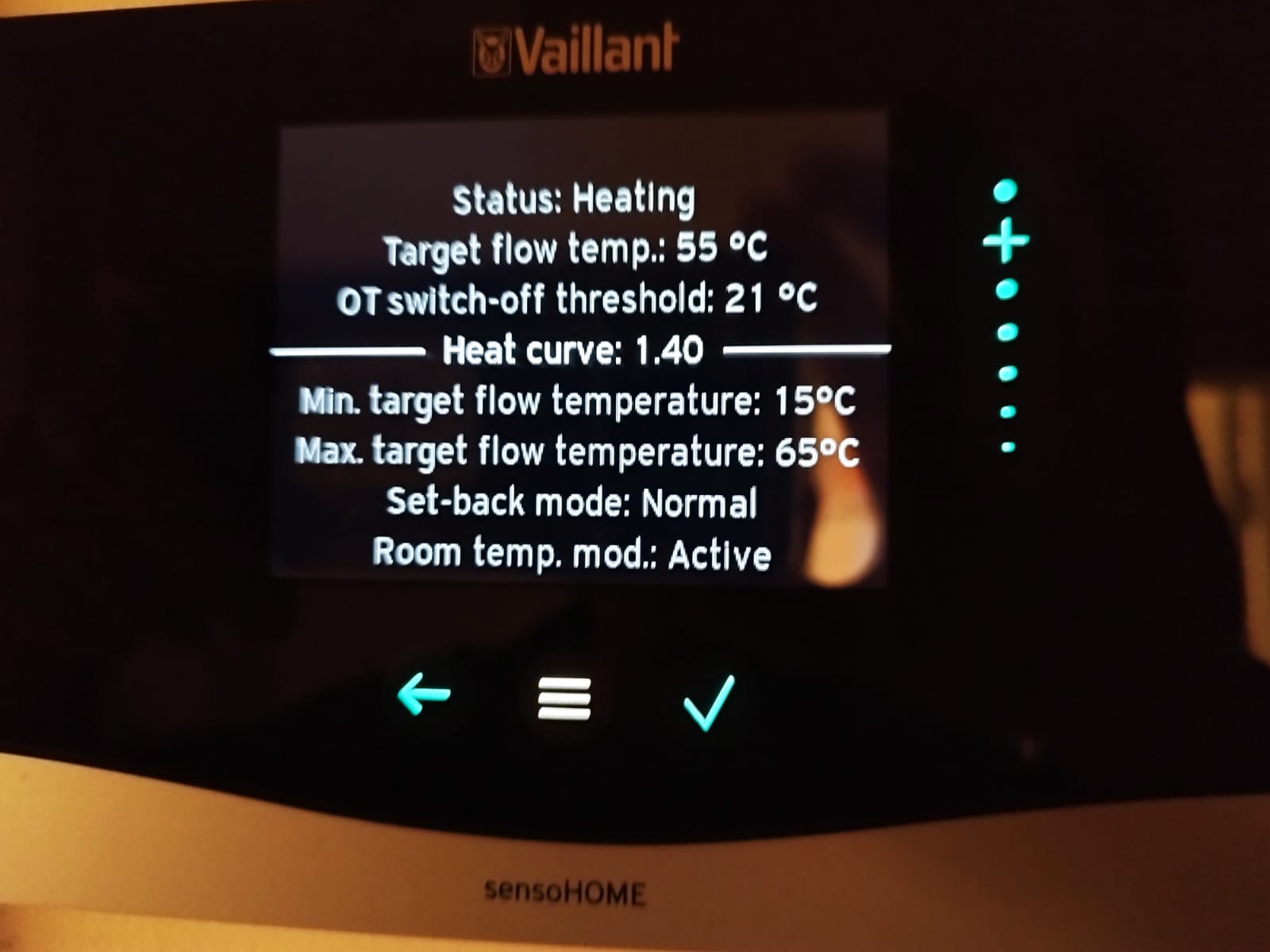

Hi
I just paired a sensohome_vrt_380f with my Ecotec pro 28 boiler all seems ok but now I can't adjust the temperature for the radiator flow.
If I press the radiator symbol i get only the pressure in the system and I can't adjust the temperature. If i switch off the boiler and on i can adjust the temp but the thermostat is overriding the temperature, as I set it to 60deg but when is firing it goes all the way to 75deg.
Is any way to set it to 60 and stay at 60deg?
Also, is worth buying an external temperature sensor? I am living in a flat, 2nd floor and the only place to install it will be under the window. Any savings by having one?
Thank you!

It would seem that from that thread that the VRT380f takes control of the boiler temperature and is changeable in the settings.
It can not be changed in the 380f settings
you can see the temp but you cant adjust it.
I think you need the external temp sensor in order to be able to adjust it.
The sensor arrived, i install it and all is ok now, i can set the radiator temp.
I started with 1.4 and 65 deg now is 1.2 and 60 need to see if is ok or too cold.

I have the same problem, can you tell me more about sensor? It's wired or not, and what model did you bought?
Is a wireless ot
Ok, can you describe connection, because my vaillant support told me that i can use vrc 693 only (vired model) now I'm confused
sensohome_vrt_380f + Ecotec pro 28 boiler + glow worm wireless outdoor sensor
