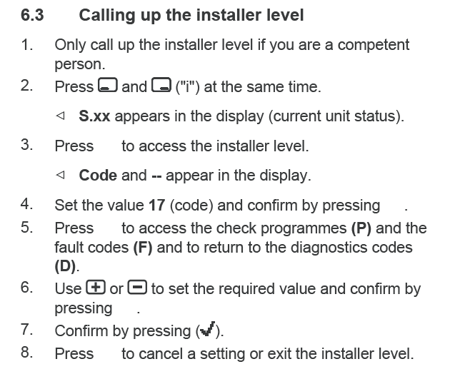

Can you monitor d.40 & d.41, Boiler, flow/return temperatures? you should be able to see these somewhere.

Might be something like this?.

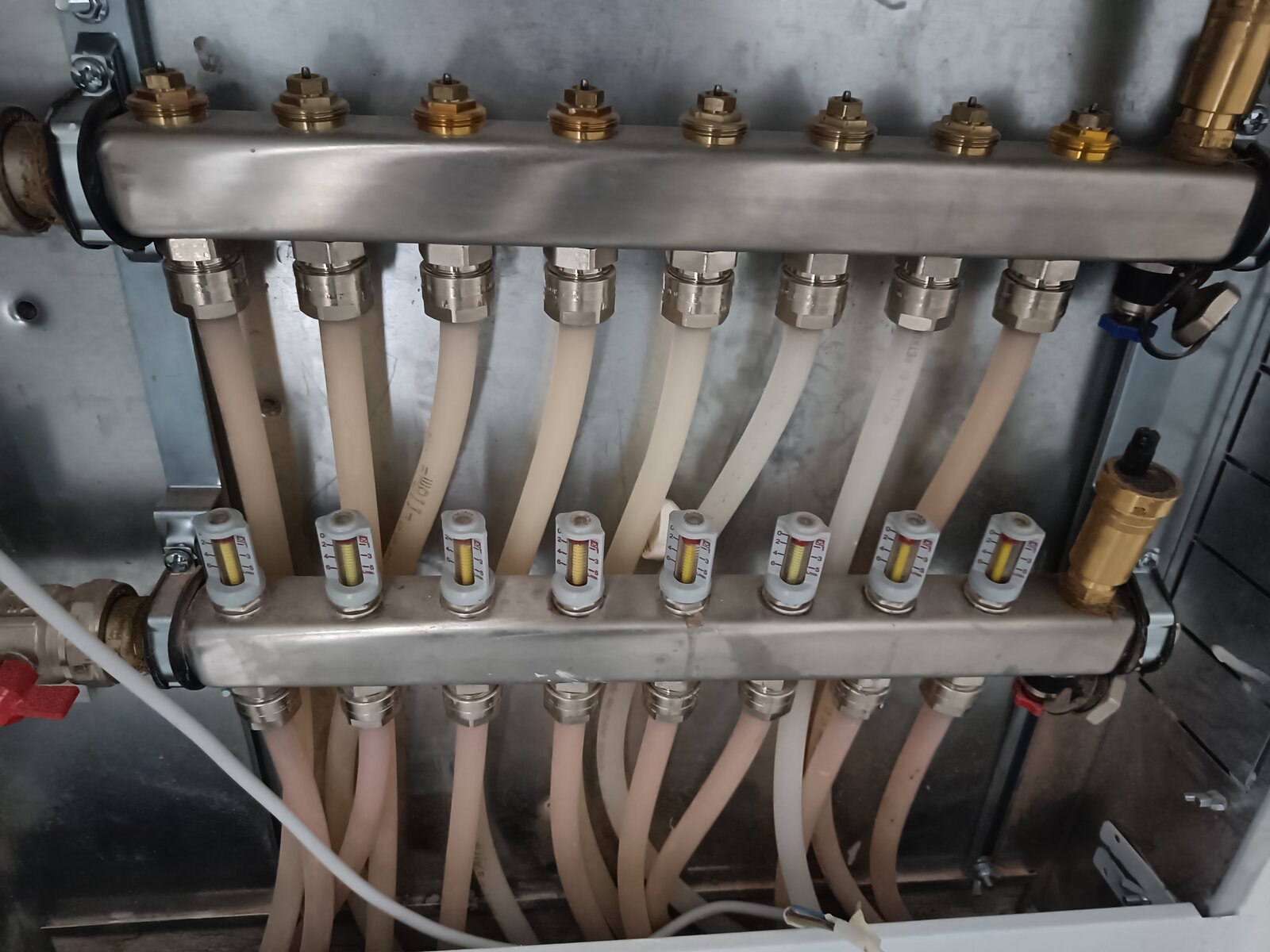

You might post a picture of the manifold, also try and monitor those d.40&d.41 readings.
Hi Johntheo5, here is the picture. When you say "flow meters" you mean that label "118m" on the third pipe from the left? It is hard to reach on most of the pipes, but i will try it that is required information. Also, i have checked d.40 and d.41, and they are both °C.

The flow meters are the individual indicating meters (8) above on the bottom manifold, they read (from top to bottom) 0 to 6 LPM, when you start the boiler these should indicate the flowrate through each of the 8 loops and should read ~ 1.5 to maybe 3.0LPM each.
Likewise with d.40&d.41, when you start the boiler keep watching them and they will start rising up from maybe 25C to 30C, up to a possible 55C,
("What happens is that whenever I turn on floor heating, boiler starts heating, temperature raises to around 35 °C")
THe first thing to look at is those flow meter readings (if any) , as soon as you start the boiler.
Can you also post another picture of the manifold taken more to the left, to see if there is a motorized valve.
