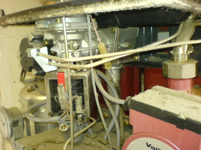

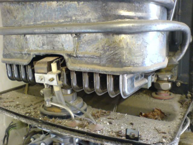

Sorry there small pici's, but my phone is only small :lol: :lol:
Took this monster out today and replaced with a 30SI.
Could'nt for the life of me suss it at first :oops:
If you owd boys out there used to fit these in your younger days, then my hat goes off to you.
Whats the huge valve and 3" solenoid all about :wink:

The big silver valve is the gas section.The round black block at the front is a pressure differential valve actuated by pump pressure.It pushes a pin on the gas valve.The 3" solenoid is a 20v dc solenoid powered from pcb.
Hope that helps

These are still quite repairable boilers if you understand them.
The angled screw below the gas valve solenoid is a pnematic damper on the high/low flame change.
A few years ago when no one could explain them to me I had to spend a little time working it out for myself.
Now I am fine with them.
