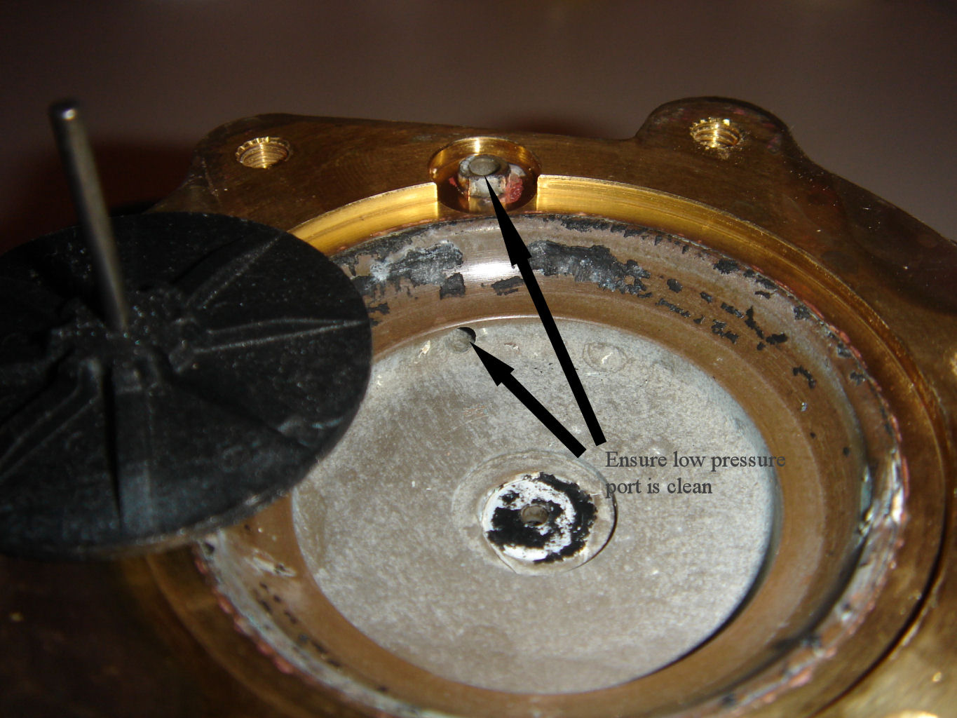

I think the diaphragm in my diverter valve needs replacing. The little white arm that activates the microswitch moves fully when the downstairs hot tap runs (12l/m) but when the upstairs shower runs (6l/m), the arm barely moves. The specs say that the minimum DHW flow is 2.7l/m so am I right in thinking the arm should do a full movement even when called by the shower?
There are no leaks, and the microswitch is OK. I replaced the diverter about 10y ago and it's worked fine until recently.

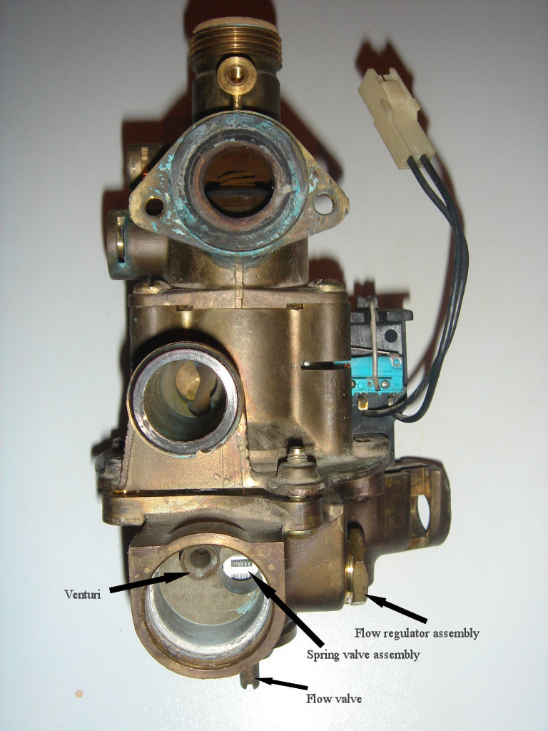

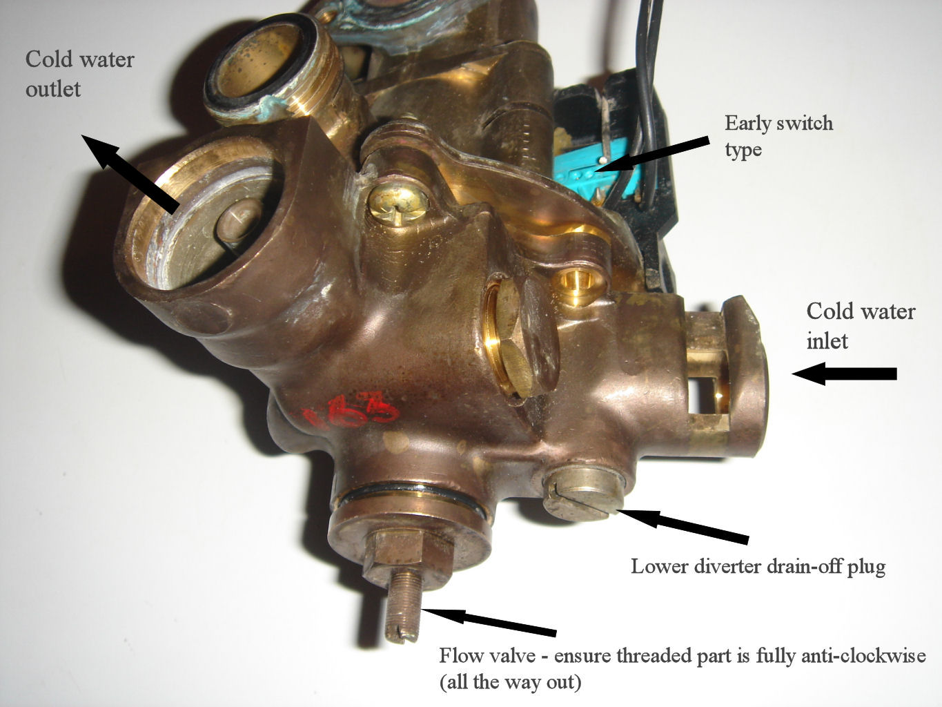

Unfortunately that rarely sorts out the issue in my experience...
The plastic lever that operates the microswitch can go weak.
The top section (that diverts primary water) can partially seize.

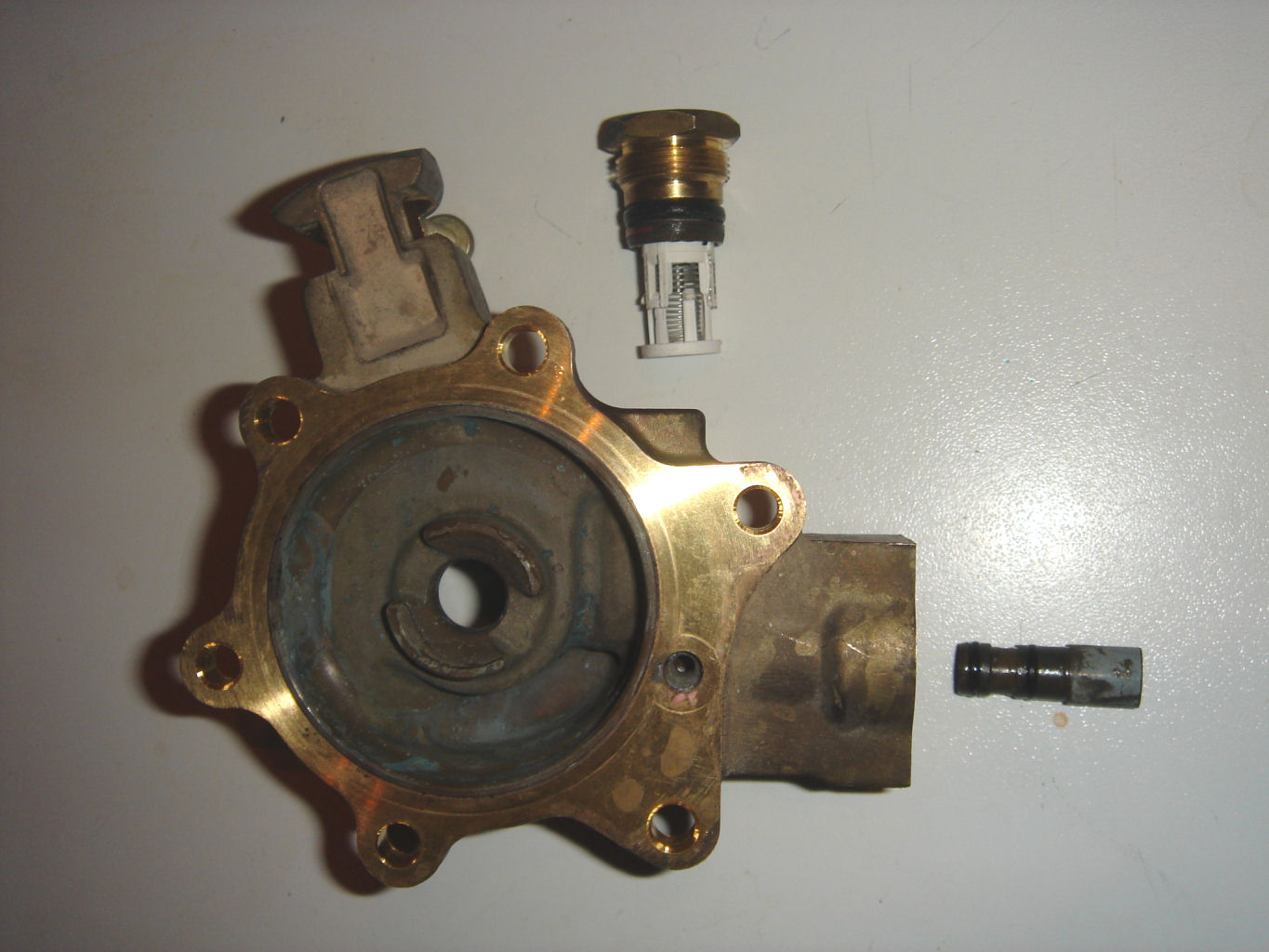

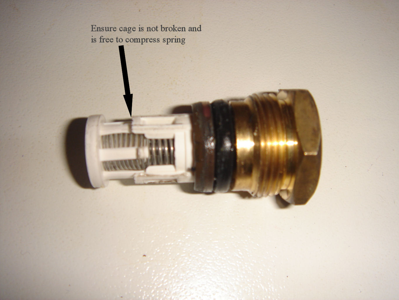

Behind the large brass hex plug in the lower section is a plastic spring valve arrangement...these can break up and it's not part of the service kit or available.

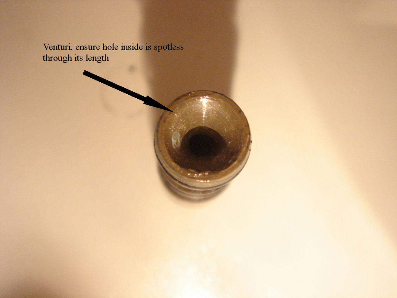

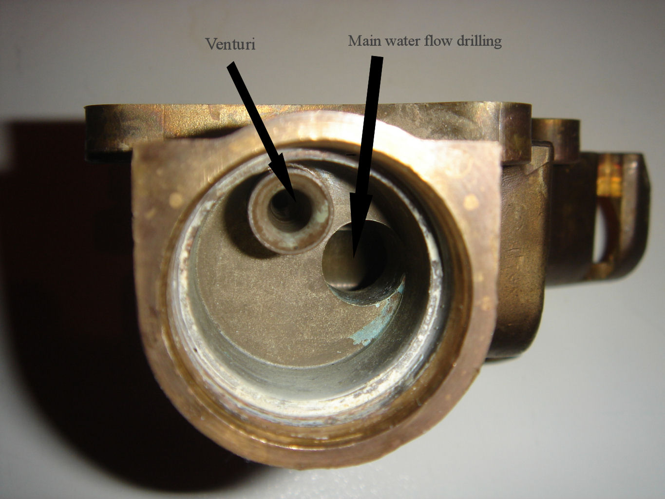

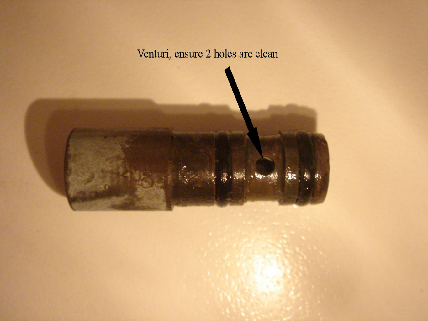

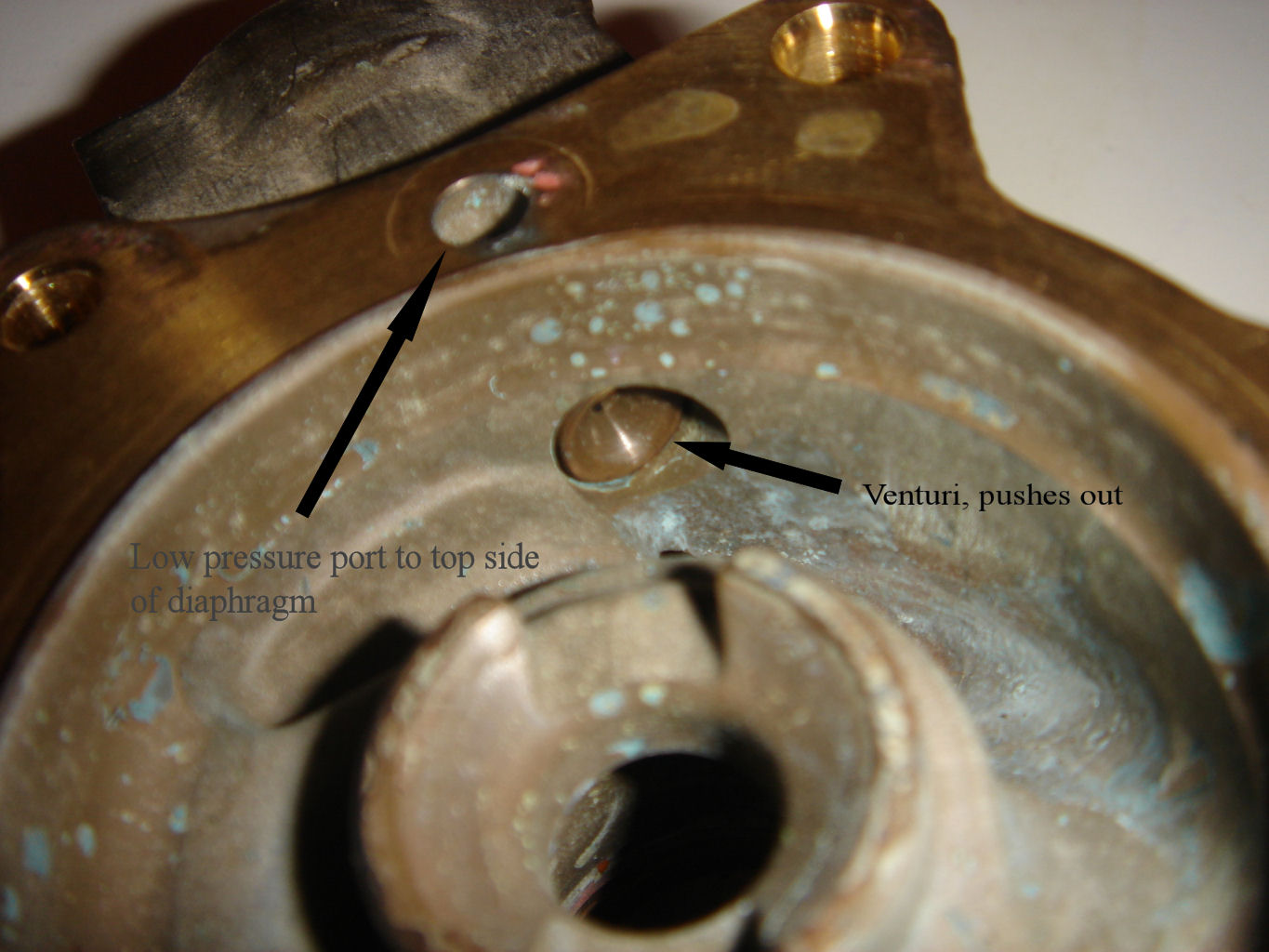

The venturi needs pulling out and cleaning, can't remember if the seals are included in the kit.
The microswitches on these diverters are almost the worst of any manufacturer and fail for fun.

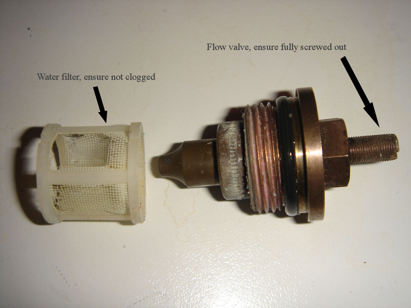

The filters break up and can clog.
There is a limited adjustment on the microswitch plate..you can rotate to lower the operating point.
The quality of these diverters has worsened over the years and when I last worked on Turbomax's I was seeing failures after just a couple of years.

The problem with all the repair kits is that you don't get all the parts included. eg. the white sprung valve (I've had several that break up).
