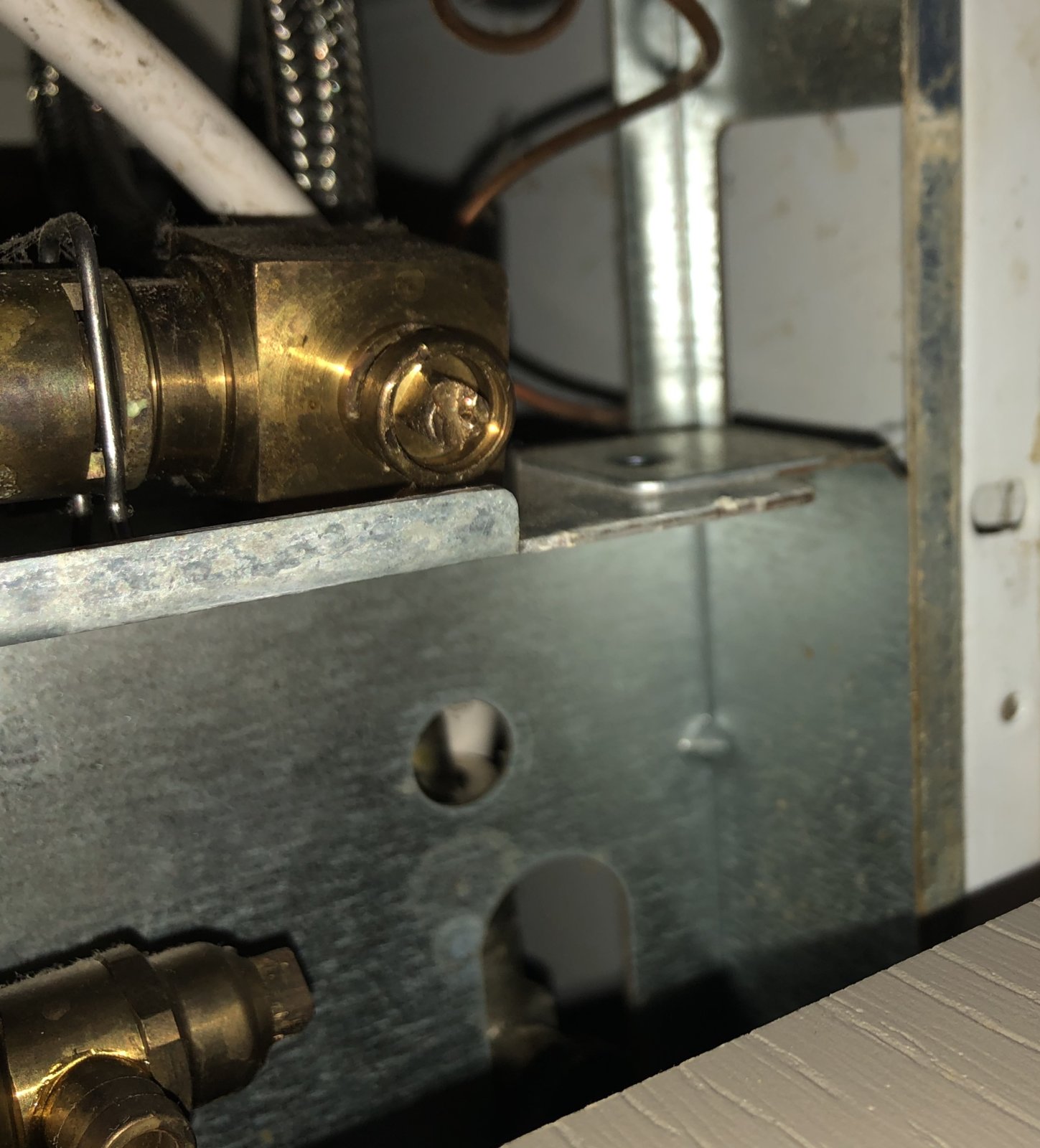

Hi, bit of a long shot as this is an old thread, however I am trying all avenues... recently moved into a property with an old TurboMax boiler, with two filling loop valves - identical to the kind shown above and the Vaillant self help page;
http://www.vaillantservice.co.uk/Vaillant_Boiler_Self_Help.html
Unfortunately, the screwdriver slot on the right hand valve is damaged, and therefore will not accept a screw driver head to adjust. I have tried a variety of rad bleed keys, and purchased a TurboMax Plus filling loop valve handle, but this doesn't work as the space on the key doesn't fit the valves to turn because the valves are circular head, and the keys are square. Pic of valve attached.
Is there a known key that can be used to adjust these loop valves does anybody know, or has anyone used anything alternative that works?!
All the best and thanks.

If I was you... and this is me being sensible (having learned over time) then I would employ someone to fit an external filling loop to this boiler. Once you do that the refill times go from many minutes (30 to 45) to a few seconds. At the same time you could get a magnetic filter fitted to the system, if it doesn't have one, to improve things further. Then you never need to worry about these slots ever again.
But, if the slot in the screw head is so threaded that a flat-bladed screwdriver won't work, then it's unlikely the special key it comes with will work either (as you say).
