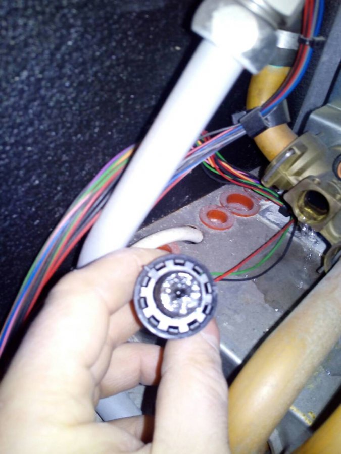

It was flushed when first installed and has had inhibitor in every 18 months. I had F75 but could get on by topping up. I called my Swinton insurance who sent a engineer out on Christmas eve who tried to say it was the vessel. This was before he even took cover off. Exact words "Its the vessel and your insurance does not cover it. Then I stated I believe it is the sensor as it comes on when topped up. and manual explains this He said he cleaned sensor and left. 1 hr after he left it went off again, this time with F73 which is definetely sensor. I phoned insurance and they said the engineer has put down contaminated system so not covered as tubes was hard. I decided to have a look myself. I noticed water by sensor, I isolated boiler and drained. I have removed sensor and the engineer has on purpose removed the rubber o ring on sensor so water would leak onto it and completely break it. He obviously didnt want this job on Christmas eve and has completely ruined my chrismas with a 1 year old and a 6 year old. Would of took 10 mins to replace sensor but instead he lied. My system water is clean and he never tested water just said tubes are hard. Without lying they are a little but this is not when sensor failed, I do not believe.

In doing this he could of now I believe broke the sensor hall to.

Water is supposed to go in the sensor.
Without the oring water would be ****ing out of it immediately.

This is a picture the engineer sent to insurance of sensor to say my system is contaminated. Does the water look dirty coming out the sensor hole ? . Plus he never took much care not to get water anywhere else.

Has the pressure sensor reading been checked for accuracy??

No he never done nothing like that he was just saying to me he was ordering a part and it will be fixed next day. Then next day come and no one called, so i phoned swinton and they said engineer has wrote contaminated water so not covered.
Also this is not possible now as he robbed the o ring . I am picking another sensor up in morning to put in.
Could the sensor hall be damaged if water got on it or will that be fine now it dried out. It got abit of water on the connection what pushes int he sensor cause he took o ring ?
