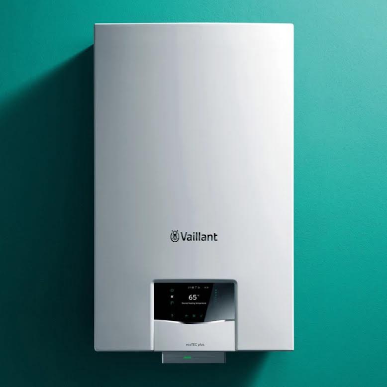

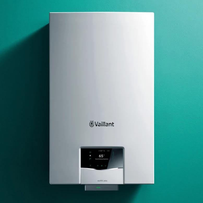

Is it something like the attached one that a friend of mine installed a year ago where you set the dT between I think 10C & 20C but he couldn't even though the pump speed was well above its minimum turn down of 50% in Auto, A common problem with all Vallients and probabvly all boilers with internal bypasses (system&combi boilers only I think) is that you can spend hours nicely balancing your rads to say give a dT of 15C only to find that the actual boiler dT is ~7C due to this bypass, it is adjustable, but if you turn it to minimum then Vaillant say you must run the pump at 100%.
It is a Vaillant Ecotech plus 832, the latest version without the door over the screen.
From the manual it should only be run in dP mode with radiators. dT should only be be used for full or partial underfloor heating.

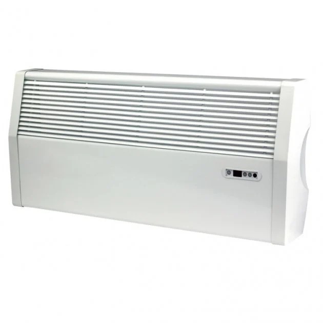

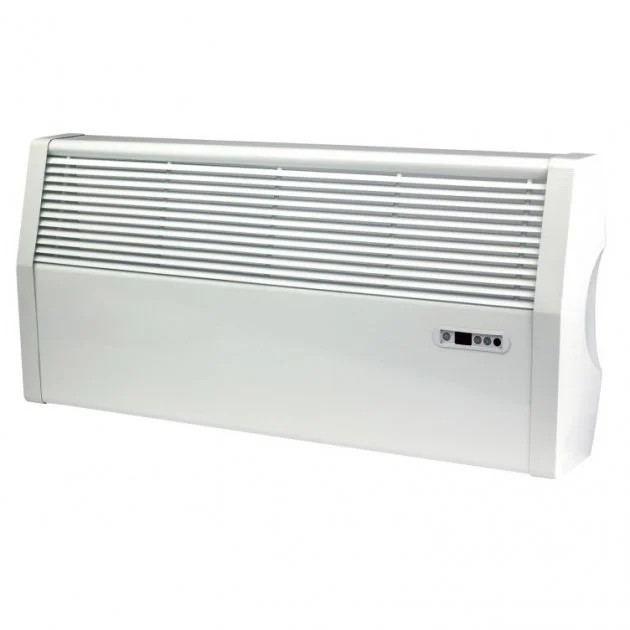

In the lounge is a Myson 14-10 fanned radiator which is effectively one bypass. The control board is faulty. It simply has a 50C thermal switch on the feed pipe which sets the fan to the medium speed. The outlet / return temperature is around 40C i.e. dT 20C. I have tried partly closing the return isolation valve to simulate a lockshield valve but end up just cutting the heat output with no significant effect on the overall boiler return temperature.
Having said all this and presuming the boiler efficiency not much lower for a low heat output so ~6kW gas input is delivering the minimum 3.7kW output if the boiler would drop to 3.7kW then dT would increase. The ideal 20C clearly is not achievable but I think 15C would be.
