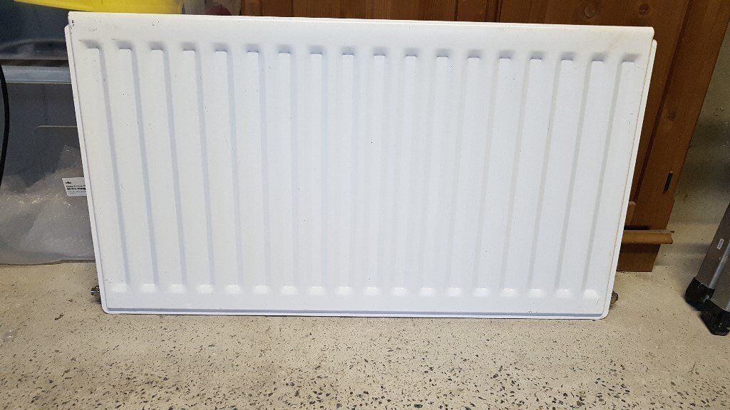

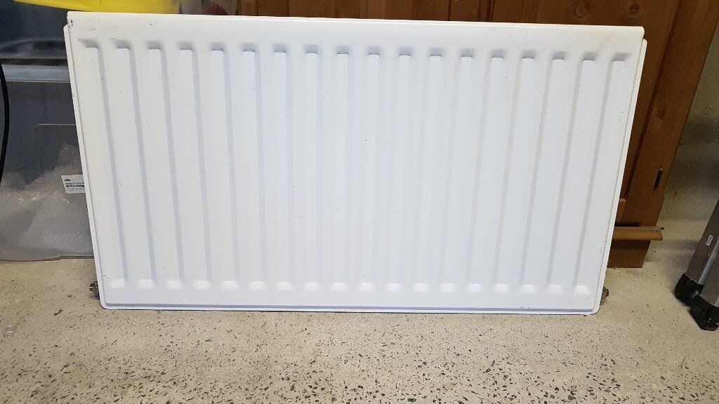

Also remember the installation is 1970's for a vented system with 22mm feed from the boiler then split in to 15mm for distribution and I still have 1970's radiators - see photo for style.
The lounge always had a Myson fanned convector, without this another radiator would be required. I just changed to a more recent model of nominally the same size that came up on eBay, primarily because the motor to fan couplings were bodged up with silicone sealant so the fan did not run true.
